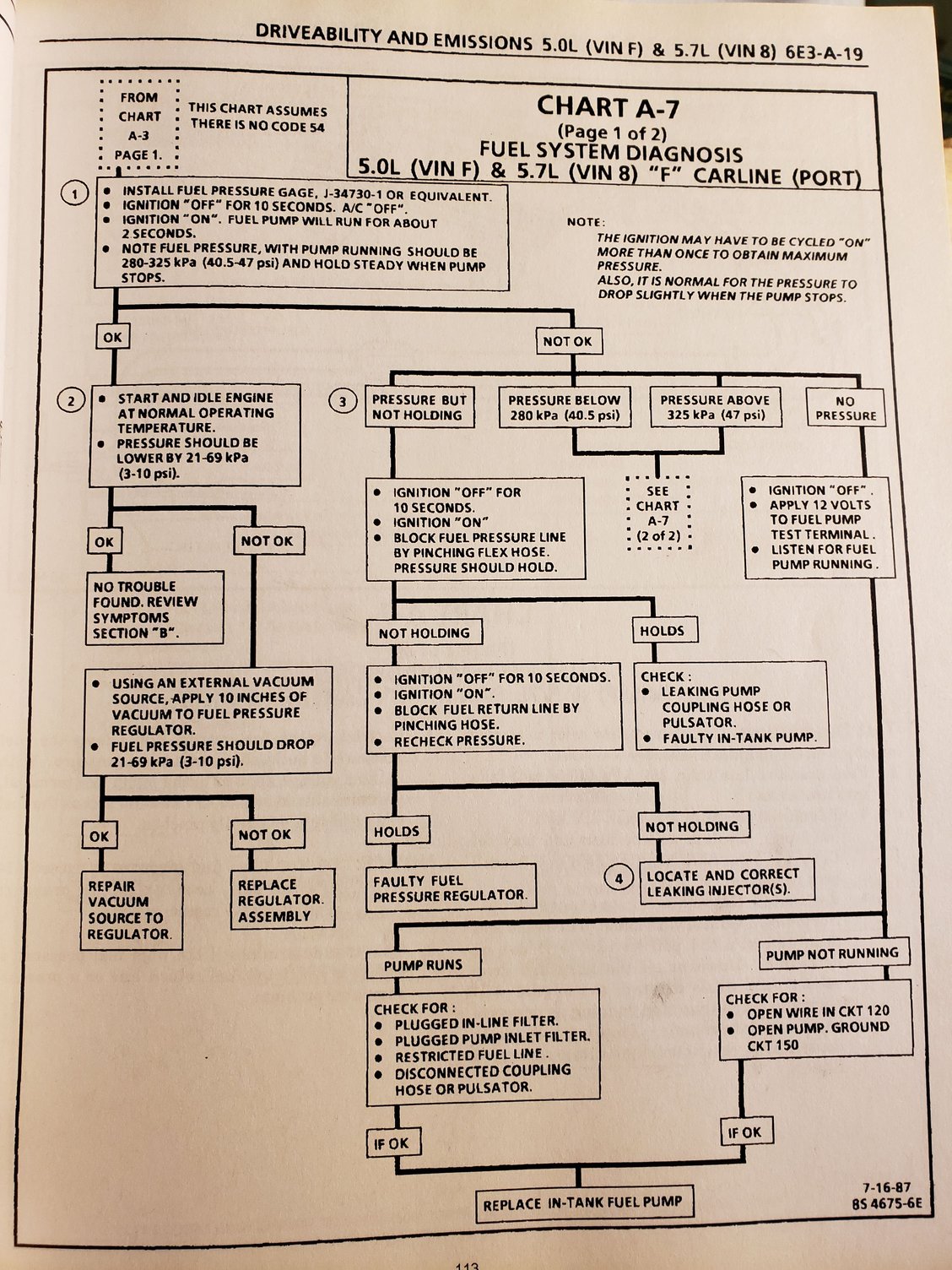

If your system holds a constant 50 psi with the return line clamped, the injectors can't be leaking too bad or you would continue to lose some pressure.
Even if the FPR is newish, you could still have a problem with it, or a chunk of crap could be holding it open. Sometimes a few cycles of the pump with the return line clamped (creating high system pressure) will dislodge whatever is in there and your FPR will start to work.
I'll hunt up the fuel system check flow chart from the GM Service Manual and post it for you.
Very much appreciated, thanks for the help.

This is for 1989, but I think your '88 should be the same.
Hope this helps.

So you have ALL the same symptoms when swapping out the ECM? SES light blinking on and off, low fuel pressure, and stalling/rough running?
1. You know you have a fuel pressure problem. It may or may not be the root of all your current issues, but you know it's not right.
2. You have been provided factory instructions on how to diagnose fuel pressure problems.
3. Pretend that you are starting from scratch and nobody from thirgen.org has given you any advice and you have no other outside help except the service manual. FOLLOW THE DIAGNOSTIC CHART. What does it tell you is wrong with your fuel system?
This is how I would be proceeding.
Following that it tells me my fuel pressure regulator is my problem however it holds vacuum and no fuel present in the vacuum line so can it still be the culprit for low fuel pressure ?
All symptoms remain with a different ecu.
Also have to add I haven't actually put in a new fuel filter yet but I can get onto that tomorrow and check again.
In regards to one of the system charts, I'm not exactly sure which of the relays is the fuel pump because my car has been converted to rhd so the relays have been moved from the original position, and tbh I have no idea how to apply 12v to it to perform that check. Is it as simple as running a wire from the positive of the battery to the relay?

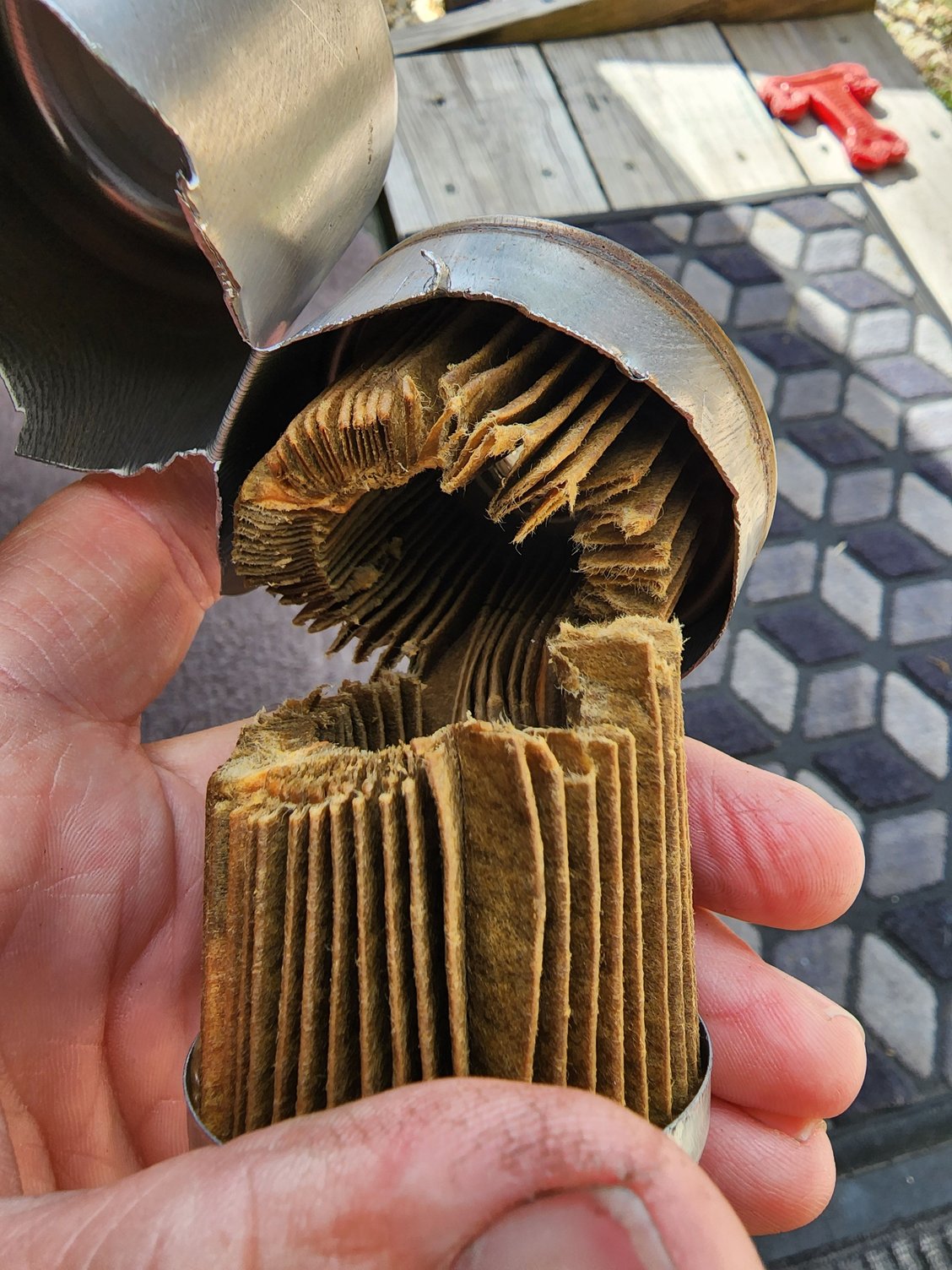

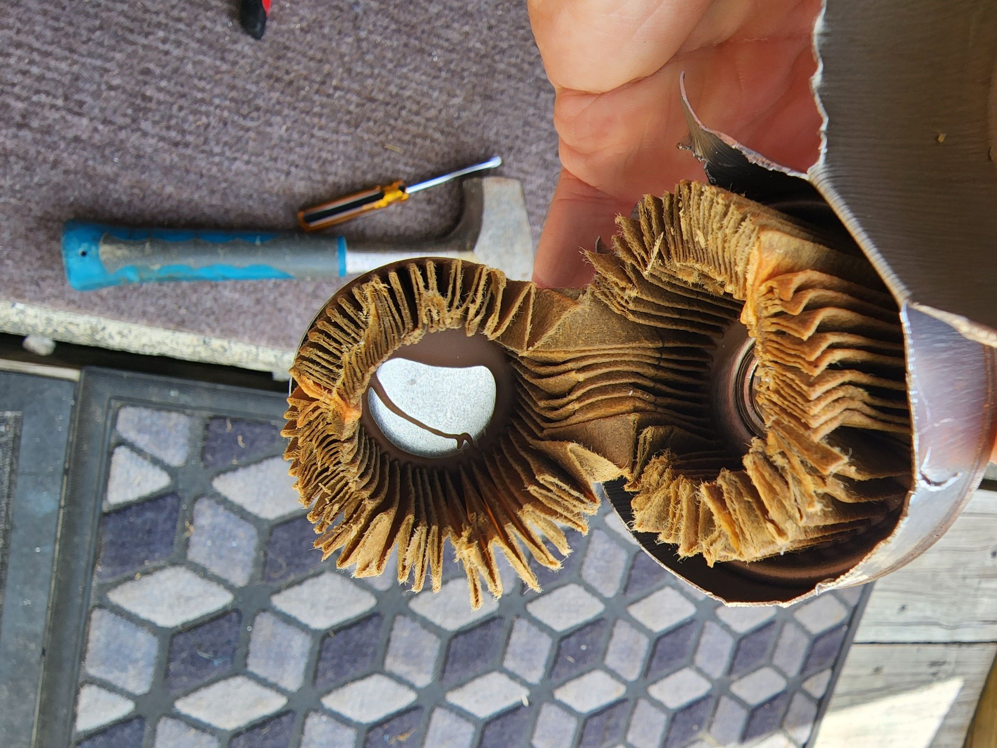

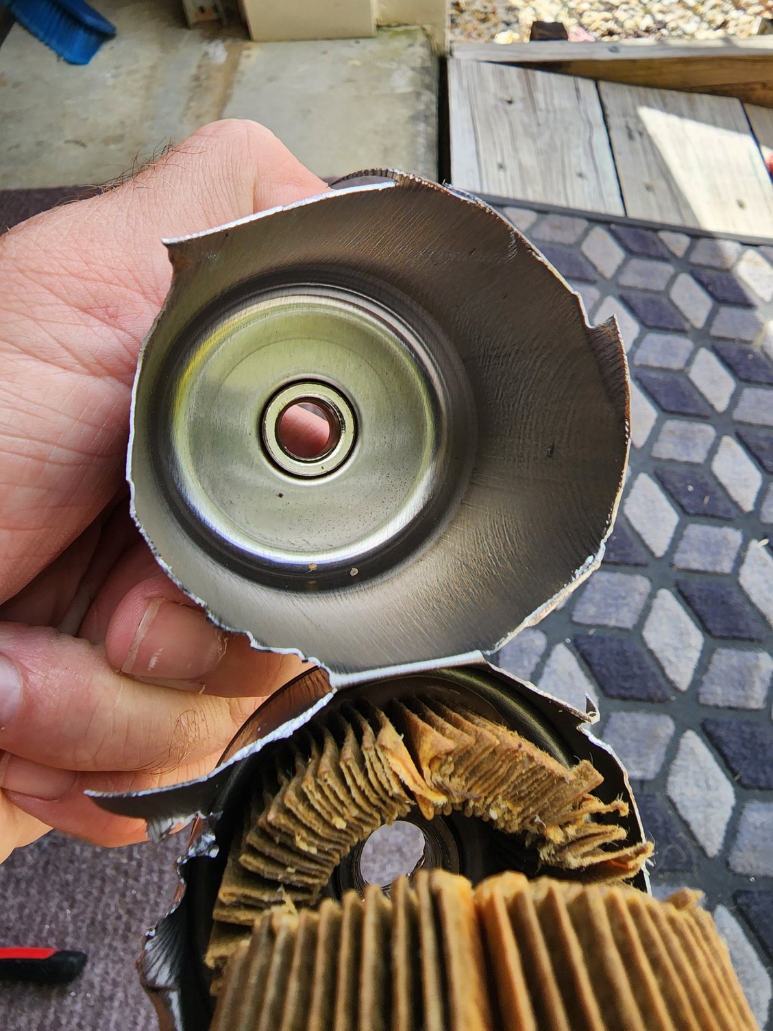

I would be curious to see what is in that old fuel filter if you found debris in the FPR.

Re: Stalling
I might saw it open for a look.

Re: Stalling
As far as I can tell it looks ok in there 🤷🏽‍♂️
No idea where the debris came from that I found in the fpr diaphragm.
