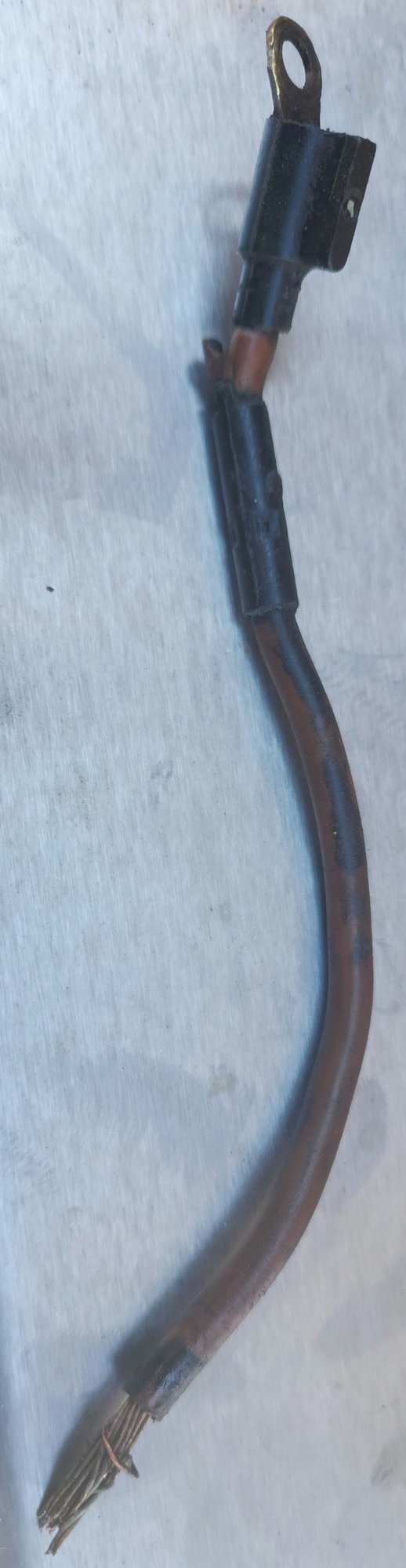

Just removed starter since I didn't hear any click or crank and found my problem
Not sure if i caused the burnt connection jumping the battery/ positive wire to starter connected to battery but once the starter dropped this ignition wire fell completely off
