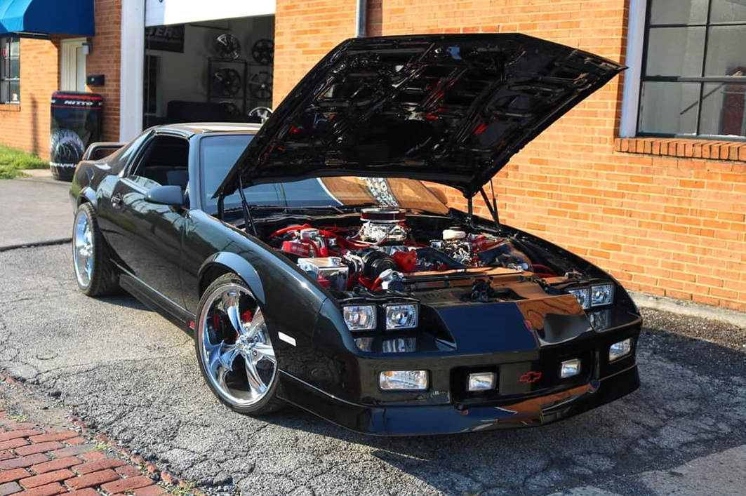

Hey how is everybody doing I got a 88 Camaro and sometimes when I turn the key to start it sometimes it won't crank at all sometimes it will just click once and then sometimes it'll crank normal battery is good alternator is good brand new starter could it be the ignition switch sometimes not connecting to make it crank and then my battery gauge reads under 13 when it's running took the positive cable off and then it jumps up the 14 got a voltmeter on the alternator while it's running with all the accessories on 13.6 but at the battery I'm only getting 12.6 like it's only letting partial charge go to the battery would the ignition switch affect the charging of the battery if it's not working properly
