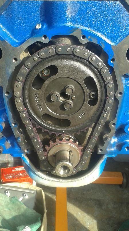

Q: Installed GMPP Single Roller Timing Chain Kit
P/N: 12371043
Car: '89 IROC 350
The sprockets are almost touching. Is this normal?

I've only used/installed a Cloyes SBC single roller set myself and to be honest I never noticed. I admit that does seem strange.
But if you look at the pics from a review on Summit, it does appear to be normal https://www.summitracing.com/parts/nal-12371043/reviews

Yes, that spacing is pretty normal. I also like the single rollers - Some may have noticed that in my prior comments. They are tough to ignore for their strength and durability, and fewer joints and sleeves result in less slack and lash. Consider that if every roller bushing needs 1½ thousandths of oil clearance, and there are 23 links in a single roller HD set, that's almost 10 thousandths less slack in than with a 29-link "trouble roller" chain, and that's before ANY load is put on it.
Of course, slack in a cam drive probably doesn't affect valve timing, does it?

Good points! Never counted or considered the amount of rollers but makes sense. I like them cause GM used them in the LS and while that's not the-end-all(unknown exact reasons) it's still a good reason to consider somethings use. Also a single row just seems simpler, and double row well kinda sales pitchy. Plus I found an old discussion of dyno testing the two and they made a bit more repeatable power with the single, I think they determined it had to do with valvetrain harmonics and the double row made them worse. Anyways those that were discussing it, was good enough reason for me to switch. I got a few single roller sets for my next builds. Got one in a car that has hundreds of 6000 RPM 1-2 &2-3 shift passes and when I checking the chain swapping bearings it seemed fine but I only had the oil pan off.

I turned the motor by hand and it's unbelievable how close the sprockets are.
Thank you gents.

If the crankshaft or camshaft ever move enough for the sprockets to touch, you have more serious problems.

I would think that they would become "self-clearancing" if that happened. They would also provide both automatic audible and visual warnings, with a howling alert tone and sparkling indicators in the engine oil. Kinda cool, huh?

If you ponder that a little, it might be clear that the sprockets were manufactured to utilize the largest roller chain pitch possible in the space available and at the necessary ratio. That's probably a good thing, and why they are stronger.
