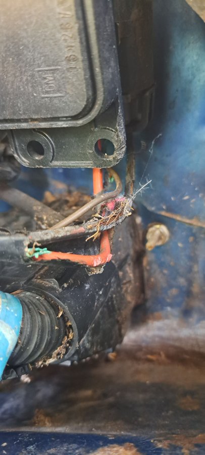

I bet some critters had a snack.
Yep, mice built a nest under the relays and had a field day on the relays wires on the drivers side firewall.
I'm sure I'll find more but what would be the best fix for this? A new harness or a solder and heat shrink fix?
And are any new harnesses being built anywhere now?

I hate to be the bearer of good news, butt ... you're just gonna have to examine EVERY SINGLE WIRE in that car, and find where it's fornicated, and fix it, before doing any "troubleshooting". Not sure why you're even bothering posting crap like this on the Internet when there's NO WAY IN HELL we out here can guess what's been chewed on.
I have MANY good friends among rats, and others in low places; butt I can't tell what's been eaten in your car. You're just gonna have to do your own work on that one.
