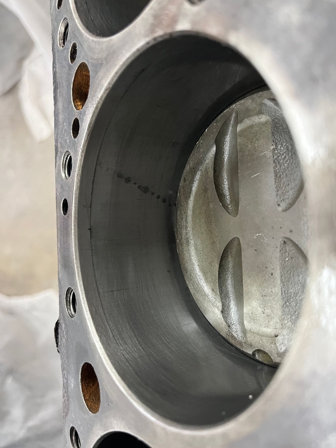

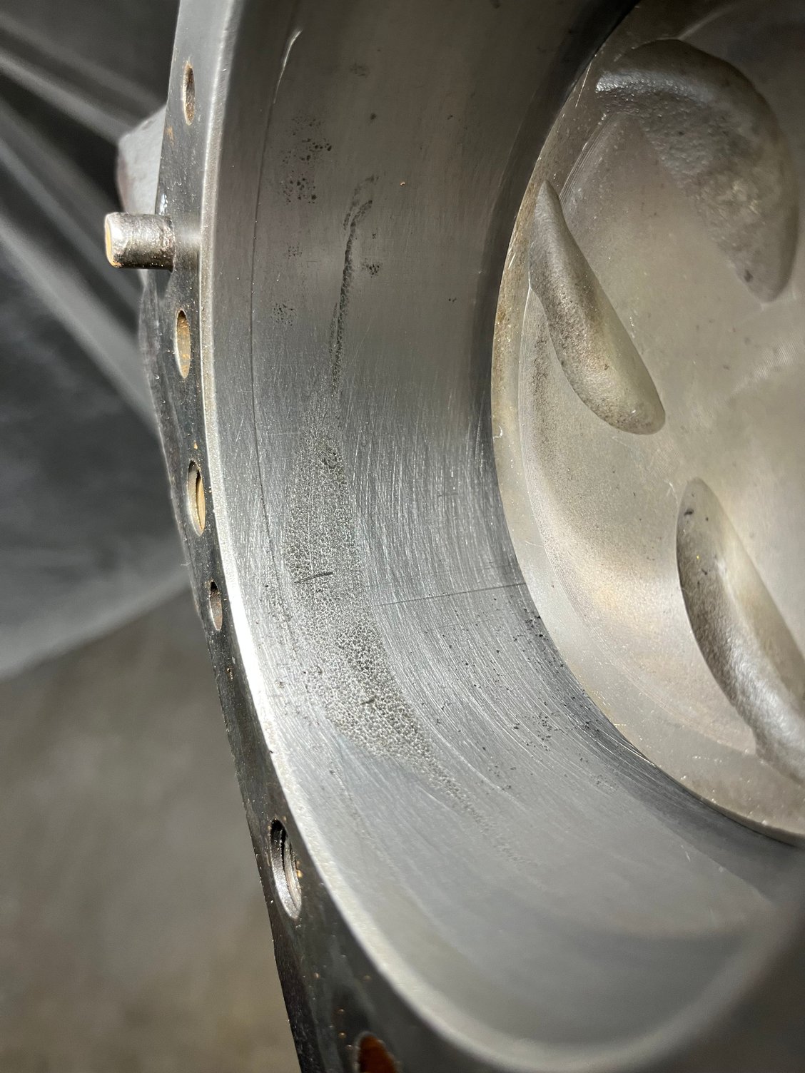

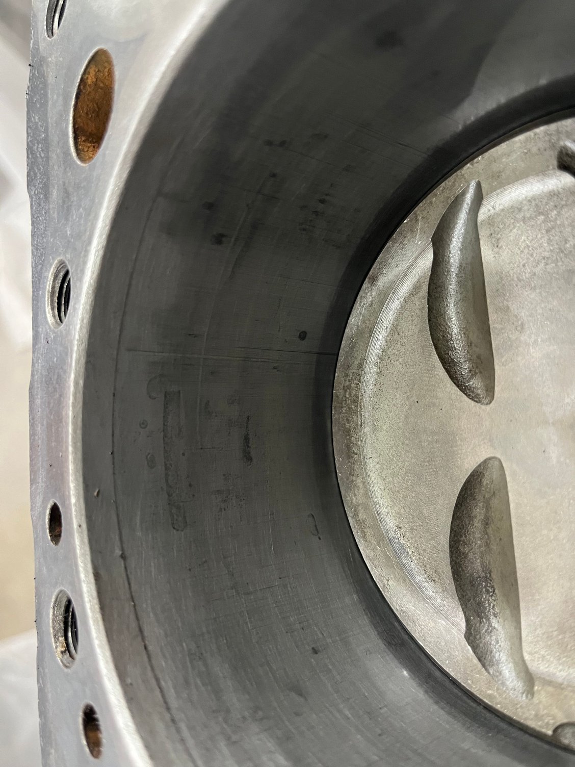

This was a hone & ring job done by a local shop. Would you run this?
Some obvious staining, vertical streaks & pitting that didn't clean up although the bores are still in spec they claim.
When I see stuff like this that didn't clean up by honing I feel it should go over whatever it takes be it .020 .030 etc.
Will this be an oil consumption issue at some point sooner or later?

I would not. That's pretty rough. Even worse, it has dished pistons.

If you can feel it with a fingernail, it's a no go.

To go to the trouble and expense of pulling that engine and then leaving the cylinder walls in that condition was a mistake; block should have been bored oversize and fitted with new pistons.

Maybe it's just my aging vision, your camera, or some combination, but is there still some ridge in those bores?
There is no doubt that it would run for a while. It's amazing how bad some engines are and still run acceptably. My guess is that it ring sealing and longevity might be in question.
How is the taper? It's a roller block, so it does have some core value. At least they didn't touch the deck.

That's my concern,,,,,oil consumption. May be ok for a while but how long? 1K miles? 2K? Less? Who knows. I SMDH that a shop would let this out the door even if there may have been some miscommunication involved as to what was supposed to be done.
There does appear to be a ridge but it is very slight. Can't really feel it much at all.
I don't have the correct tools to properly measure taper but I did some upper ring gap measurements on a few cylinders and they still fall into spec according to the 1987 shop manual........spec is 010-.025 and these were at .021.........so it does seem like the bores are ok, assuming they are actually still round.......just don't know how well this shop checked everything........I plastigaged a couple rod bearings and they are a little tight @ .0015 but still within spec according to the manual.

Yup, oil consumption, and blowby as well. Imperfect separation between crankcase and combustion in a general way.
Looks to me like it'd burn oil from the get-go. Pretty seriously at that. Looks like it sat out in the rain for awhile.
By not touching the deck, at least they didn't do something that destroyed the block. You still have the chance to get it machined properly.
What's the bore diameter now? Where did this thing come from? Have you ever seen it run?

Standard bore. I don't have a bore gauge to measure it properly but using the feeler gauge method to measure skirt clearance and ring gap it is still within acceptable specs according to the shop manual. Cylinders may be oval for all I know, who knows. If it wasn't for the staining and pitting it would probably be ok for what I plan to use it for but as it sits I am hesitant to run it. Ain't getting any younger and I only want to do an engine swap once. I'm willing to have it redone properly but other machine shops I have contacted in my area (Chicago) are really backlogged.

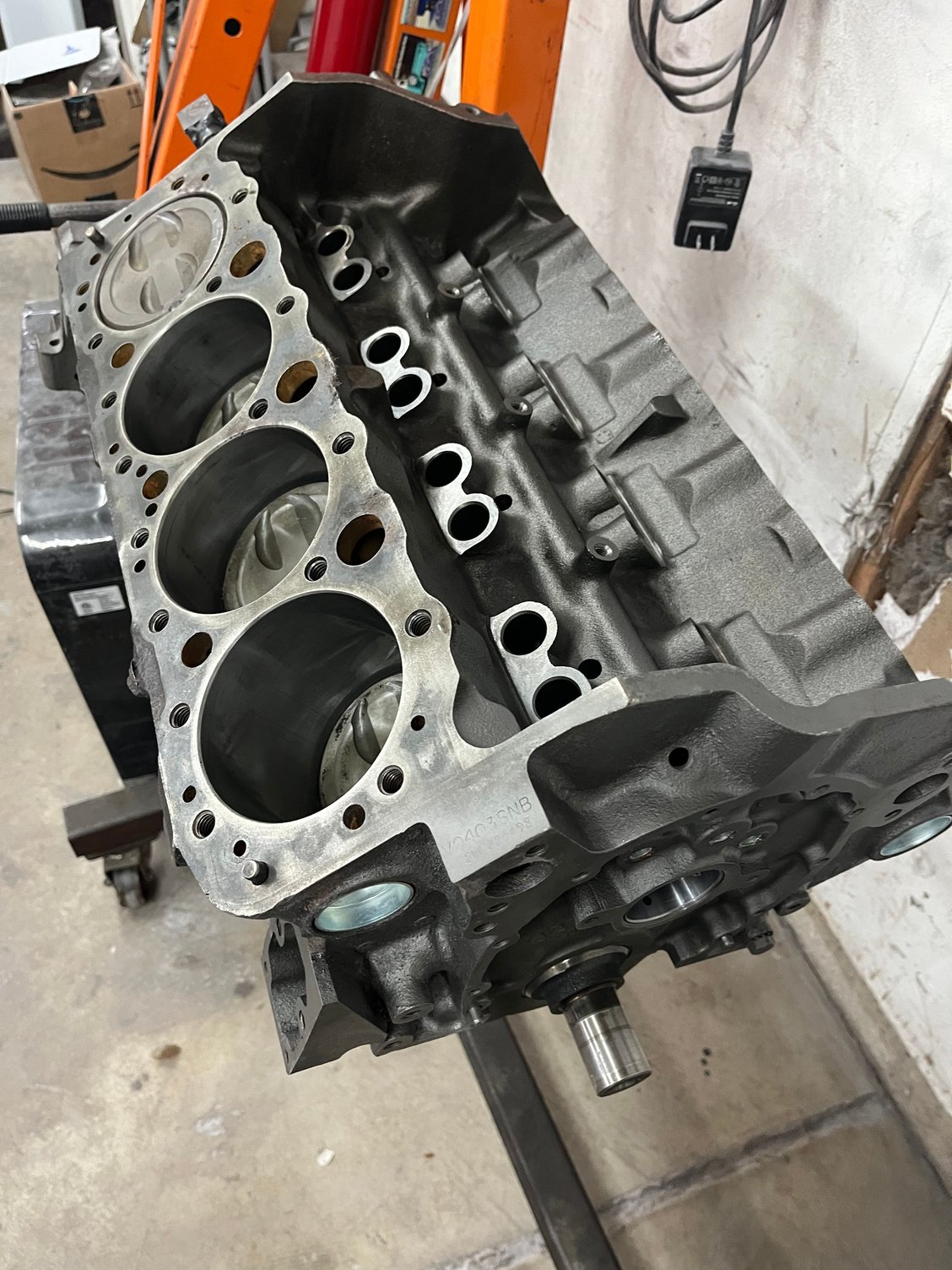

Not saying I recommend you run that,but I would be tempted to try that short block out just to see how it goes-I have ran similar in old pickups,etc with decent results The dished pistons are a performance demerit-engine probably came from a heavier capacity light truck,especially if it is 4-bolt mains.
'87 IROC
