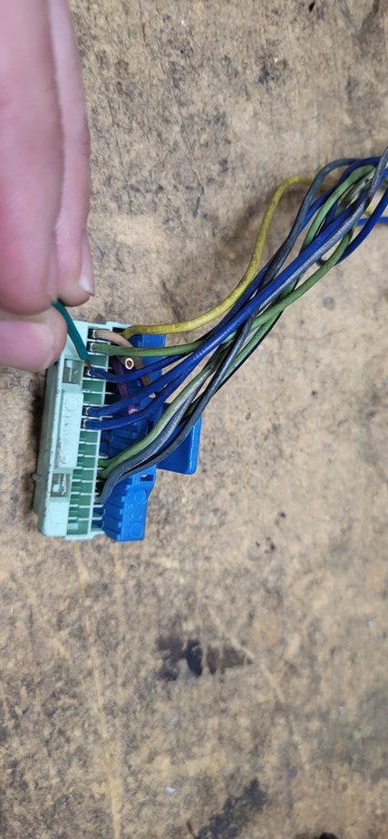

If you find the ground wire at the ECM, this is what I was suggesting. Remove the plastic retainer and you'll get access to the back of the terminal.
I used a scrap connector in my garage to simulate it. You just have to locate the correct terminal via the engine wiring schematic. The other end of jumper wire would be grounded to chassis someplace.
With the 12v energized with the key on, you should hear the solenoid click when you ground out the ground side of the circuit.

I found the A4 terminal, unplugged it, inserted a small cotter pin, reinstalled plug, turn key on and grounded it using a jumper wire. The solenoid worked, turned off when ground was removed .
