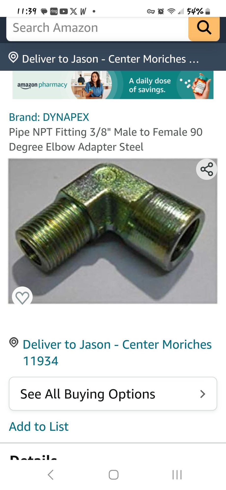

Re: 90° fitting temp sensor
So this would work if I understand correctly?
Old Nov 6, 2023 | 01:14 PM
Posts: 28,015
Likes: 2,492
I have no idea whether ¼" switches are common or not. But fittings in that size are. Finding such a switch would make fittings far easier to source.
That Amazon one would work, if all you need is to point the switch in a different direction. It's steel though; it will rust in place without mercy. Brass would be MUCH better. E.g. https://www.lowes.com/pd/B-K-3-8-in-...ing/1000505721
