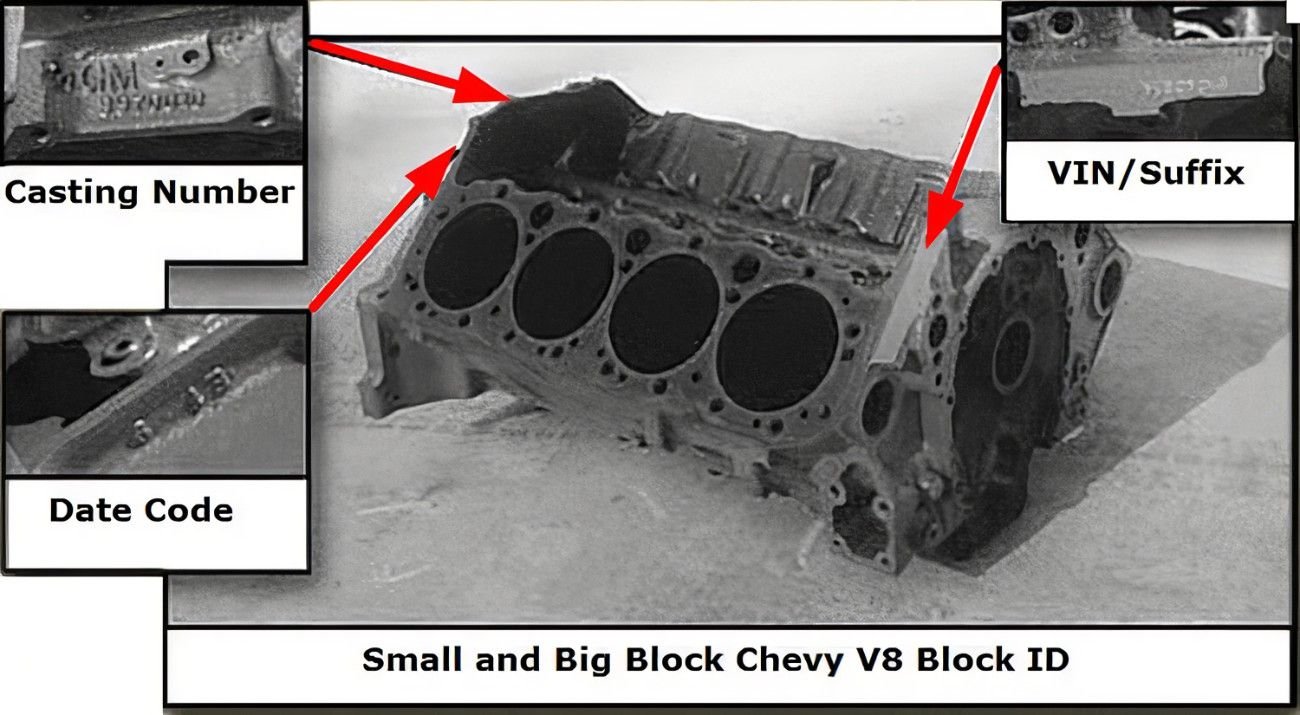

With anything this old it is best to determine what exactly we are dealing with. All crankshafts have a casting number located on one of the rough finished throws or counterweights towards the front of the crank.
And
The Casting Number of the block (unfortunately) not what you listed above. The casting number is found at the rear of the block on the driver's side.
Once you get those numbers post them, and we can go from there.

Yes indeed - We need both to make a somewhat educated (if we believe in such a thing) guess.
The cast number of the block is located in the back of the block. The opposite side of where you found the VIN info.

Took a bit to understand the codes you posted.
V0622
Flint Michigan plant June 22
C2W
1982 305. 155 hp and came with a 4 barrel carb.
1CN154479
The last 9 digits of the vehicle the engine originally came from.
Year digit is C so the block came from a 1982 vehicle which matches the suffix code.
Since you've already claimed it was a 1982 305, I would have to say the engine is still original so the VIN on the block should match the VIN on the car. Chances are that the engine has been disassembled and had machine work previously done to it is very slim.
