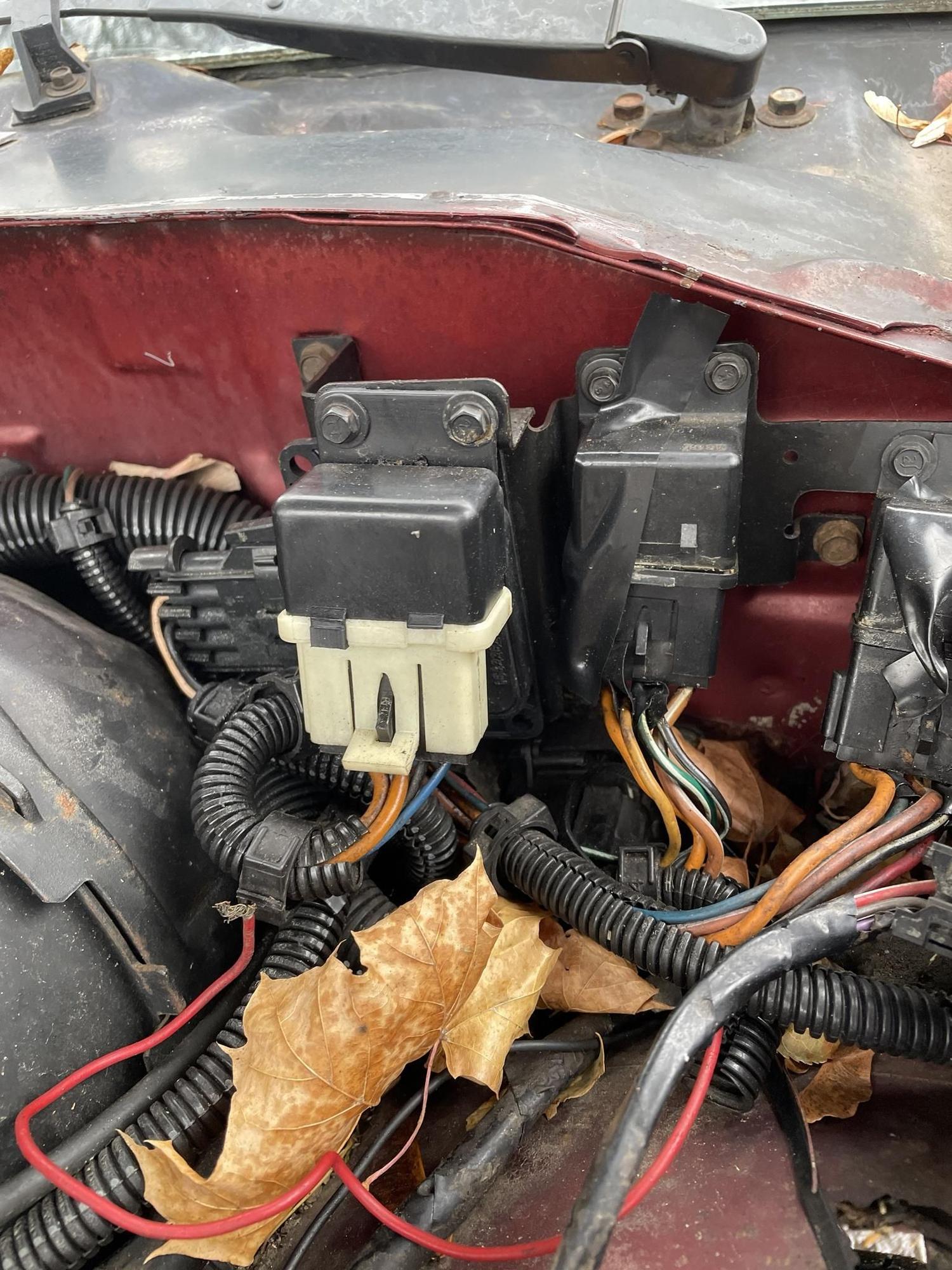

What are these white plastic clips called that hold the engine relays in place? I'm missing a few and need to order more, but can't for the life of me find a part number or something to order them.

Those Pac-Con type relays are junk. As long as you're doing replacement, it would be smart to update to the sealed Metri-Pack relay used in later 3rd gens.
Copy of info posted by @vorteciroc in this thread, https://www.thirdgen.org/forums/ltx-...e-4th-gen.html
Connector: #12052287.
TPA: #12052290.
Metri-Pack 280 and 630 Push to Seat Terminals.
Here is a nice Image of everything:
The Sealed style Metri-Pack 630/ 280 Relays (45A) have been a great replacement for the older UnSealed style Pack-Con Relays.
Shown below:
Now discontinued by GM, but I have had good luck with Standard Motors #RY109
PigTail shown Below:
ACDelco #PT1115.
