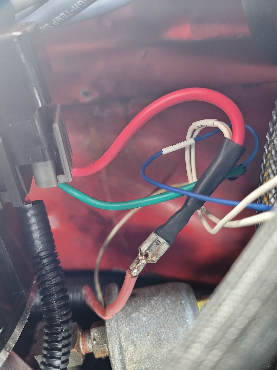

On my 1986 Trans Am I am running a FiTech throttle body EFI system which requires a 12v signal from the ignition circuit via a white 'key' wire. Recently I had issues with the FiTech failing to prime and began diagnostics by jumping the 'key' wire directly to battery. Connected directly to battery it worked perfectly. The battery itself is brand new and tested 12V/600 CCA, alternator is brand new, and new distributor. I used a multimeter to test the voltage from the pink wire that comes from the ignition switch and connects to the 'BAT' terminal on the HEI distributor and found the reading to be between 8-9V with key ON despite the reading at the battery terminal being 12V. I believe this is why my FiTech has been having issues, but I am not certain where to go from here. Anyone have any thoughts?
Pink wire visible coming from Ignition Switch. White wiring is for the FiTech 'key' signal

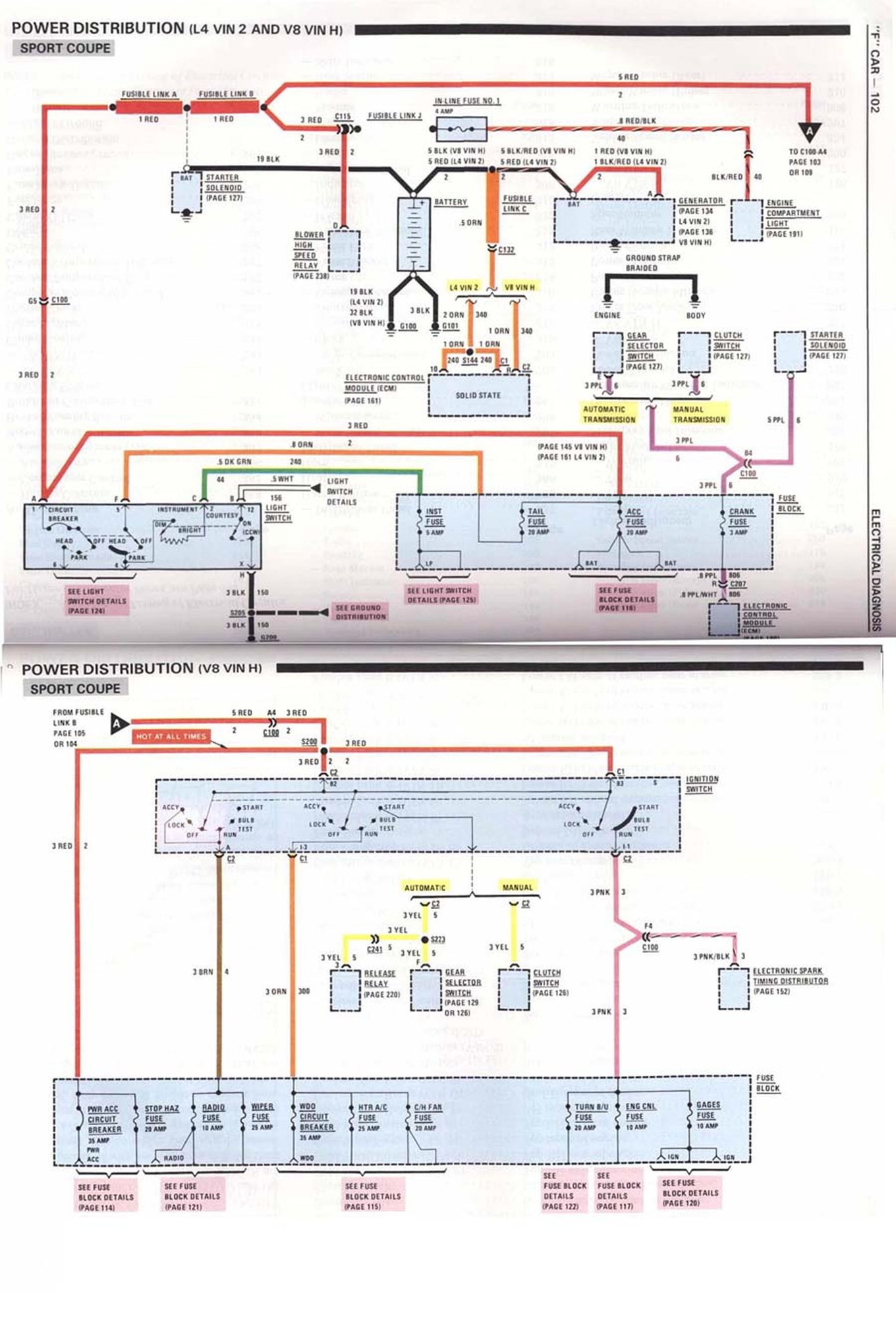

Additionally, do you know where I can find an appropriate set of wire diagrams for this vehicle?
This is what I have been referencing:

I have accumulated diagrams over the years, and cannot recall where most of them were hosted. Is this an original carbed '86? If so, I can probably load up the diagrams a few at a time.

I'll try to begin with the power distribution and related sections.
And the distributor area:

Thank you so much Vader. This is invaluable.

I measured the voltage at the red wire indicated by the arrow, and the pink wire. Both tested at a maximum of 11V. I also ended up replacing the ignition switch itself, but this did not solve the problem..
