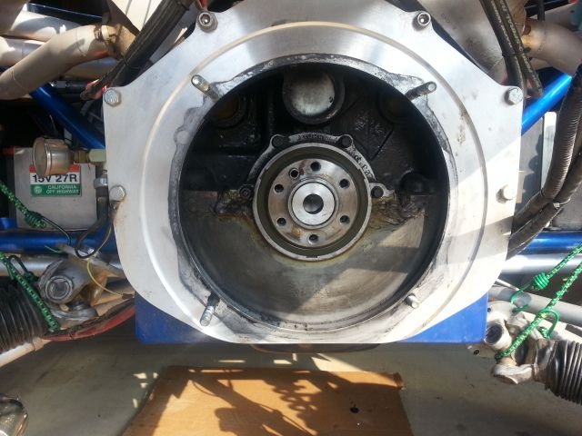

I have a early 2000's ZZ4 350 crate motor. Need to replace the rear crank seal. Only reference to part number for seal I could find is GM#10088158.
Can anyone confirm this seal # or recommend the right one.
Thanks, Kevin

It's the same seal as any other 86-up small block. No need to worry about a GM part #. Look up something like a 90 truck 350 at yer local parts store.
