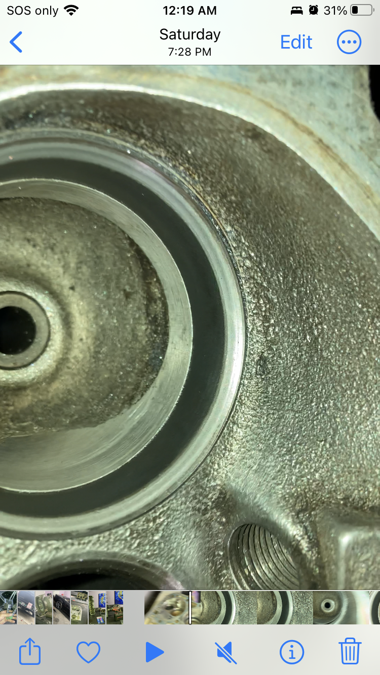

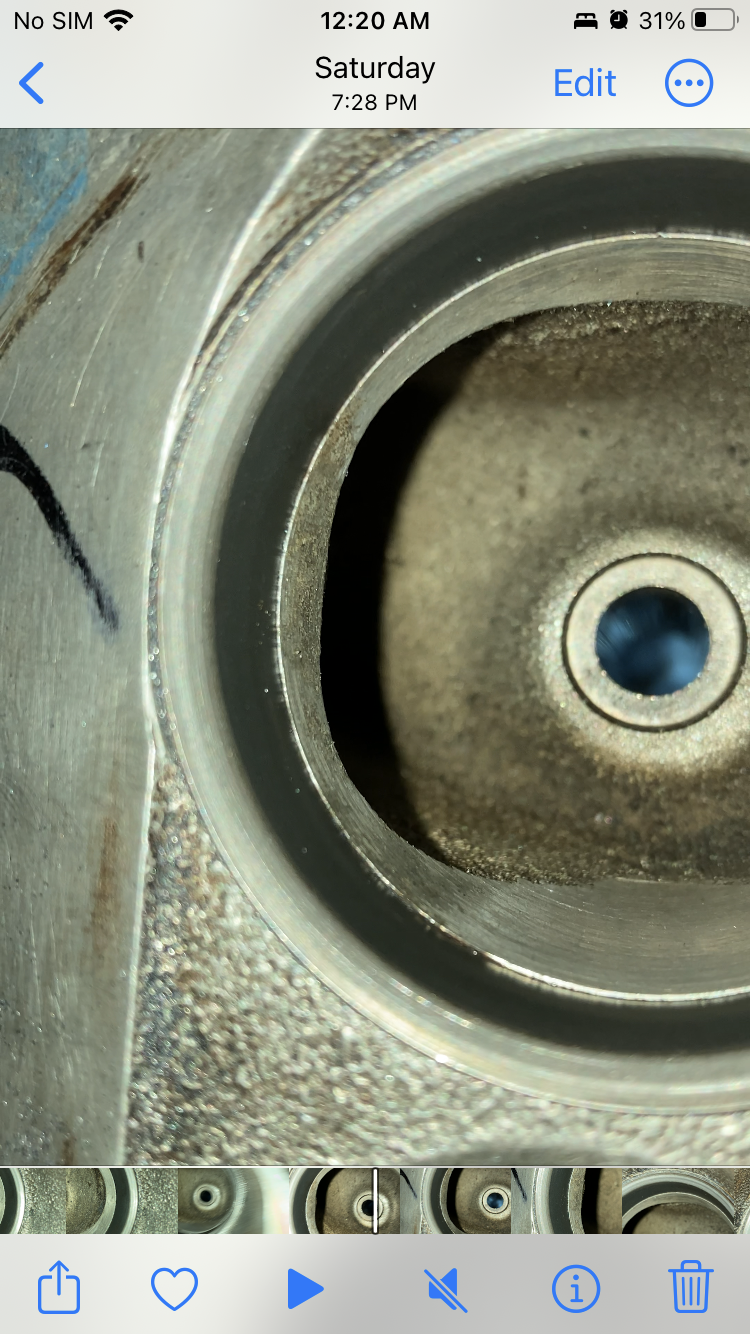

I removed all the valves on one head. The exhaust valves and seats all look good . But the intake valves sat with coolant in them causing pitting and rusting. The seats look good though, no pitting on them. Can I get away with buying new intake valves and lapping them? I lapped one of the intake valves that wasn’t rusted not sure if the pattern is good.

Those valves are smoked. You have to have new valves regardless. But the seats should clean up.
Try it and see. Nothing to lose at this point by trying.
