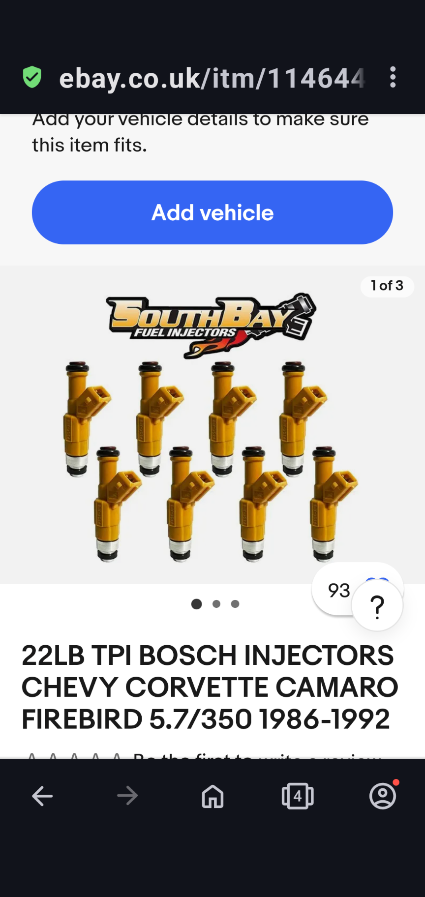

So have some of the southbay orange/yellow 22lb injectors for the 5.7 TPI and one of the seals on the bottom the square kind is slightly damaged, needs replacing anyone know the size or where to get new ones from?

Ah I understand now. I have sent a email to you guys, these are the ones I have it's the o ring which is square type seal. I don't mind paying for shipping for a replacement set of seals + seals themselves. Much appreciated 👍🏼

Not a problem at all. Yes the square orings have to be used on the adapter. If you have a PayPal account we'll just send you an invoice for the shipping
