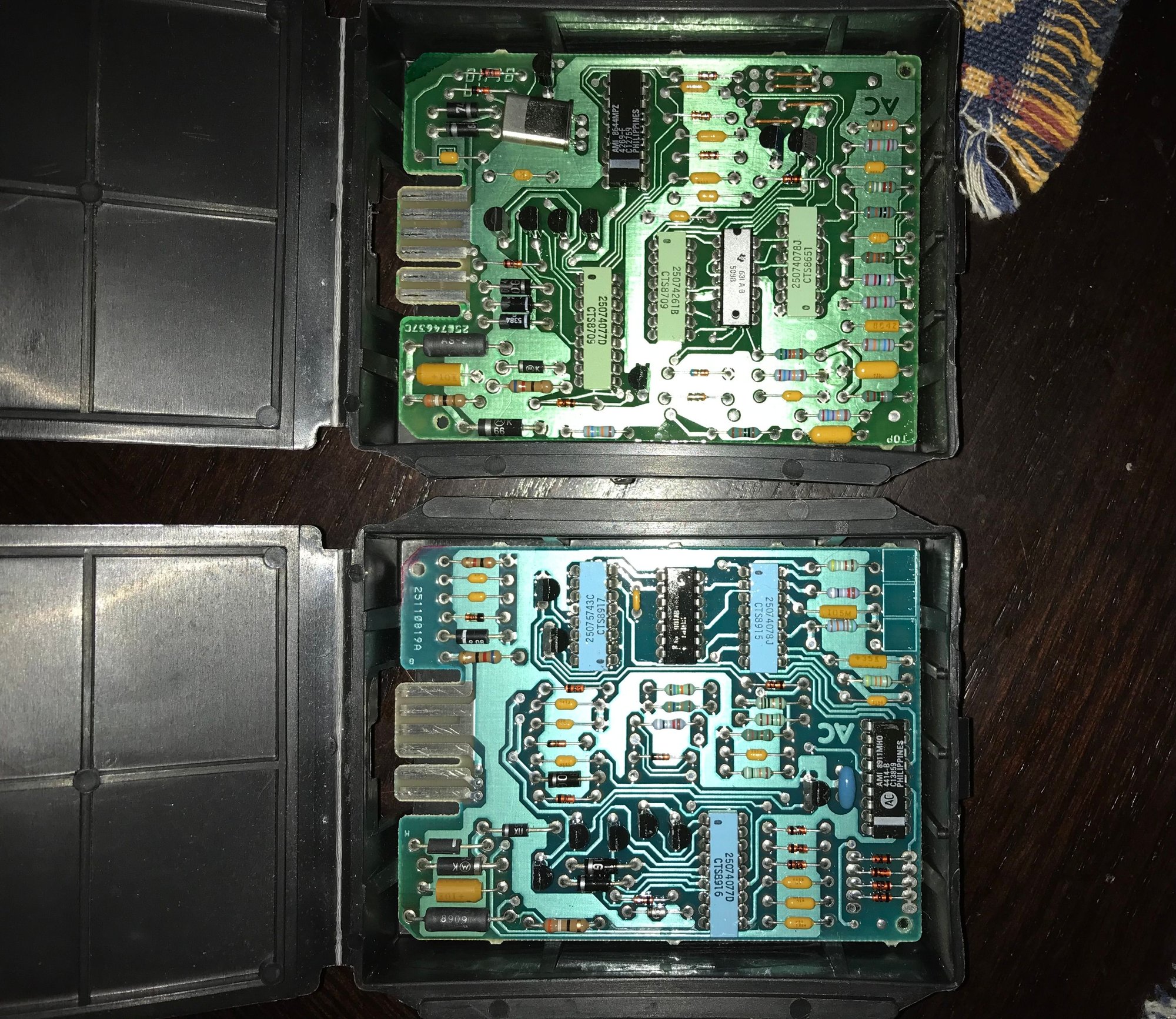

I removed the cruise module, opened it up, and looked at it under a magnifying glass. I didn't see any obvious solder joints that have come loose. The cable going to the throttle was routed beneath the brake booster which had it in a bind a bit, so I routed it correctly, but still no change.

Just an update, I replaced the servo with a used one and it does the same thing. I just received a used module off of eBay that I'm going to try next.
Here's the weird part, they are two different part numbers, however Rock Auto shows them being interchangeable. From my research on G-body forums and elsewhere, it appears GM used different parts even on the same model.

Cruise is now fixed! Apparently the modules rarely go bad, but mine did.
