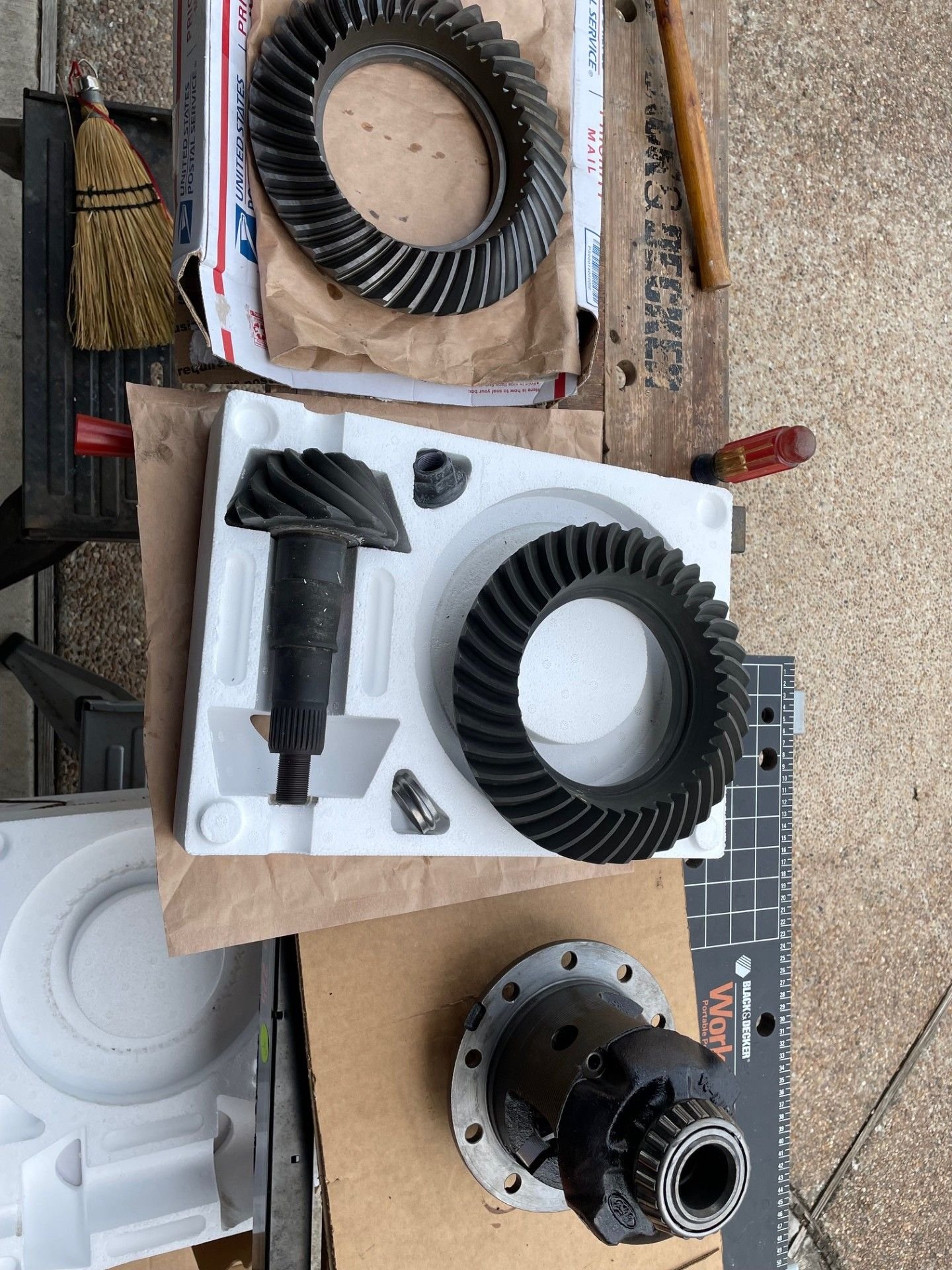

I dealt with this same issue last winter when I finally got my 5-yr project (LS376/480, T56 Magnum swapped 1991 Mustang coupe) on the road. I used the 3.08 geared Ford 8.8 rear end that came out of my '91 Mustang GT that I ordered brand new in 1991. The GT sustained a lot of saltwater air rust damage from when I used to live by the beach in north Florida. Anyway, the GT had the WC T5 with a 3.35 first gear. It was a good combination with the 3.08 rear gear ratio.
My T56 Magnum is the close ratio with a 2.66 first gear. When I got the LS swapped coupe on the road last November, the 2.66 first gear with the 3.08 rear gear felt like I was starting off in second gear. The engine has plenty of power but I had to slip the clutch and it wasn't fun to drive but boy did the car fly on the interstate in 6th gear! After driving the car like that for about three weeks, the car went up on my jackstands and I swapped the 3.08s for a set of Ford 3.55s. Now it's much, much better!
