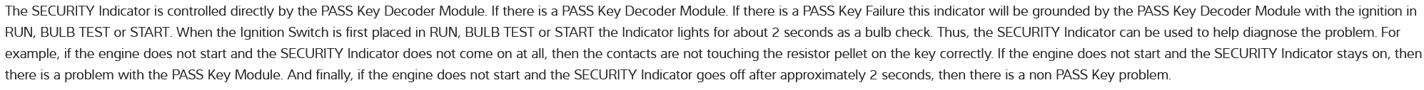

Here is a quick read to clarify the value of the "SECURITY" light...and thus, the likely hood of YOUR issue being a VATS issue, or something else:
