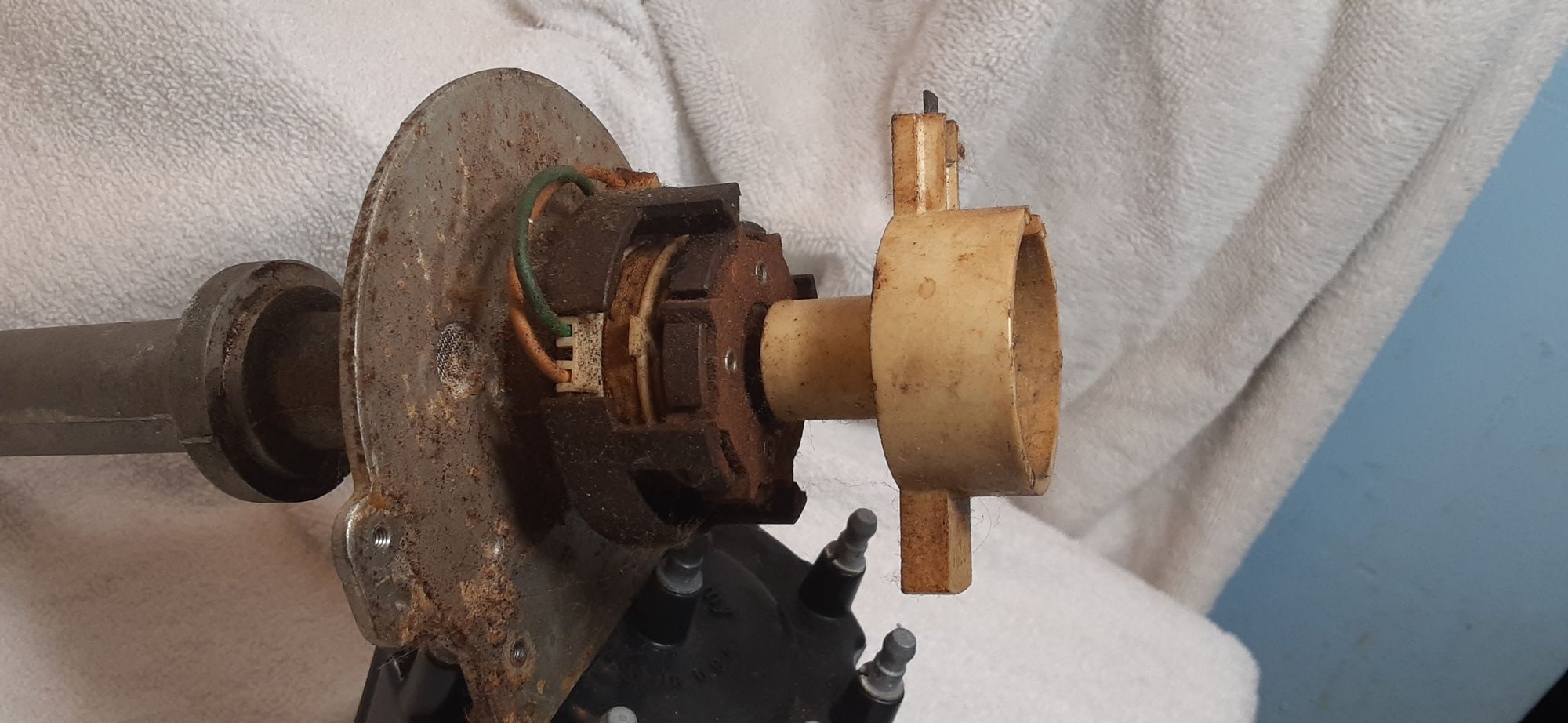

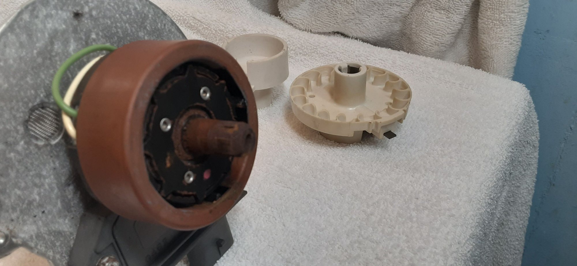

I took a few pics of the rotor button and where it goes on the shaft.
The black lines show how much you can rotate it back and forth.
Where the rotor button goes on the shaft of a new not rusted up shaft end.
Amount of rust on the end of the shaft where the rotor button goes on a 3,900 mile used distributor. Sorry my phone focused on the background and not the foreground.
Back side of standard rotor button and HD/Marine rotor button where it pushes onto the end of the shaft.
When the metal pieces in here get rusty and the end of the shaft gets rusty and that rust expands it make the rotor button very hard to get off.
All original 27k mile 1990 Formula 350 distributor. Notice it doesn't have the copper/brass looking shield on it.
There was a heaping handful of white fluffy corrosion and some green corrosion inside.
You could have ate off this car outside, inside, and underneath. Inside the distributor after 27k miles it looked like came off bottom of ocean floor next to the Titanic.

Short trips, heat soak and condensation cause the distributor to get nasty.
the original distributor would have had the shield on it. My guess is someone didn't put it back on after a pickup coil change.
When the pickup coil turns green, or fails an ohm check, replace it.

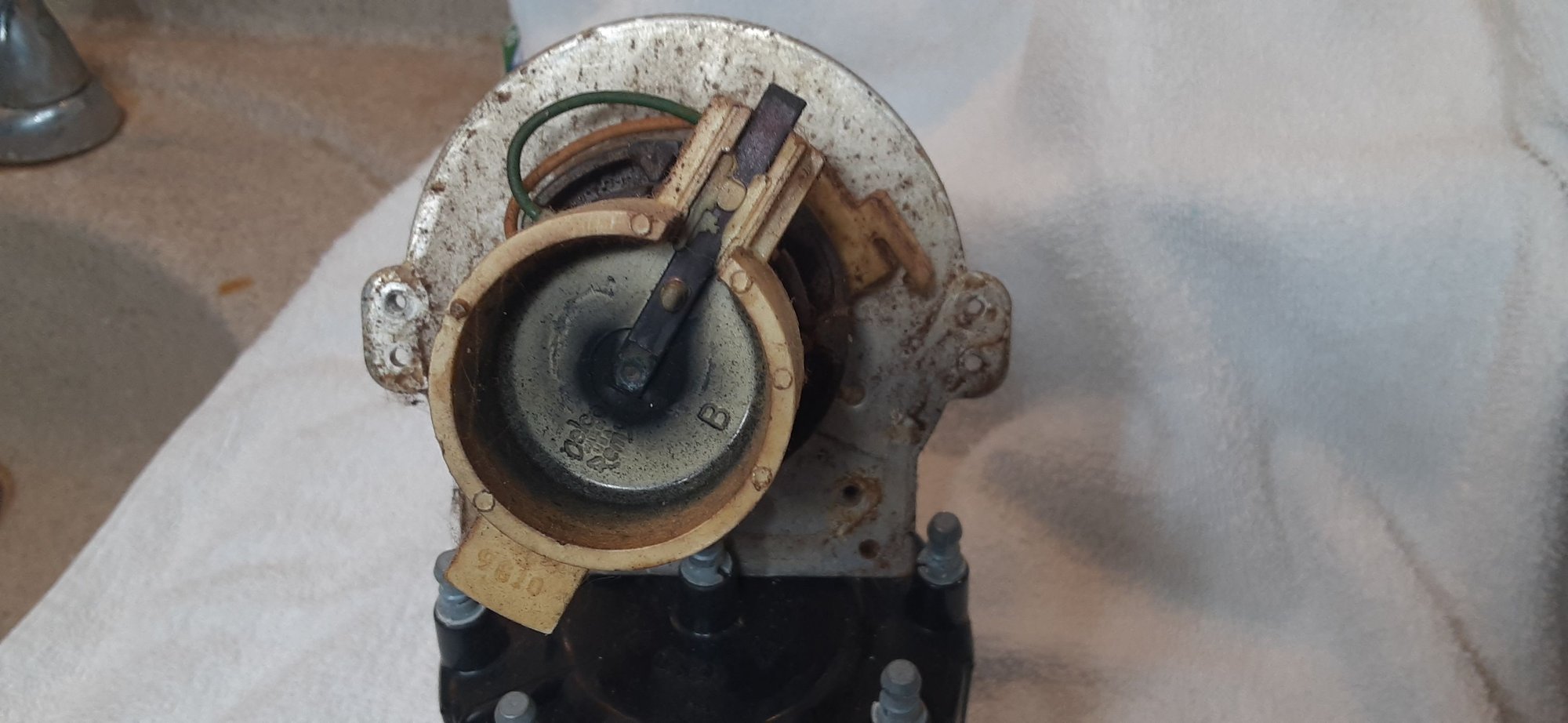

I'll snap a few pics of the inside of my distributor. I thought it looked pretty good considering it's 20+ years old.

Distributor photos

I think that time is being wasted looking at the distributor. I also think that time is being wasted on a lack of clarity as to the actual problem/symptom. First let's review the distributor and it's function. Functionally, what's the distributor made up of?
*Pick up coil
*ICM ("points")
*cap and rotor
The pick up coil does one thing: It says, "now-now-now-now-now...", to the ICM and/or the ECM. That's it. That's all the thing does. It's the electronic version of the cam lobes, on an older points style distributor. There is only one pick up coil, for 8 cylinders and it can only work, or fail. It may be possible for it to work intermittently, but I've never seen that. What ever the case, due to it's singular function and the "mix up" of the firing order after the fact (done by the order of plug wires connected to the cap), the pick up coil most certainly can NOT discriminate between the left bank and/or the right bank. It can't. So if we truly have a dead right bank, it can't be the p/u coil.
The ICM does one thing: It says, "ground-ground-ground-ground-ground...." to the Ignition coil, by providing a ground to the coil's primary circuit, then opening that ground....it's the electronic version of the points' system's contacts, opening and closing on an older points style distributor. There is only one ICM, for 8 cylinders and it can only work, or fail. It may be possible for it to work intermittently, but whatever the case, due to it's singular function and the "mix up" of the firing order after the fact (done by the order of plug wired connected to the cap) the ICM most certainly can NOT, discriminate between the left bank and/or the right bank. It can't. So if we truly have a dead right bank, it can't be the p/u coil.
None of ^that^ has anything to do with "distribution" of anything, it's incidental to the term "distributor" and those components were mounted IN the distributor (starting in the 1920's or '30's), out of convenience and their location w/in the distributor has nothing to do with "distribution". Those same components could have just as effectively been mounted on the cam, completely remotely (as they are on L31's and LT1's) or where ever. The two parts don't have ANYTHING to do with "Distribution" of spark at all. They're simply signaling or actuating devices. The only two "distribution" devices in the whole engine, are the CAP and the ROTOR. They take a "spark- spark-spark-spark-spark..." and send that to 8 posts/studs where we plug in wires that run to the various 8 cylinders.
Thus, the cap and rotor are the only ignition parts related to the "Distributor" that could discriminate or have an effect on the left bank vs. the right bank. NOW...is it likely that the cap and rotor could or would send a spark to #1 post, NOT the next -#8 post, and not #4 post, but then yes to #3 post, but not to #6 post, but then yes to # 5 & then 7's posts....and then not to #2's post? It's incredibly unlikely.
So in this discussion of the distributor as a potential cause of the PERCIEVED problem of only one bank not running....I think it's wasted time to continue to look at the distributor. Spark plug wires? Plugs? Maybe, sure. Because routing, shorts/burned spots, fouled plugs, etc could cause that symptom. Could. Distributor? Probably not.
Having said all of that, I think that we need to go back and re-assess the "Symptom". It was stated at the beginning that the rear (right) bank wasn't firing.
1. I don't think the engine would idle on it's own (no throttle input) on only 4 cylinders
2. We have compression, valve actuation and we verified spark on the right/rear cylinders.
3. We were later shown pics of sooted plugs from the right/rear bank, so at least some firing has happened in those cylinders.
I think that the OP needs to put new plugs in it....get cheapy plugs for diag purposes if money is an issue....and start over on the assessment of what is REALLY going on with this engine. Let us know the facts of the condition.
