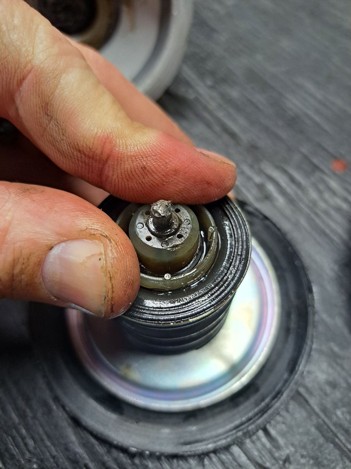

I don't recommend a cheap replacement. I have been through 2 on my Camaro over the last 40kish miles. First one lasted years but eventually began leaking around housing like yours. Second one lasted less than 2k miles and failed suddenly while cruising down the interstate. Lifetime warranty means nothing if the cab ride home costs more than a quality replacement.
The last crap one was made in China. I feared the worst when I saw that on the box, but stupid me went ahead and installed it anyway hoping the lifetime warranty would mean something. I replaced it with a Carter (made in Mexico) off Ebay. I would prefer one made in Taiwan but nobody wants to post the origins on their websites.
I created a bad review with pictures of the crap one on OReillys website. Doesn't look like they ever posted my review on the website, so I guess they are protecting their crap investment.
Here are pictures of the failed Chinese one. Top of shaft going into fuel pump lever broke off. Pure garbage metal from China.
Did I mention it was made in China?

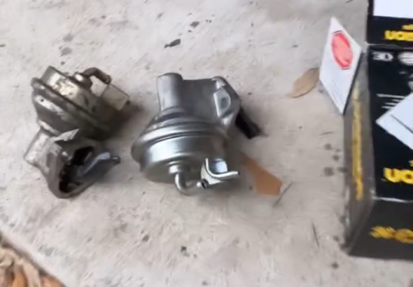

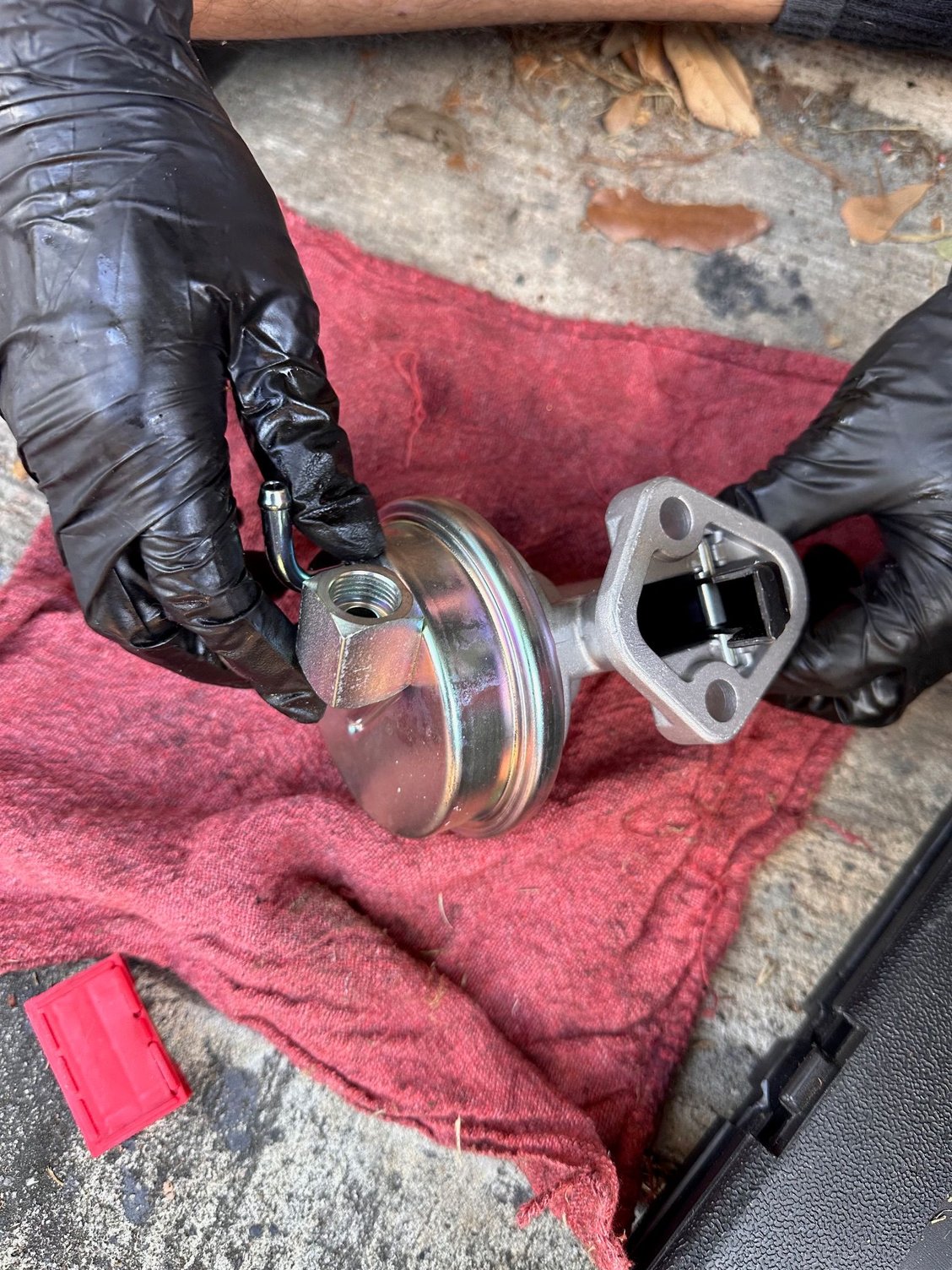

Issue: Fuel pump was leaking out of weep holes aka busted diaphragm.
So got it replaced with a buddy and everything went smooth right up until the hardline to the carb didn't align with the pump outlet threaded connection! Not sure why the old pump and the new pump had different angles for the line connection, but after a lot of swearing and hitting and bending slightly AND disconnecting the Carb end so we get more freedom of movement on the line, we got it to align and now she starts up with no leaks (so far, fingers crossed). Luckily I had purchased 2 pumps, one from Rock Auto and one from O' Reilly's and both had the same issue. Maybe whoever installed the old pump changed the line angle? Anyone had this issue before?

It's not uncommon to have that issue, simply b/c look at what you're working with: Cheapy-azzed, stamped tin parts. It's not like the steel fuel line, the pump body, etc are "precision" pieces. Plus, you got slop in the pump bolt holes so it's not only possible, but it's likely, that the pump didn't "land" when you tightened the bolts, at exactly the same angle/elevation etc. as the pump that you removed.
Anyway, I'm not surprised. Sounds normal. It helps, as you discovered, to keep one end loose, until you have the other end properly started...and it's normal to have to "tweak" the steel line as well.
