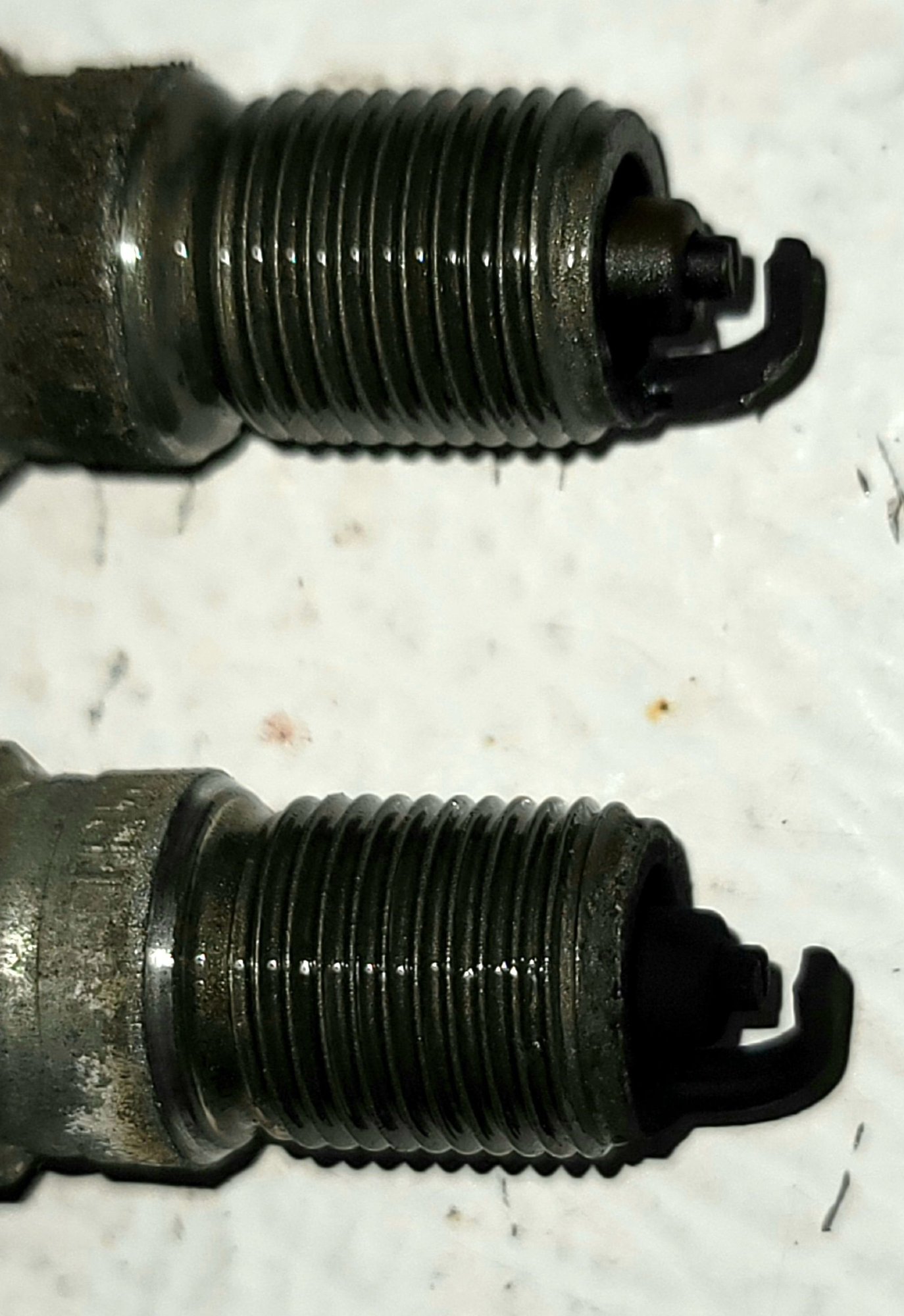

7. Checked plugs in rear bank. Good, but wet with unburned fuel.

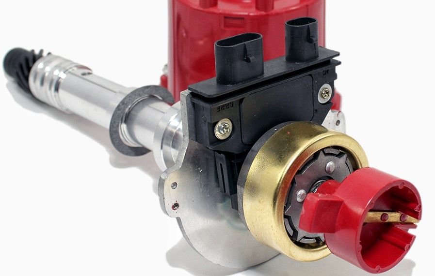

9. Tested spark with spark tester at distributor. Tests good.

I have a replacement rotor for the distributor, but the original wasn't coming off and I didn't want to make it worse trying to force it, so I cleaned it up with some emery cloth and stuck with it for now.

Pulled all four rear bank plugs. All four wet and gassy but otherwise properly gapped and fine. I can't figure out why this would happen, but it seems to point to the ICM. But would only one side of it fail?

Distributor question: does it matter if the large ring that sits between the rotor and the ICM moves? I can rotate it maybe 10 degrees independently of the main shaft before it stops.
TPI distributor

If you are talking about the copper brass looking piece then no it doesn't matter if it can rotate around that much. I forget what that part is called and a lot of these small cap HEIs didn't even have that part when new. It was added at some point along the years. I have a 27k mile one I removed from a 1990 Formula 350 and that distributor doesn't even have that copper brass looking piece. It's a shield of some kind. Maybe for EMI or maybe some attempt to prevent them rusting and corroding to death inside. These distributors really should have had a vented cap.
I just checked an NOS new one, a 3900 mile one from a RamJet 350 crate engine, and another low miles one I removed from something I've forgot now and that piece can rotate around a decent amount of degrees.

Thanks Airwolfe, you'd definitely be the guy to know about that! Well that's one more potential thing to cross off the list. Is there a trick to getting the rotor off? I've tried prying it every which way I can think of without damaging it but it just doesn't want to come off.

Just pull like Hell straight up on it and be prepared for where your hands are going to fly off to when it lets loose. You might take and small handle screwdriver or something and peck on the round base of the rotor button with the handle up under the rotor button where it pushes on top of the shaft to help break it loose some. Even brand spanking new they are on pretty snug.

Plugs #2 & #8
First two plugs I took out for cleaning with a new HF plug cleaner I mounted up this morning. #4 & #6 looked about the same.

OMG is that an abrasive media blaster that uses garnet sand to blast the sparkplugs clean? I'd very closely inspect them with a bright focused light to make sure there isn't a speck of abrasive media down inside them or on the threads or anywhere on them before installing them. With your aluminum heads I'd also put some anti-seize on the threads because the blasting media might have stripped off the special coating/smooth finish that was on the threads of the plugs when new.
Wow have sparkplugs got so expensive now that people are having to blast them clean instead of get new ones?
