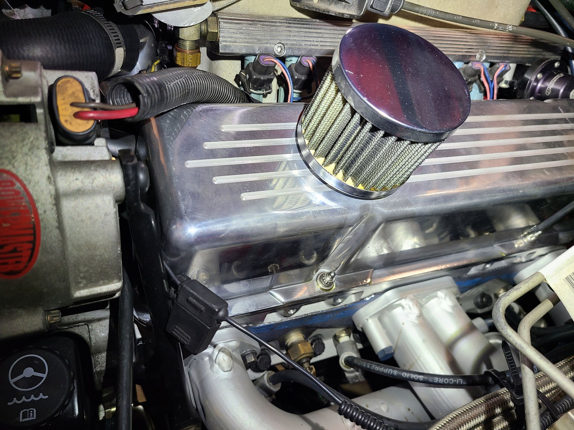

Originally Posted by raptere

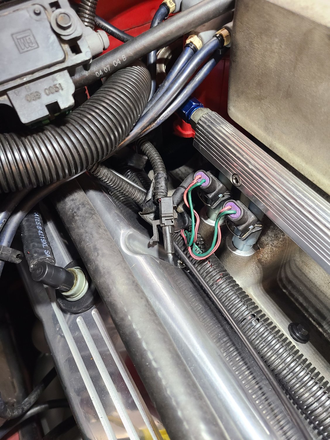

... I just don't recall ever noticing this connector hanging out here over all these years.
It's difficult to tell from the picture although I recall on one of my former TPI Camaros with factory AC, there was a large single conductor connector. IIRC, it came in directly from the starter stud via a fusible link. It was attached to the firewall via a clip and I believe it served as a power source for the aforementioned AC.
Don't quote me on that as it was more than 20 years ago that I had that car. It was my jumping off point for my re-entry in hot rodding (having taken about a 20 year break).
If it helps it is two wire connectors, not clear from the angle of the photo, wires are a pink with black stripe and a gray and A and a B are molded into the two wire positions on the connector.
In that case, being two wires, it isn't the power connection I spoke of.

Re: Fuel Injected 383 SBC Build for Street and Autocross

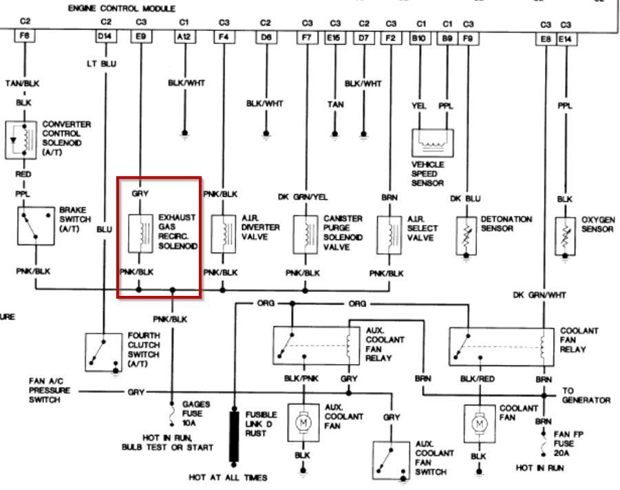

Looks like it is the EGR Solenoid... Which I no longer have...
Wire is gray on one side and Pink/Black on the other.

Somewhat similarly, while I have the bones of the wiring, i.e. the TCC colour coded wires, nothing on the schematic exists in my car. That fusible link D is still in play but it too isn't long for this world.
It's a good thing for us we have a record of what was going on with these now 40 year old cars. It can be immensely handy, as demonstrated by your detective work!
That said, there are elements of interest in that diagram. Primarily the routing and colour coding of the fan relays. I've revamped mine but some of the OEM harness is still in use.
Thanks again for posting that (I do have it buried in a couple of service manuals but this is far more accessible).

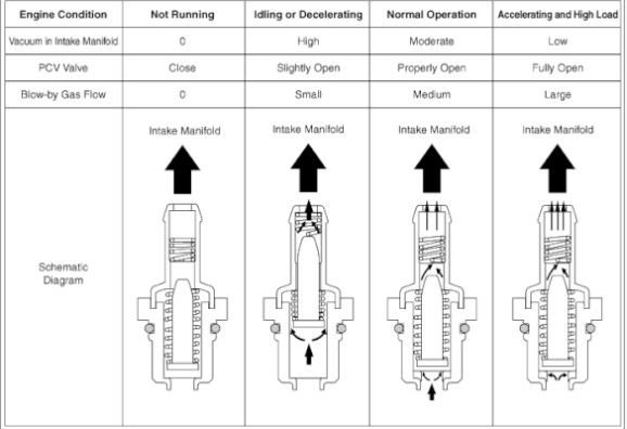

I'm running into another small issue, and they're oil leaks...
First, I've got oil coming out of the valve cover breather. I removed the baffle under that hole on the cover because I wanted an easy spot to fill oil... Im running the pcf valve to the other side' and that filter is just fresh filtered air in for the pcv system. but I'm going to have to do something not sure what. Thoughts?
Second I'm seeing oil coming from somewhere near the oil filter or filter cooler. This is pretty annoying because I specifically got new gaskets for all that so I need to get under there to check things out... May just wait till my first oil change and look at it then... breaking oil wouldn't act any differently in terms of leaking right?

You have to ask yourself how a PCV valve works under various conditions.
When you have it pinned, manifold vacuum is very low (approaching zero in a well developed engine) and crankcase pressure is going to be high. Despite an engine being freshly built, there's going to blow-by to some degree. That's going to push oil out of your unbaffled valve cover breather. The same applies, although to a lesser degree, while cruising.
My breather is on the passenger side, the PCV valve on the drivers side and is routed through a catch can before it gets to the intake. Both openings in the valve cover are baffled. I've a separate sealed filler cap for adding oil (drivers side towards the rear).
The old tired 355 had a great deal of blow-by. Despite having baffles, after a day of "racing" there'd be an oily residue on the breather and the catch can held a considerable amount of oil. Considerable meaning that there was some and there should, for all intents and purposes, be next to nothing.
As for the oil leak, I'm chasing the same thing at the moment. Mine appears to be coming form a valve cover centre bolt. ( I'm aware you have perimeter bolts). Prior to that, I was having a hard time getting the silicone to seal between the head and the cast aluminum cover. It wasn't until I RTV'd the gasket to the cover that I had an effective seal. But the leak is now from another location and it didn't exist prior to rebuilding the engine. I'm hopeful that I didn't mess up the RTV between the intake and the block (the so called china wall).
FWIW, I had a remote filter on the big block Trans Am and I had a persistent leak between the adaptor and the block. And it's all but impossible to get to without lifting the engine and pulling the left side header. So it drips to this day albeit the car is now in my nephews possession. It's HIS problem now.

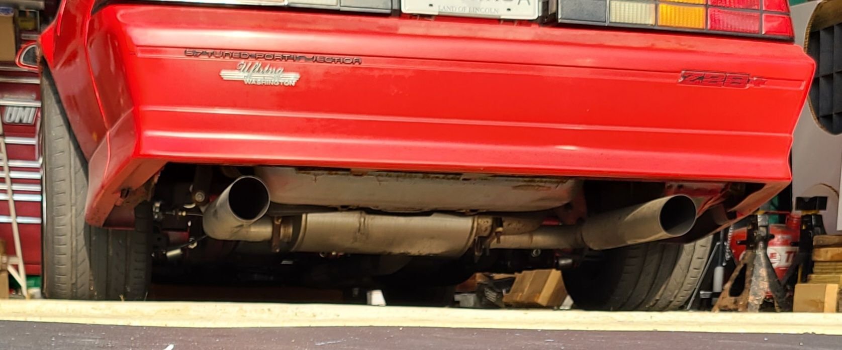

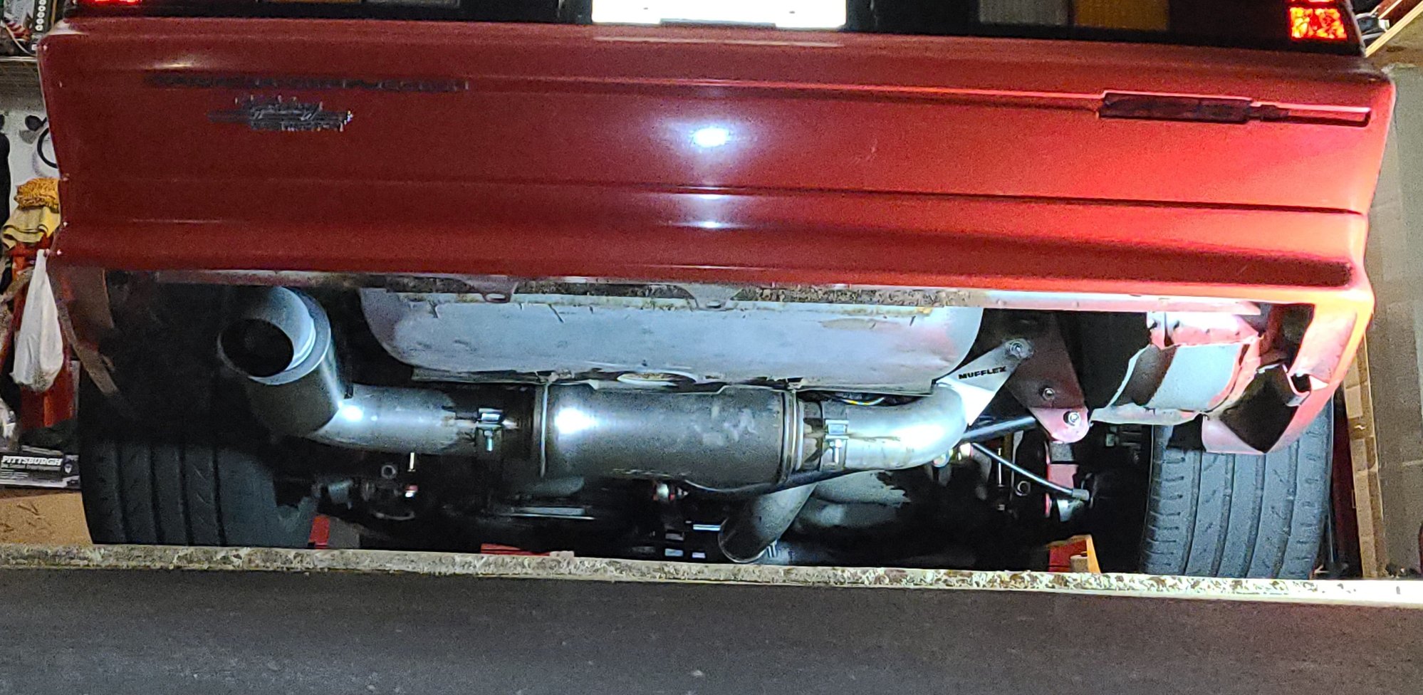

After a few evening tuning sessions, the neighbors made it clear to me I was going to have to quiet things down...
Original Magnaflow Catback
Inside original muffler, about half the exhaust goes by a semicircular baffle and exits UN-MUFFLED. This made it the loudest configuration.
First I pulled my magnaflow catback and replaced it with a 3.5" single turn down exit Mufflex system with a straight through Magnaflow muffler. All of the exhaust goes through the muffler with this setup. This made it better, but I was still not getting the best feedback from the neighborhood.
My latest step was to install another small round straight through Borla muffler in the single exit. I have to drive it a bit more, but it definitly lowers the pitch, or only let's the lower pitch sound through... Not sure in my final thoughts of that yet. I just finished welding it in tonight.
I think it is about as quiet as I am going to be able to get it with the cam and engine setup I have. Remember, decent size cam, with good amount of overlap, and relatively high compression...

Another thing I should mention here, is while tuning is moving along nicely, I am finding the engine given the cam and other variables simply doesn't like running smoothly below about 1700 rpm. I need to be changing my rear gear, or whole rear end from my current stock to probubly a 3.73 ratio rear gear. (Or maybe 3.55) This will upper the rpms at cruising speeds to get them more into rpms where the engine runs happier and more smoothly. It will bring your highway cruising engine speed up too, but with a 700r4 trans, factory 26" tire dia, and 3.73 rear gear, cruising on the highway will be about 2700 rpm at the 80 mph most people around here drive... pretty high, but not too bad...

My timing was a bit less than you had it so I tried upping my timing a bit in my cruising range to be in the ball park of 40 and 45 respectively. Seems to have smoothed things a little bit. I do have my TCC set to lock at 50 MPH, so it does allow the revs to come up a bit, but its still in that 1500-1600 rpm range in some driving conditions. I'll say, I'm not sure I'd ever describe the engine to be smooth as glass at any speed, so we may have to discuss that more.
I'll add that the addition of the smaller last Borla muffler, did reduce a lot of the mid and higher pitched tones, making it overall quieter, but now it is REALLY bassy. Maybe even droning, but generally I associate droning sounds to be more mid frequency sounds. Guess you just cant make an engine like this quieter without restricting it with say a turbo muffler or something... Not going that route though...

As for your exhaust my crappy single 3" Flowmaster does two things.
Idle and mid-range it has an excellent note with no drone. A quick zing on the throttle and it gives a nice bark too.
The 2nd thing it does is KILLS power at WOT. I've proved it at the dragstrip by uncapping it right at the 90° bend before the muffler.
Similar to you but in an opposite sense, I need to address this too. In my case, I'm pretty sure I'll keep the Flowmaster for street duty but install dual cutouts just after the collectors. It'll require a 2nd tune for track days but that's not a deal breaker.

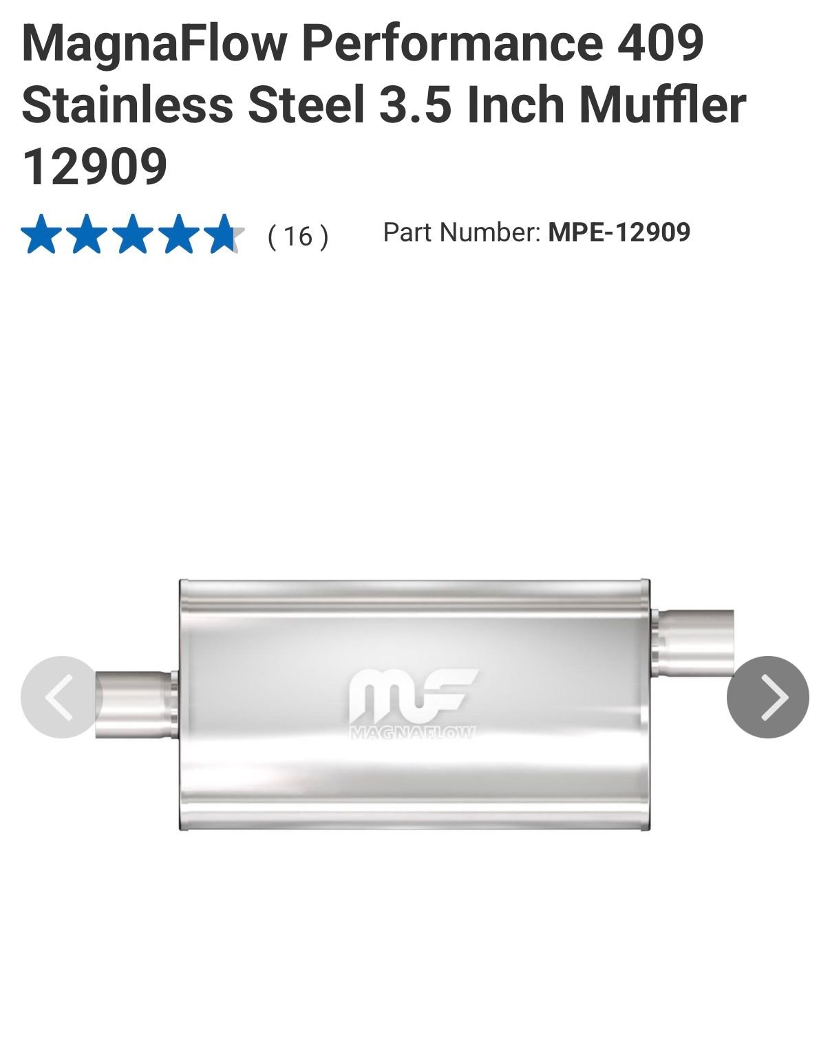

Maybe they stopped making it, but I'm not seeing any 22" (Body or overall length) muffler from Magnaflow. At least not in the 3.5" size... The one I have in there now, that came with the Mufflex system, is the Magnaflow 14151 20" overall length (14" body) muffler.
Old Jul 28, 2025 | 04:13 PM

ohhh... it's center/offset, i was looking for center/center like my current setup. Not sure if i could make that work with my current hangers or not...

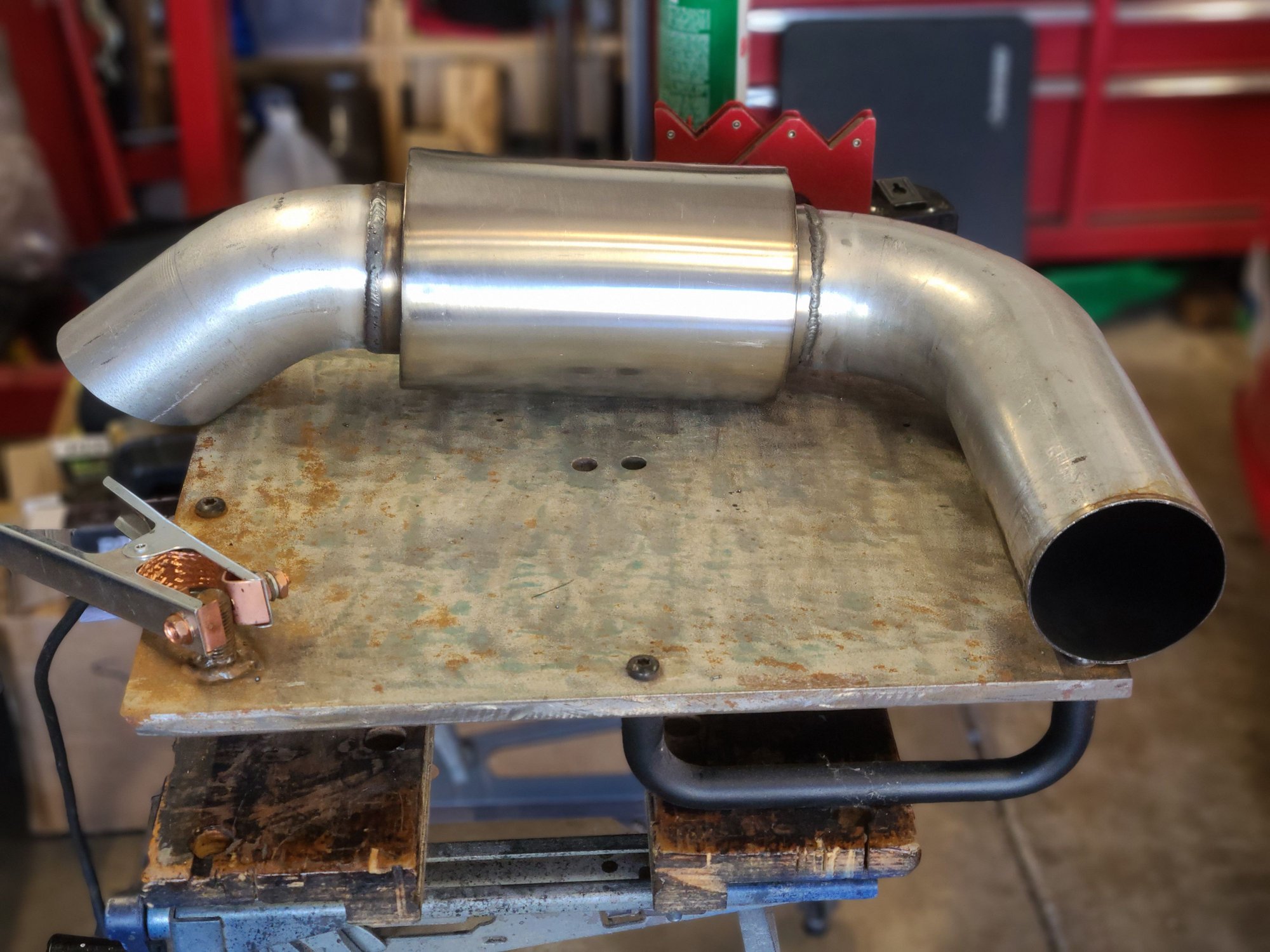

I did have to rebuild my tailpipe and move the hanger to make this one work. I built a 3.5” exhaust a couple years ago similar to the Mufflex system and used a center/center 14” muffler to start. When I got tired of the volume and an upstream muffler in the catalytic converter area still wasn’t enough help I went shopping and eventually bought this. It was just easier to cut up and weld a j-bend I had left over into a new tailpipe than to modify the tailpipe already present. Other than the awkward hanger position (I reused it instead of just making a new one) it actually came out better this time! Very tight to the body and just looks like a very large factory exhaust.
