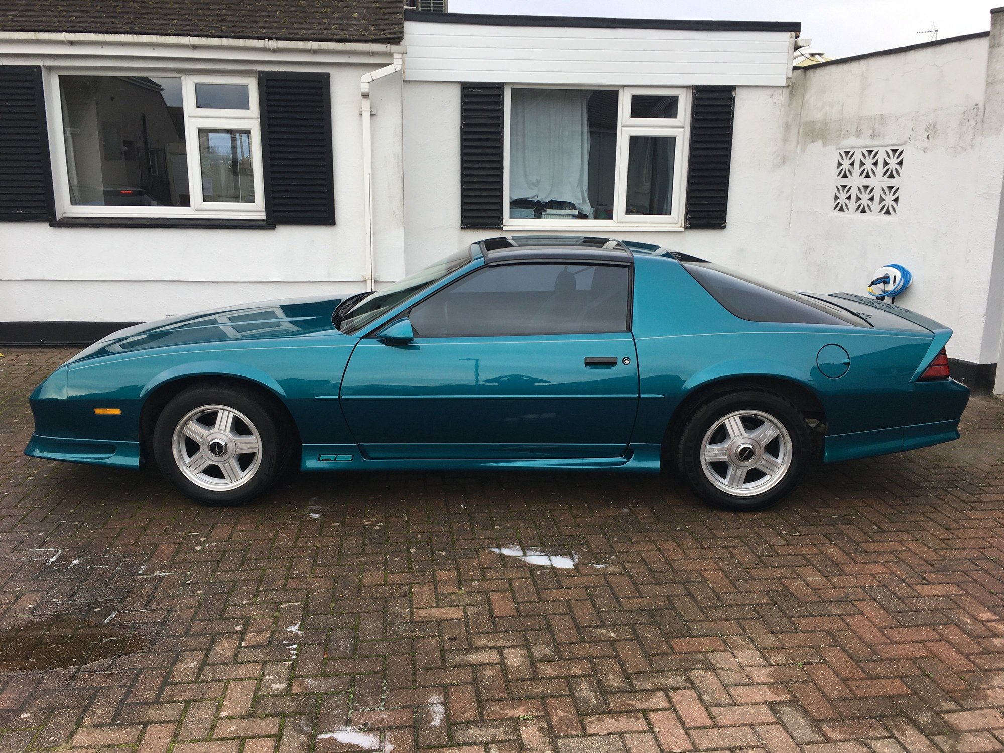

A nice photo of it, so you can see why I want to get it working properly again!

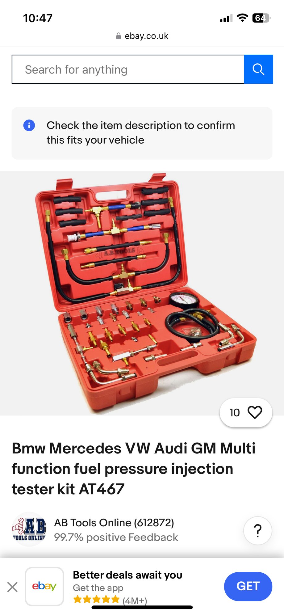

Not yet. I don’t have the tools for that one. I had hoped to find a set with the TBI adapter in it, but can’t seem to find a reasonably priced one in the UK. Would it be something a garage can do pretty easily? Or do I have a different option?

might ask if the line fittings in the kit are gm saginaw, can put inplace of the fuel filter.

How easy is it to read the pressure with a gauge that goes that high?

Ask the seller for a gauge picture. I’m sure it has 2 psi increments .

they replied back & youre correct. 2 psi increments. Kit ordered and I’ll give it a go when it shows up. Thanks for the suggestions & will keep you posted!
