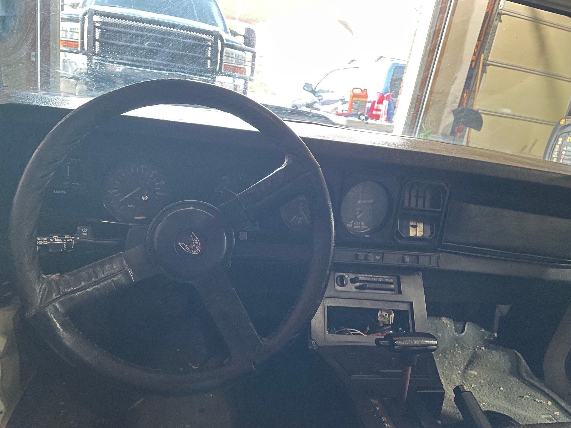

I’m going to be 110% honest, I have no idea lol. Another thing maybe yall might be able to give your ten cents on. None of the dash gauges work when I go to start. I’ve seen videos of other birds that show at least them lighting up before the car starts. Is it the wiring behind the gauges that need to be checked out? Also, the fuse for the dash pops when I go to start it. Thanks guys!

does the gage fuse pop when it's in the acc position and the run position or when your starting it? Do you have any aftermarket switches/stereo stuff wire in? The cool guy who wired in the fuel pump may have done a really good job wiring it in. You may wanna disconnect the inline fuel pump and see if it still does it. That goes for any things wired in that's not stock. Who knows where power is getting pulled from. And how it is or isn't grounded! You could post pics of the interior if there are any "added" electrical items.

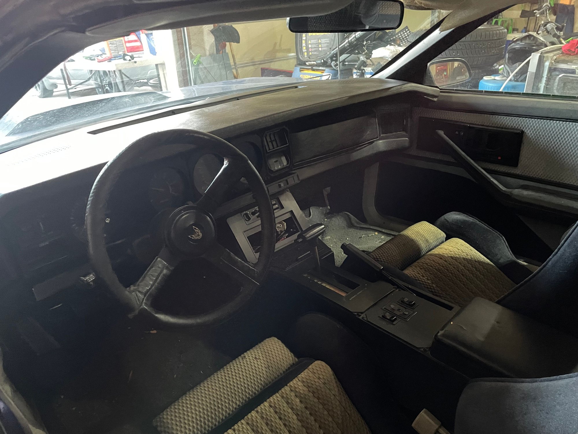

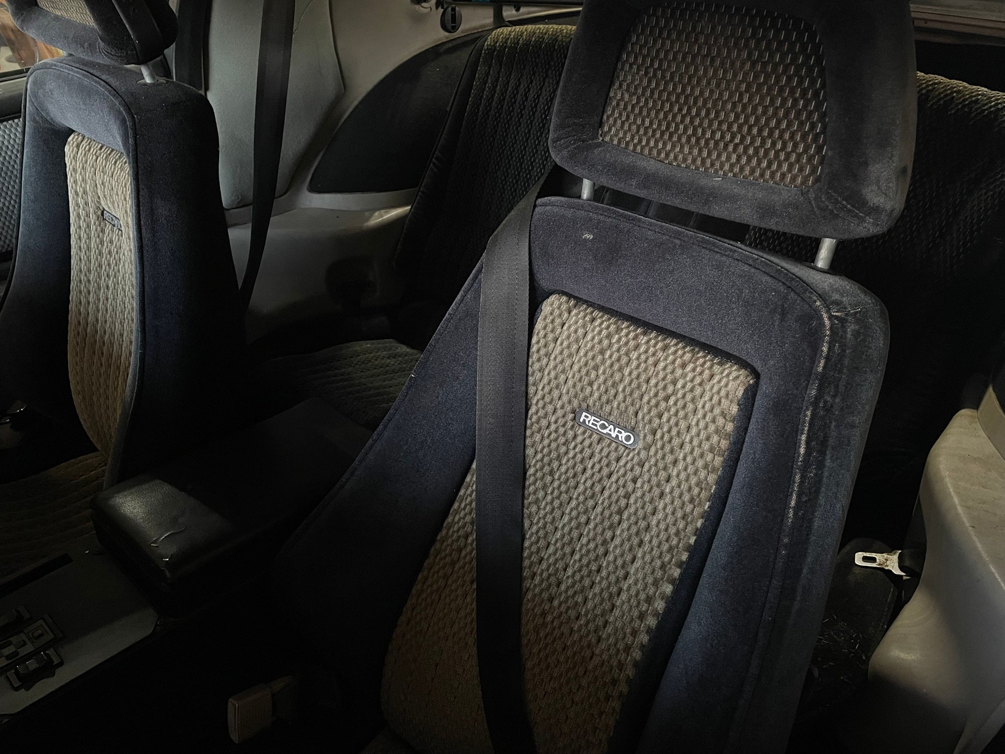

That looks really clean all over. The interior looks great.
I may be wrong but I thought the crossfire only had the th200. This car looks like it has a 4 speed. The shifter has OD and 3,2,1. The th200 only has the 3,2,1. Someone w more knowledge will know better. This car is totally worth fixing. I almost bought a black/white Recaro and I don't remember the seat/door panel material like that. But that was 27 yrs ago!
also, the gauge needles are white, I think only 82s had white needles. In 83-84 they were orange. I may be wrong here also.
looked it up, Daytona had the white needles and the CFI w a th700. You should be pretty good w that trans.
All '82 V8's had 200 trans. All '83 V8's had 700. CFI included.
My CFI car (an '83) had a 700...for a month of so.

That car is probably "too special" for me, being a Daytona/Recaro car w/the turbine wheels still in tact, etc.
I totally agree that it's worth saving/bringing back. Yep. Car has a lot of potential, IMO.
