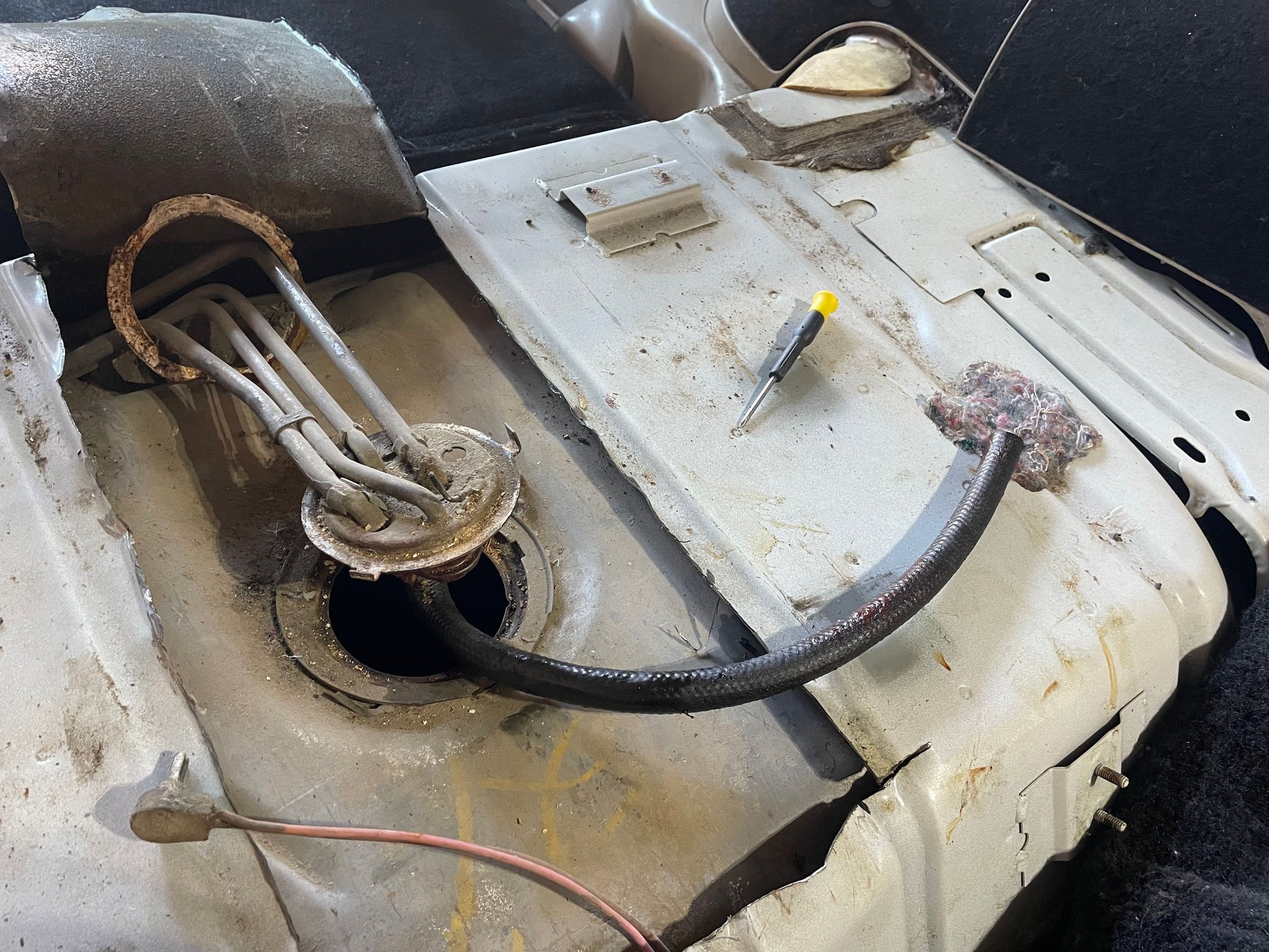

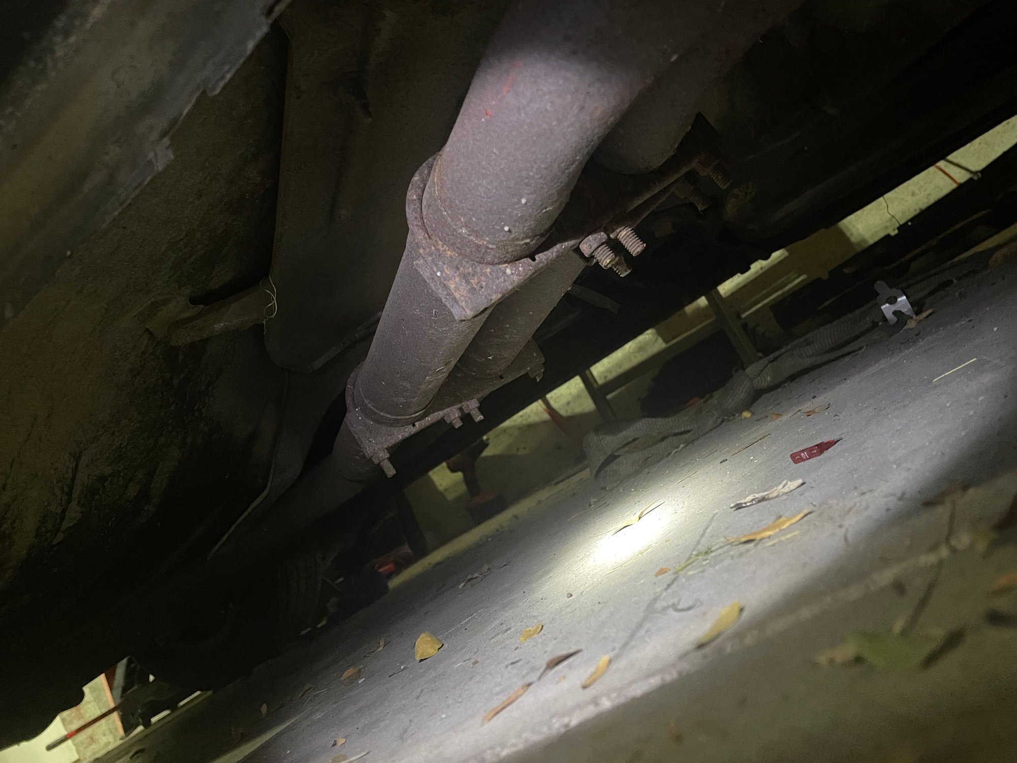

So, this is awkward. Just got this project a month or so ago. Obviously, it doesn’t start. I narrowed it down to the fuel system. Boy, was I right. Pop the trunk and find a cut to the fuel pump has already been made. Go to pull the pump out, and low and behold, there is literally nothing there. What do yall think my best course of action is?? Thanks!

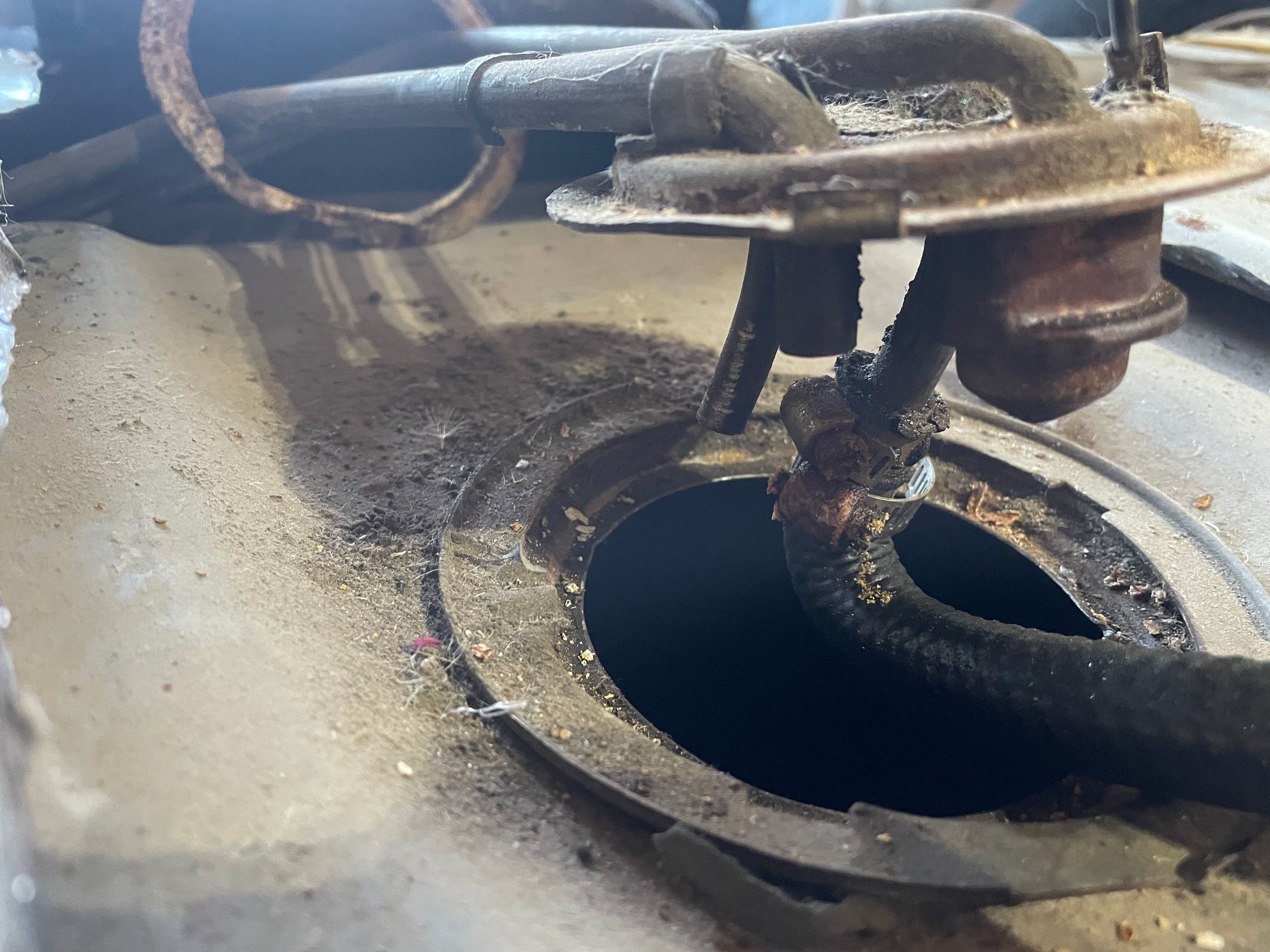

That's pretty hyeeenous. Someone set very low standards for their work and then failed to even come close to achieving them.
Looks kinda like Cletus and Billy Bob were rippin' out all that computer s*** and slappin' a carb on it. Looks in fact, by the amount of rust on the hose clamps and whatnot, that they did this A LONG time ago. Maybe it even ran like that for a few years.
Maybe... get a fuel pump and put it in there? After dealing with all the rust of course. Depends greatly on what induction system you are putting on it. The CeaseFire will need a pump obviously; a carb setup really only needs the hose in the tank (which needs to be continuous-immersion rated, which that there is NOT) and a filter on the end to keep out the crusties.

PO really screwed that up! Just wow! Are you still running the Cross Fire Injection? If so, there has to be an add-on pusher pump somewhere in-line on the fuel supply side. If the car is converted from CFI to Carb, there is again an add-on pusher pump or someone bolted on a regular fuel pump on the block. Crawl under the car and look at the fuel lines.
What would I do? I would buy a new sending unit (since by the looks of it the gas gauge is not working), and either add the correct fuel pump for the CFI or a L69 pusher pump. Then weld up the hole in the trunk (after pulling the old fuel tank), find and eliminate the pusher pump, but if the car was converted to carb leave the regular fuel pump on the block.

Wow. Ok. Thank you guys! So, it is a crossfire still. I really don’t know what the PO was thinking when they did whatever they did to the fuel pump lol. Here’s a pic of the fuel line (or at least what I think is the fuel line, right after it drops down below the tank)I noticed that one of those lines looks cut?

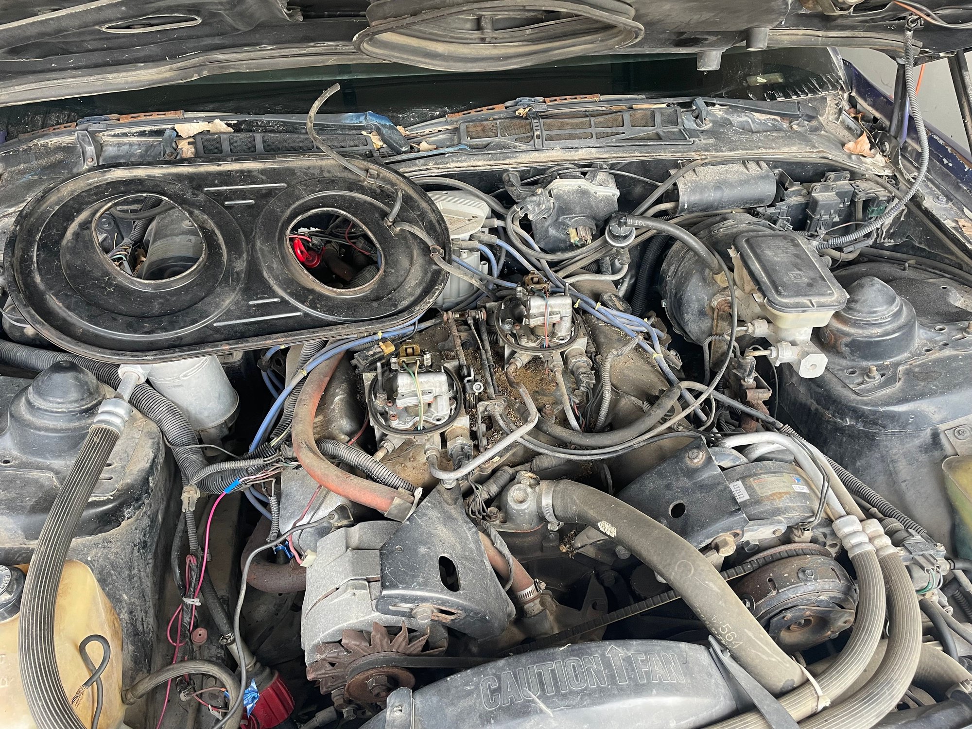

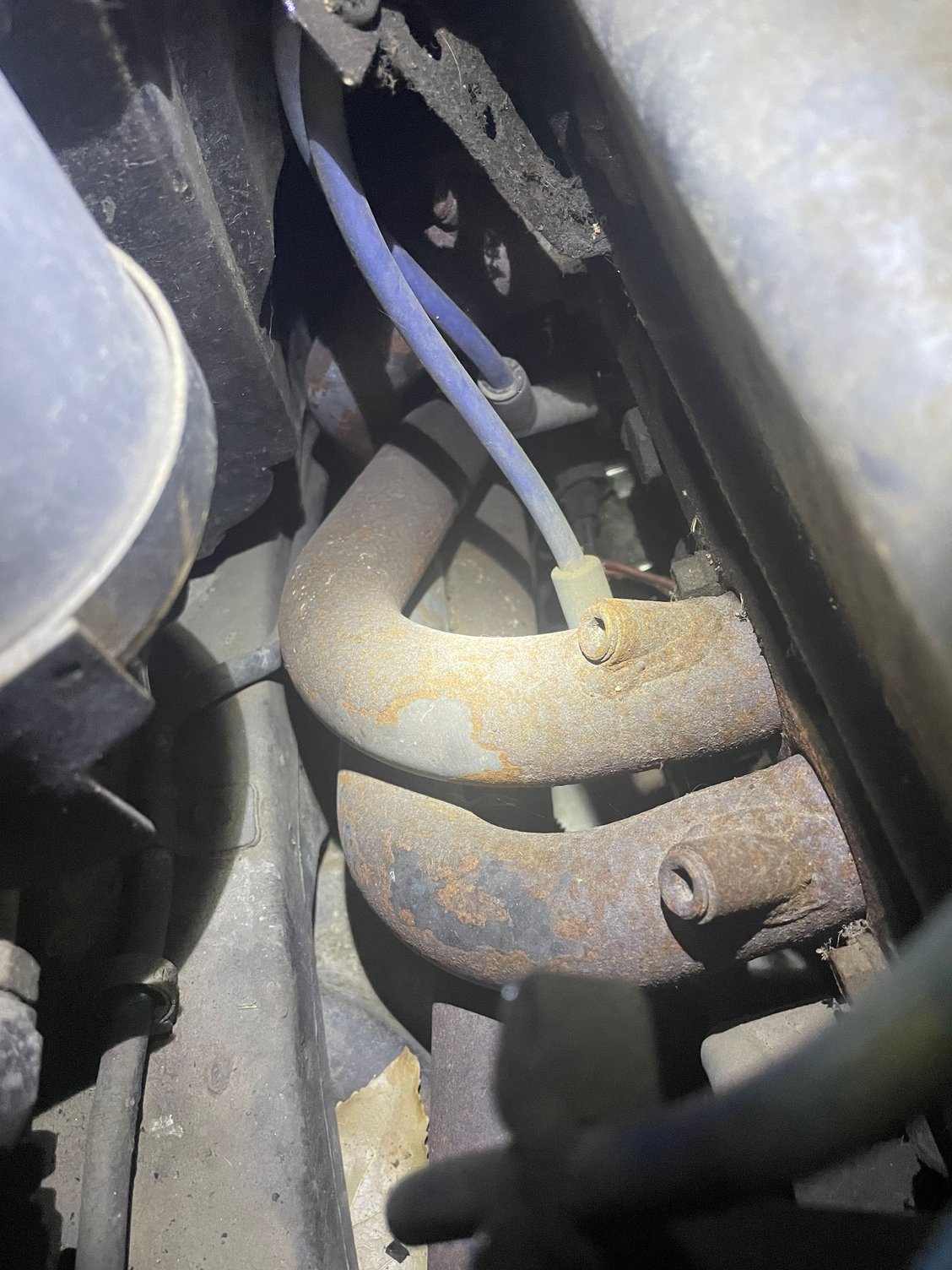

I thought I would add a pic of the engine. It’s gonna need a lot of work, more than I probably should have released. I have the intake off in that pic.

Pictures are always better than words; and by the looks of them what Sofa said was correct. The Red thing on the passenger side frame rail is the pusher pump. That is what "Cletus and Billy Bob" added to get fuel to the Cease Fire Injection (haven't heard that in years). The disconnected line that you provided the picture of was probably the fuel return line. You have a big mess on your hands. This is decision time, and it comes with cost. What are your intentions for this bird? Factory stock or LS swap (joking - maybe not). That entire fuel system from the tank to the TBI units needs to be replaced (including the tank), just to get stable fuel introduced into this system in my humble opinion (which means nothing to anyone else). Are you attached to the CFI? Do you want to swap out for CARB? By tossing money at the problem and time might not be the best option if you plan on upgrading later...

That Crossfire setup looks pretty haggard. They don't have a great reputation. There was a guy on YouTube once, ran a channel like Crossfire Garage or something. He was really into it, his car almost completely ran for tens of dozens of miles. Started having problems keeping them in sync. Needed parts that were hard to find. He ended up swapping to TBI which actually worked correctly and renamed the channel.
The point is, since you're in it for a fuel pump, now would be a great opportunity to choose something more reliable and easier to live with for an induction system.

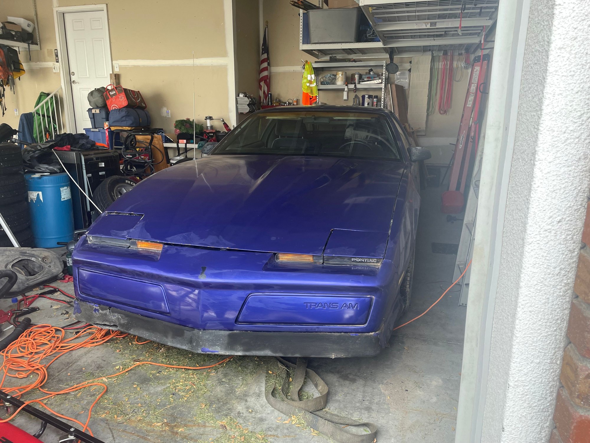

Just for fun, here’s a pic of the car😆

Yeah the old Crossfire system was pretty much the absolute outer limits of what was electronically possible, in 1979 or 80. Needless to say, everything about it has been supplanted since then. Even the late 80s TBI system, which it's possible to almost DROP-IN DIRECTLY replace the problematic electronic parts of CFI with, is VASTLY superior to the rev 0 TBI that Crossfire was merely 2 of. In fact that's one of the upgrade paths people used to take back when anybody was still bothering to try.
Then of course, that doesn't begin to address the worst shortcomings of CFI; which if you're not already familiar with, you'll discover when you take off the intake, turn it upside down, and look at the ports.
I'd strongly recommend NOT trying to revive that CFI as-is. That one looks like it's enjoyed WWWWWWWAAAAAAAAYYYYYY too much sodomy to be brought back to life successfully. Time to swap to something else. Not necessarily a carb; butt that's certainly one of the options.

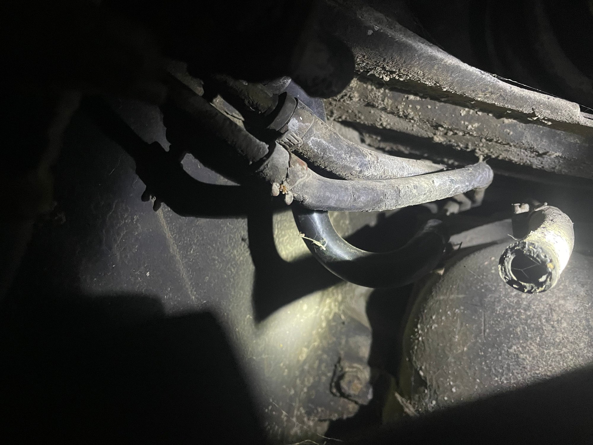

The cut hose is probably the tank pressure release. If so, would have gone to the "UFO" valve. Butt that's only a guess, since Cletus might have taken his box cutter to almost ANY of them and considered it A Good Idea. There's just NO TELLING what people like that might do to a car thinking it's an "improvement".

As for that fuel pump abortion, I'd rip everything out that the PO did, put in all stock fuel pump parts, lines, hoses, etc. then I'd weld the floor pan back together, grind/prime/paint it.

Do you have anyone that knows what they're doing or are you in it by yourself? Easiest way to get on the road would be to drop the tank and stitch that sardine can back together. Get a replacement tank and sending unit for a carb'd car, should hook up to the existing lines. If not, replacement lines are cheap. Pop the crossfire intake off and sell it to pay for a Chinese aluminum intake and get a 600cfm carb. The block should have provisions for a fuel pump.

Originally Posted by exiled350
Get a replacement tank and sending unit for a carb'd car, should hook up to the existing lines. If not, replacement lines are cheap. Pop the crossfire intake off and sell it to pay for a Chinese aluminum intake and get a 600cfm carb. The block should have provisions for a fuel pump.​​
That's definitely NOT the easiest way.
Certainly not easier than having it towed to the crusher, but way easier than a full engine swap or figuring out what the previous owner did and undoing it.

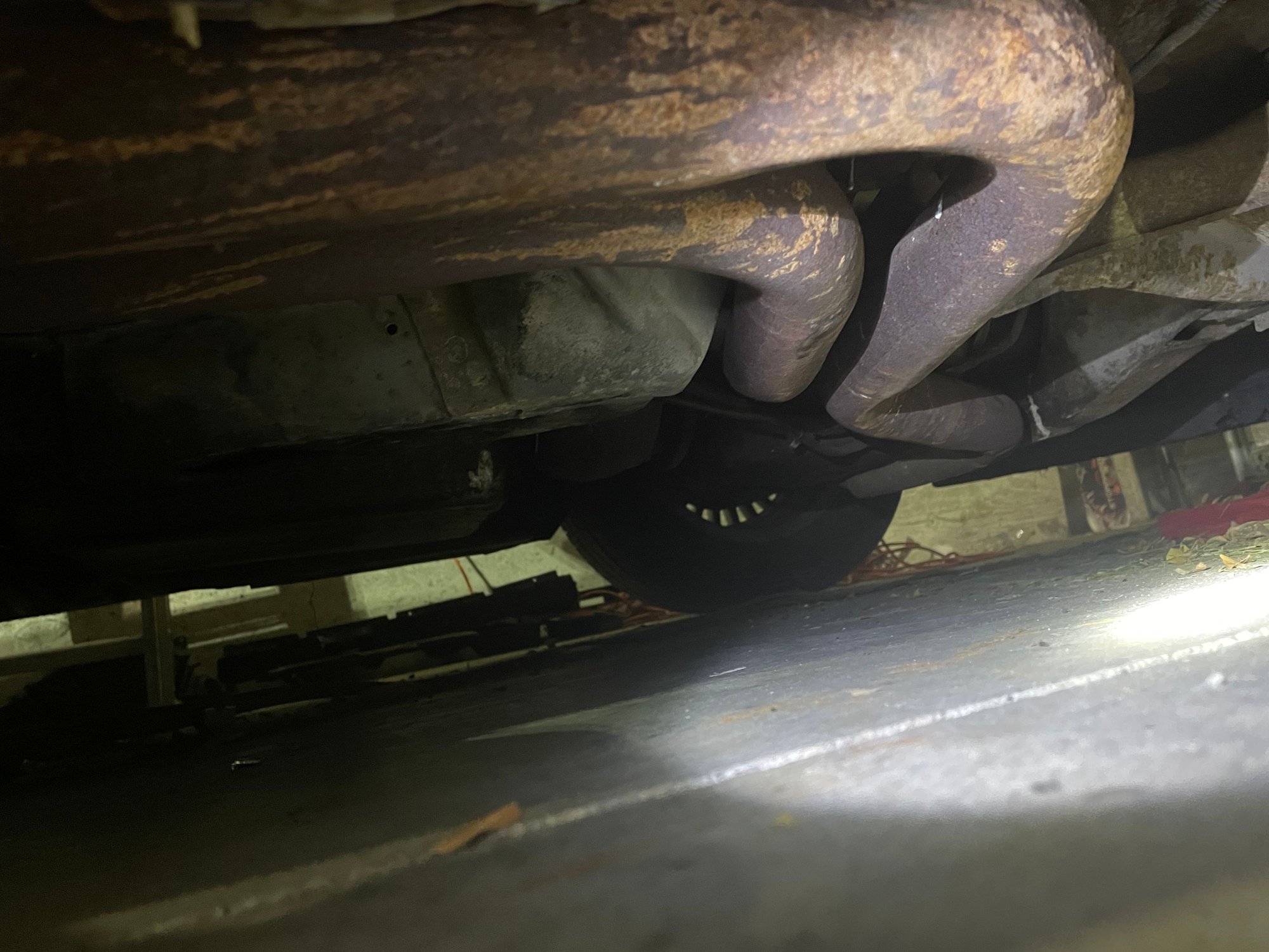

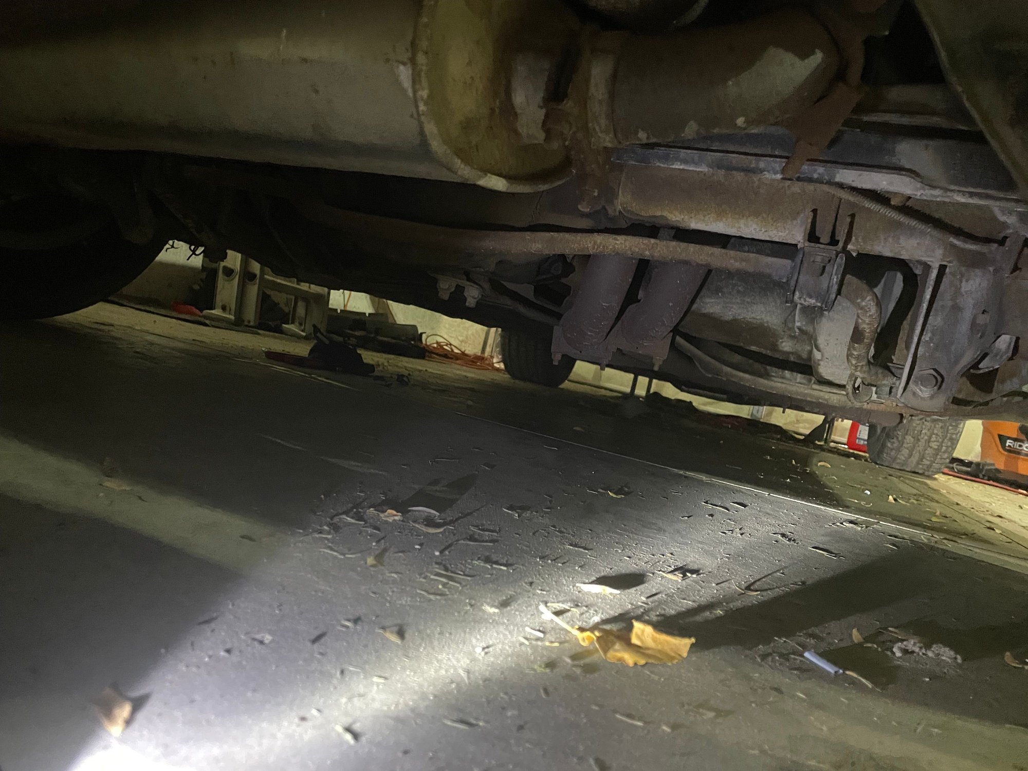

So
Right before the super turbo mufflers
Coming down from behind the rear axle
Back pipe
Back pipe
Sorry a bit tight in here
So, here it is.

So, not long-tubes since the driver's side collector would exit somewhere behind the bell housing thereby rendering the crossover in the stock location under the oil pan impossible, and about 2" or maybe 2¼" pipe...
actually flows worse than an off-the-shelf good-quality single kit.
It's a CONSIDERABLY neater installation than I was expecting, though, except for the 10 lbs or whatever, of U-bolts. Most of the crush bends aren't even too dreadfully brutal.
The car has definitely been sitting around for awhile. Any idea why that is?

Re: What in the world
The photos are not completely revealing, but those that are provided do not show an oxygen sensor screwed into one of the pipes. Then again, that's often on the pilot's side, and the photo showing the insulation on the intake doesn't reveal that angle. That would make operation of the EFI pretty tough.
The photo does seem to show a mechanical fuel pump and inline filter, so the spaghetti pickup in the tank is at least a little more viable (short-term).

Overall, it appears that all the emissions systems have been removed, or at least that what it appears like to me.

I'm with Tom, that car looks pretty savable to me. Of course, he changes induction systems more frequently than I change my underwear and I'll pull a motor in a gravel driveway so maybe we're both crazy.

Wow, that exhaust is much better than I figured.
Id think about what you're up for. Do you wanna take the time to figure out if the crossfire works or do you wanna move on from that system and do something else. I wouldn't rush dropping the tank till you know what direction you go. If you don't need emissions a standalone efi setup is the move and pretty simple. If you want to mess w the crossfire, you need to see if it fires over and then will it run. Who knows, you may be able to stick a fuel pump in and it will run fine. I doubt it but also doubted the quality of the dual exhaust!
