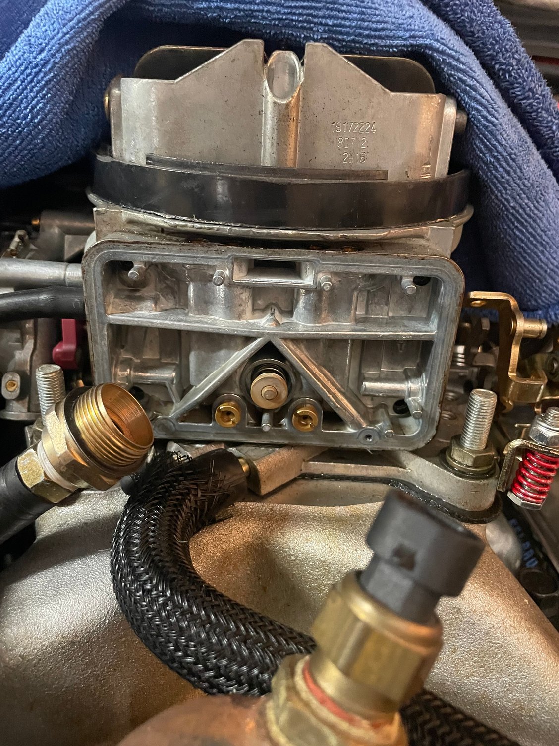

i finally got around and remove my bowl. See the pictures. It is not what I expected to see. I thought I could remove the power valve with a 1 inch wrench but it seems from the picture that it is somewhere inside the body of the carb. Did I miss something or remove the wrong part?
Thanks for any information!

Hmm 🧐 not a carb guy but assume the pv is on the metering block.

The piece that the PV screws into is about 5/8" thick or so. Its official name is "metering block". It's held on by the same 4 screws that hold the fuel bowl on. Just look about that far behind the flange you can now see, and you'll see the parting line where it meets the actual carb body. Right now all that's holding it on is the stickiness of its gasket. Mind you, that gasket is an almost continuous rectangular flat piece, with only a few little holes; it often tears when removing it. Holley puts some kind of adhesive on it for some reason, although those blue gaskets don't have that, so it might cooperate. I always schmeeer a good bit of silicone dielectric grease on those so they come back apart without a fight. Also be aware, all of those parts have a REAL FINE ridge cast into them for sealing, which you can see the witness mark of, in the gasket that's now exposed; be SOOOOOOOOOOOOPER careful not to damage that ridge while scraping gasket remnants off of things.

Thank you! Yes you are exactly right. It came off with a little force. I was able to see the power valve and replace with a 10.5.

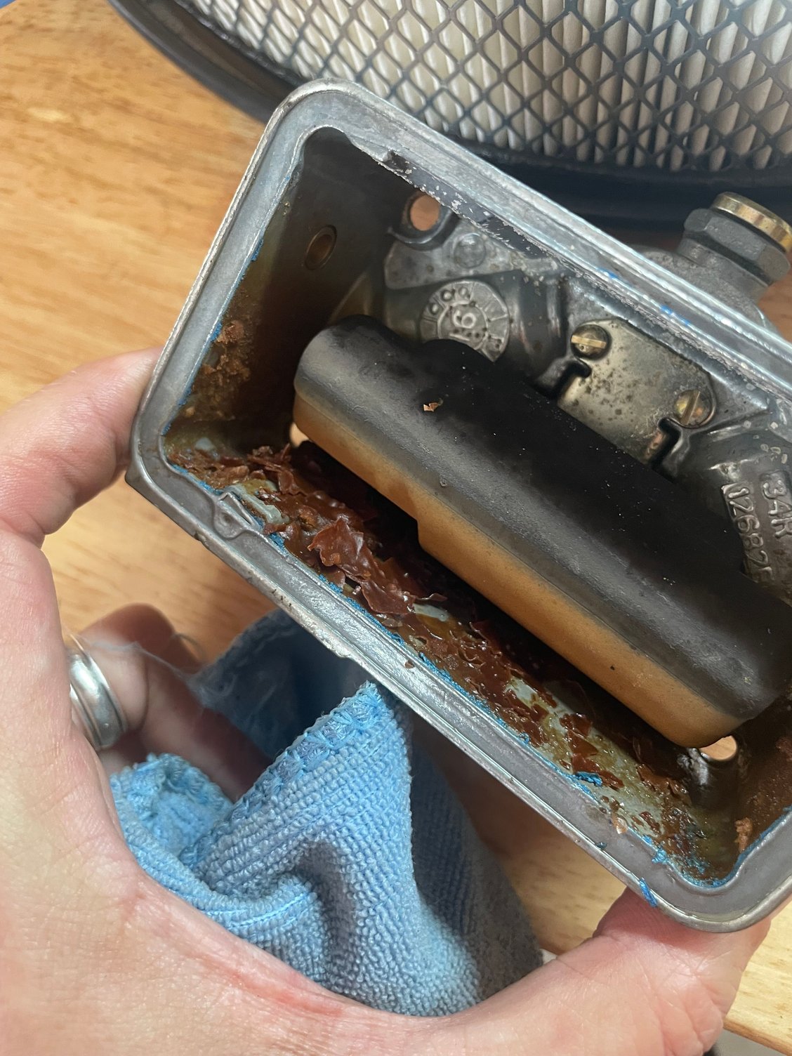

I am back…so I replaced the power valve to 10.5. I removed the secondary bowl to tune and saw this. See picture. Could some one tell me what is the crude?

EEEEeeeeeeeeeewwwwwwwwwwww... [/ 5th grade girl]
There's a technical term for that. Used only in the most enlightened educated erudite circles of accredited technician majesty.
It's called "crud". Maybe some other 4-letter words as well. NOT good news.
Actually, it's also known as "varnish". Happens from fuel sitting around too long mostly. If it's THERE, no telling where else it might be, upstream from there. Not a good sign AT ALL.
If we'd had any inkling you were dealing with THAT, we wouldn't even have started talking about tuning yet. NO WAY you can "tune" a carb when it's full of THAT.
First thing ya gotta do is tear down that carb to its most intimately tiny parts, and get all of that OUT OF everything. Every passage, every orifice, every EVERYTHING, likely has that ... STUFF ... (sorry, I was going for another word that starts with "s") stuck in it. No possible way for it to work right like that. Once fully torn down, soak it in lacquer thinner for acoupla days, then brush everything you can get to, and stick a SOFT wire or something into every hole a brush won't get into. Copper wire (4-pr telephone station wire), thin fishing line, stuff like that. NOT steel, like tag wire or that sort of thing; it can damage the holes. Blow it out with spray-can carb/TB cleaner (NOT brake parts cleaner) followed by compressed air. Reassemble with all new gaskets and a NEW fuel filter. Doesn't matter if you just replaced it yesterday; replace it NOW.
If the rest of your fuel system (pickup in the tank, sock filter protecting it, lines, pump, ...) looks like that, you're in for a rough ride for awhile.

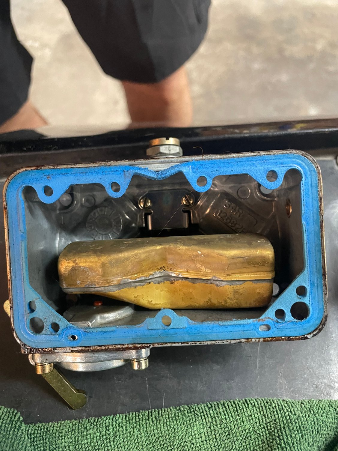

Thanks for sofa! I will do that. Interestingly I checked the primary bowl and it is totally. So I am not sure that I don't drive my car long distances at all so the fuel sits in the secondary way too long. Either way the carb is due for your recipe of cleaning. Here is pucture of the primary.
