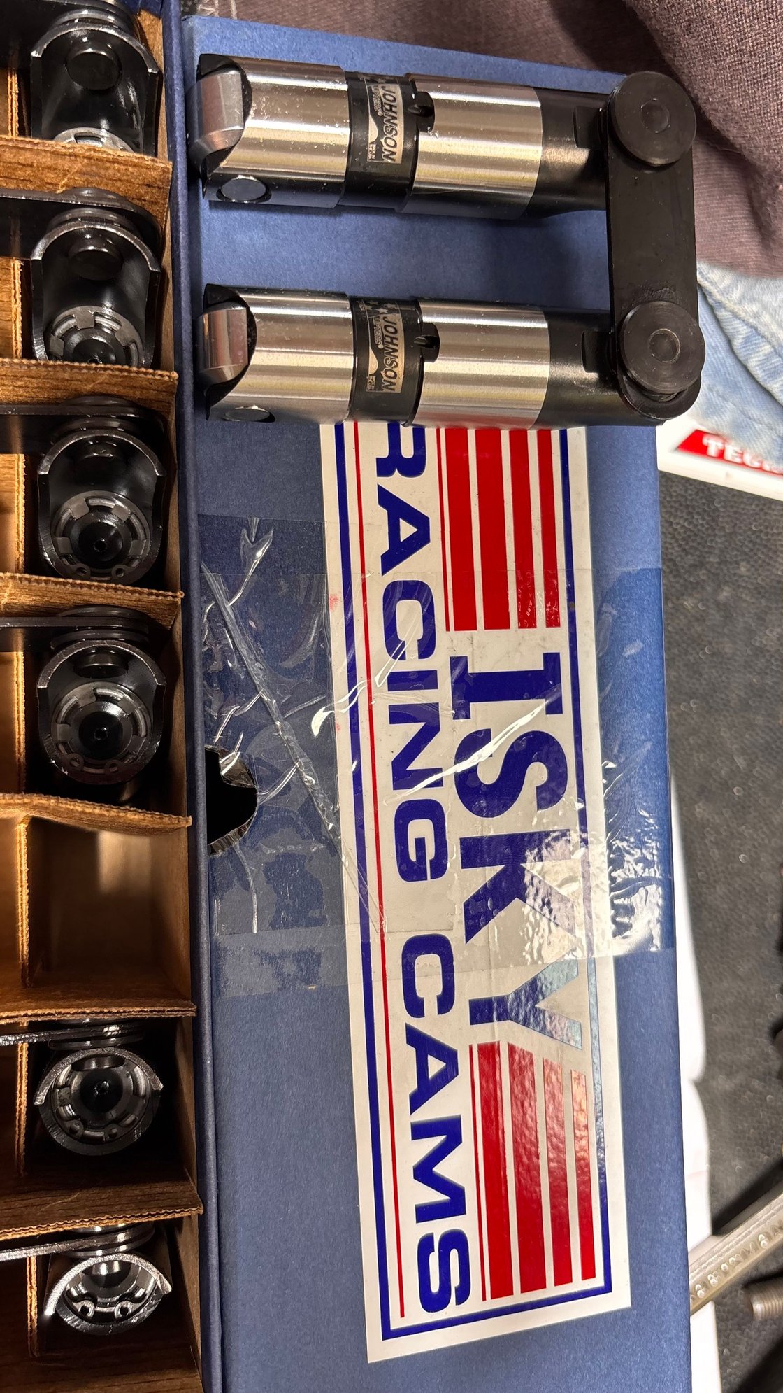

Dependent on what Johnson gets back to me with I’m now looking at the 2116SBR (small block OE roller, vertical link bar). Isky has the same lifter with their name on the box for $20 cheaper and Summit stocks the Isky part so I’ll have their customer service and rapid shipping as a bonus. In the end, since I’ll have to buy a new spider, if I get the 2110R, the price difference between the 2 would only be around $50.

I haven’t intended to let this thread die but everything is just moving slowly. Johnson hasn’t answered my questions so I went ahead with the Isky 2077HYRT link bar lifters. In the past they were Johnson 2116SBR’s (essentially the 2110R in a tall body w/ link bar), I’ll find out tomorrow if they still are. Without Johnson responding to whether or not the 2110R’s are a long travel design and a minimal price difference once everything is accounted for, I played it safe and went with a link bar design.

Isky still selling the Johnson lifters
Isky still selling the Johnson lifters and you can source them through Summit unlike the Johnson branded ones.

You’ll be fine with those. Interesting how iskys says good to 7500 as a limit. Those kinda things i always thought were too dependent on variables to draw a hard line and perhaps they just did a general guideline… cam lobe, valvetrain weights and stiffness, spring loads and oil type and clearances all have influence on rpm limit. Factory ls gms have spun that high and more, just gotta keep things light weight
