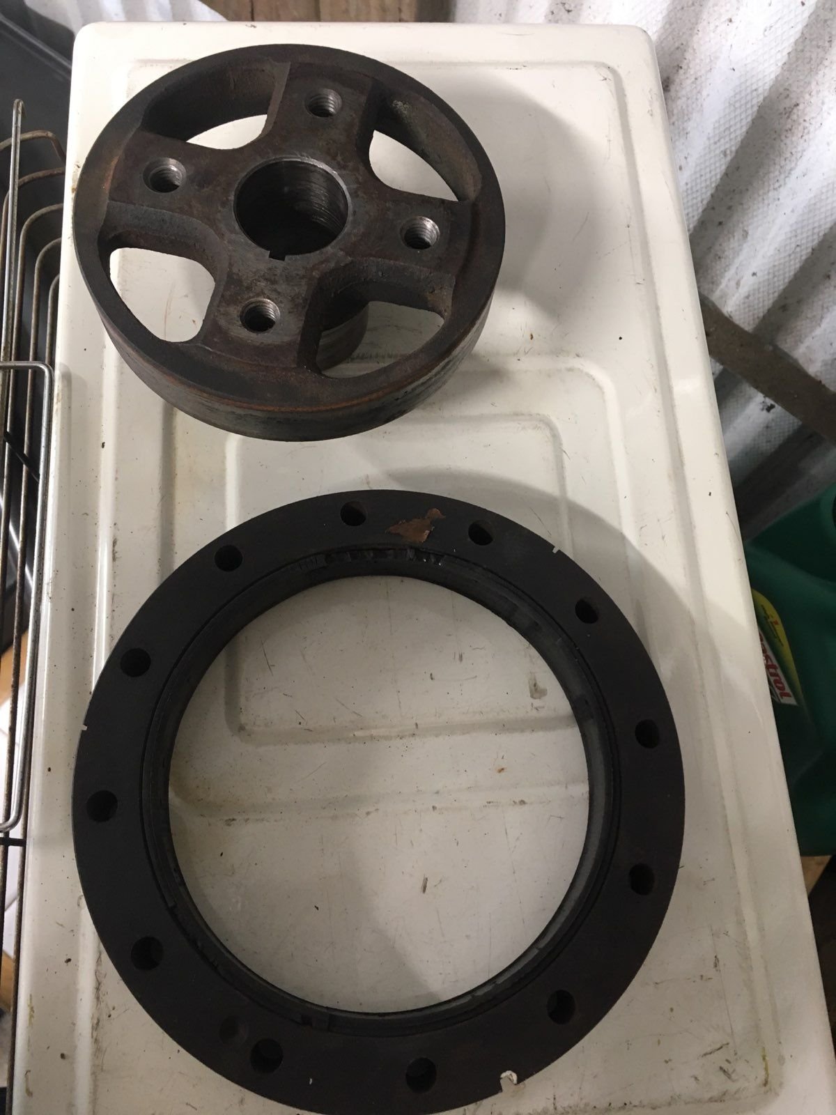

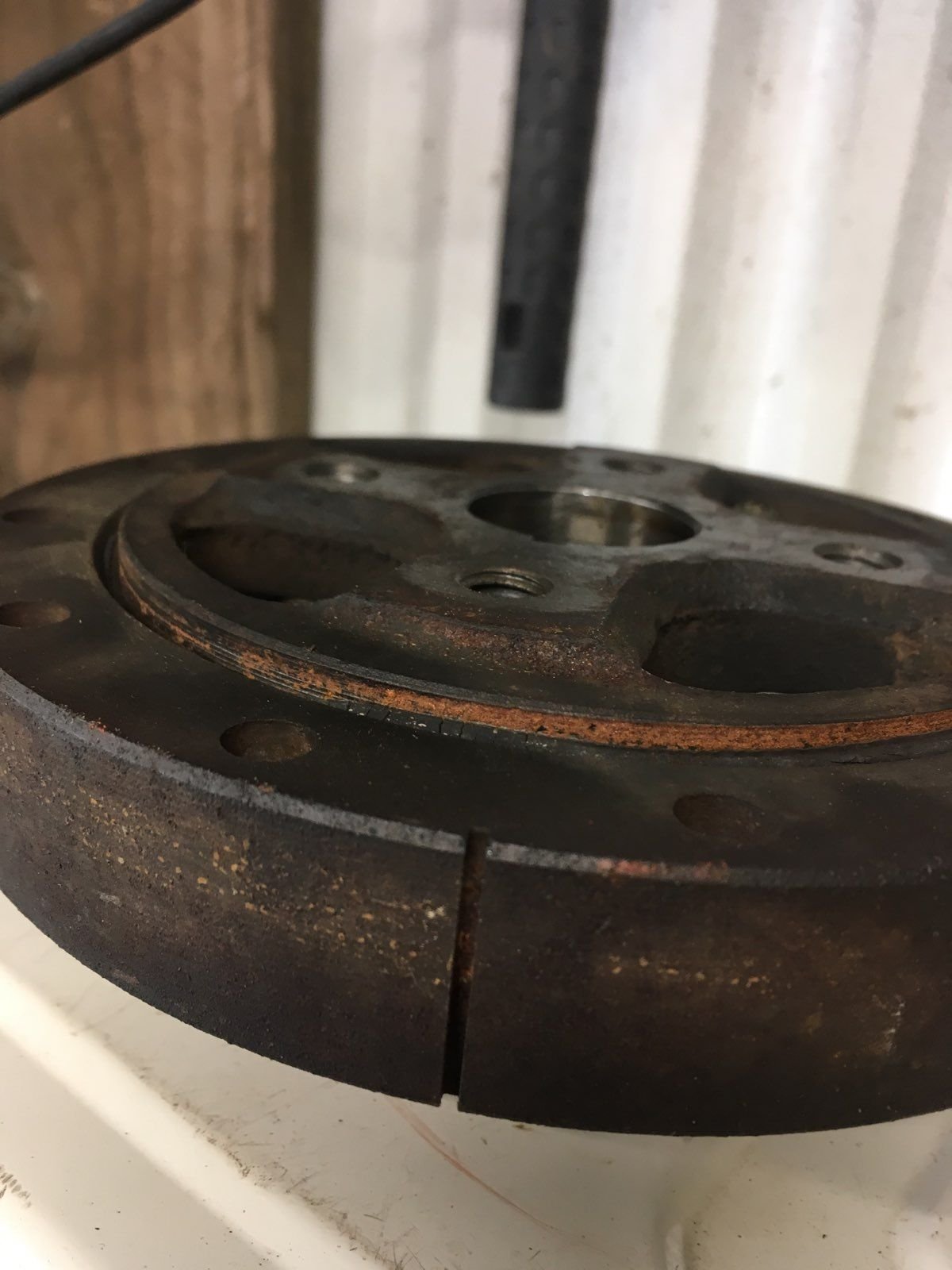

I have an 86 Firebird with the 2.8l with manual trans, have a really harsh vibration the whole body shakes and rattles really bad starting at 2200rpms and up but goes away around 5500, does not matter if vehicle is under load, on decel, clutch in or out. Tried power braking to check motor mounts and they don't have a lot of flex. Recently bought vehicle that was sitting in a barn for 7+ years, had to replace entire ign system and clutch to get vehicle going again. any ideas on what may be causing the shake?

Yes, It could be a flywheel issue.... Or, have you checked to see if the harmonic damper has slipped?
You mention the issue as happening before you replaced the clutch/flywheel but to a lesser degree. You mention regularly hitting 5500 RPM with it. The HD may have been beginning to slip before, and then your later excursions into ludicrous speed may have finally, completely done it in.
When good Harmonic Dampers go bad....
Okay i will look at it, do not normally hit those higher rpms, was driving the vehicle multiple different ways and conditions to see if the issue worsens or improves under certain load ranges ect. I appreciate the ideas.
