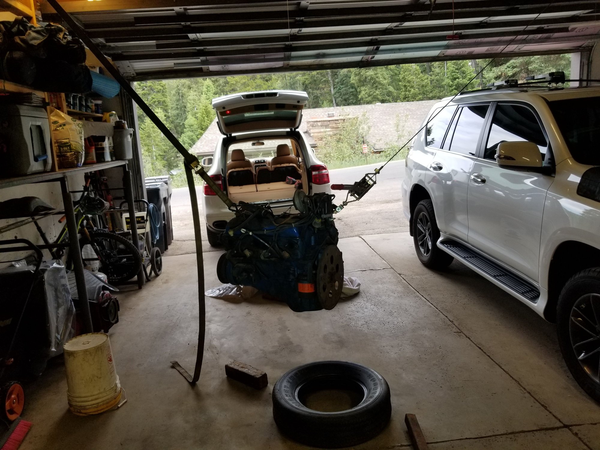

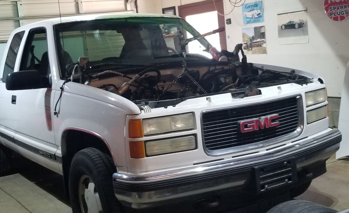

Appreciate the advice and cam suggestion....I ended up not doing this. I don't like that truck (in case you couldn't tell! ), and I found a clean, 70k mile 5.7/5 speed, truck that I think that I WILL like, and bought that, and that will be the truck that I care about.
For the Grandpa truck, I went the cheapest route I could find, to make it sellable; a $500.00 Vortec 350 from someone's back yard.

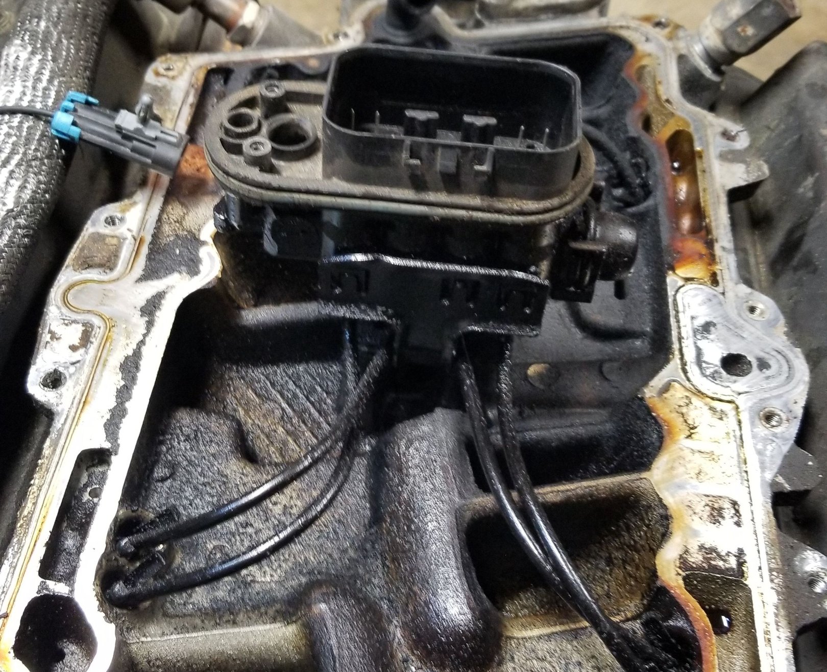

One "bonus" is that the turd L30 did have the updated injectors in it....so those went onto the 350. The 350 had the older poppet style injectors in it, still. Problems.
Safety first! I can't believe these crap ching-chong-china come-alongs are rated at 4k lbs. NFW....thing seems questionable at 550 lbs.
That engine is installed and running now (drove it to work today). A surprise from this swap (for me) was how decent the drivability is with 45 more cubes, more head, with zero tuning at all. Bolt in and drive it. Especially w/the 5 speed, I thought it might feel surge-y, or laggy, but it actually runs pretty good. Definitely more tq'y and pulls the mountains here way better than turd-ville L30 did. Good enough that if it didn't have crank windows (combined with a fancy OH console and center console)...if it didn't have a 12 bolt.....if it had 3.73 gears instead of 3.55's or something dumb like that...if it wasn't wrecked with retarded options, I might actually want to keep it. But I don't, so it'll be going down the road w/it's 500 buck, 350.
