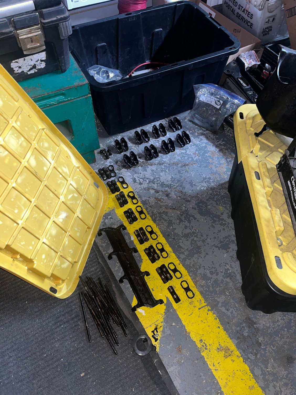

For what it’s worth I run a no bypass oil filter adapter with the non bypass wix filter specifically for this reason in case if there ever was a cam failure the metal shavings would be caught by the filter before it could circulate into the bottom end.
I was reminiscing today at work and now I’m pretty sure I actually can pinpoint when the failure happened. It was probably right after I got the car on the road more than a year ago, I was doing a test run on an abandoned stretch of road near an old airport to see what my 0-60 was and I remember coming to a stop and it sounded like the engine was knocking, I shut it off and let it sit for a minute, turned it back on and the knock slowly went away, probably the lifter taking the slack after the lobe ate itself… oh well
found the roller top end stuff from my donor 305, a good cleaning and I’m off the races (one of the lifters are missing in the photo because it’s on my desk)
