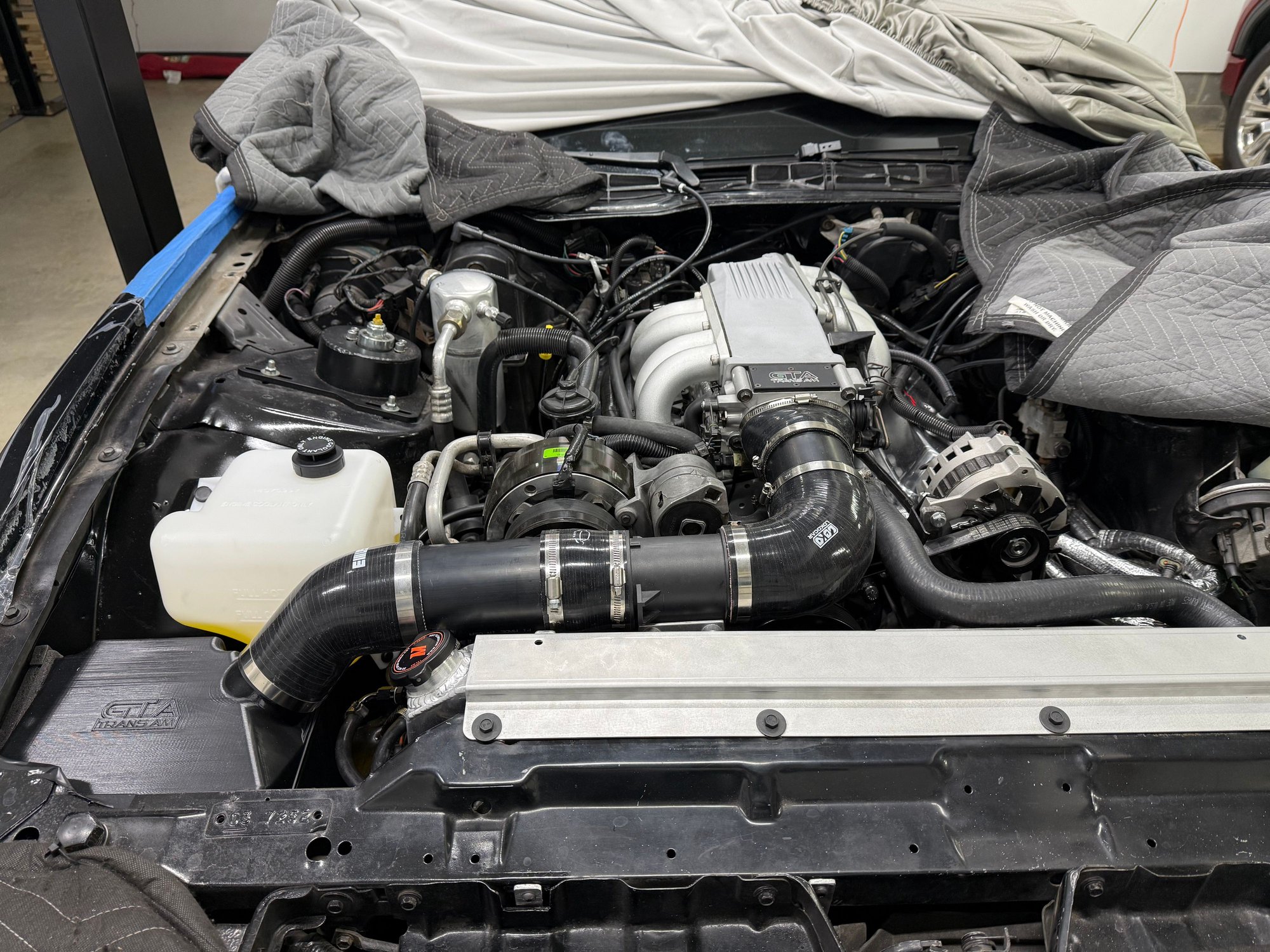

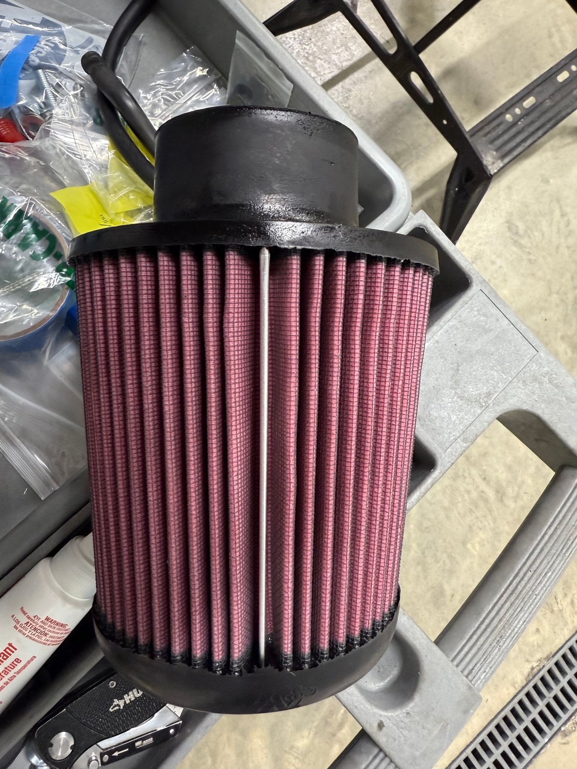

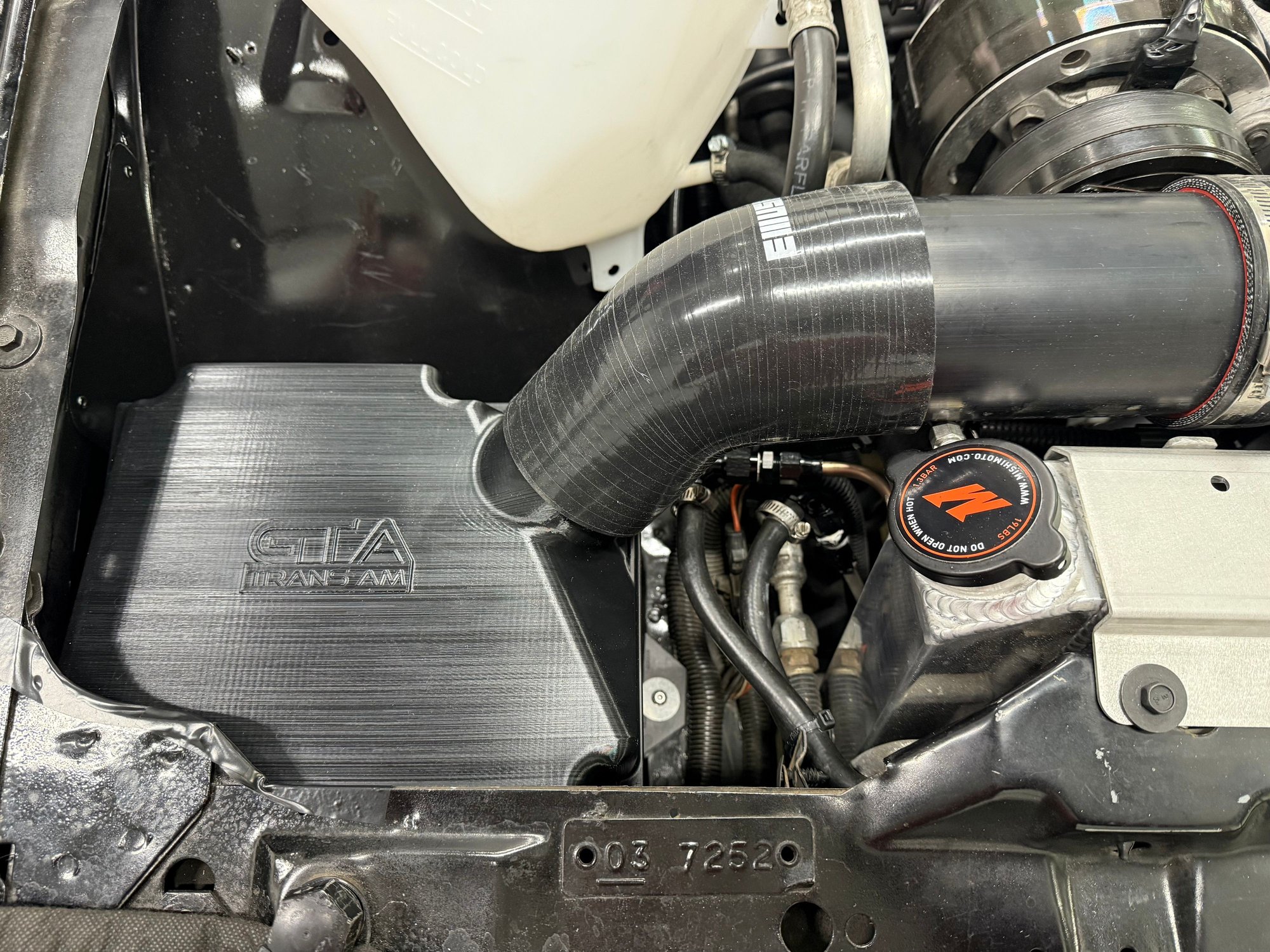

Not to go off topic, but who/where did your 3d printed intake? Got a pic of it? Thank you sir!

My brother and I designed and he printed it on his printer.
That looks really good! Nice job
This looks great! You should sell them.
