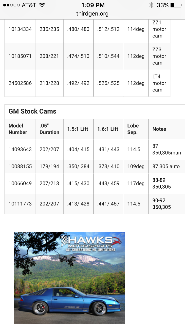

I picked this up here on the forum some years back.

Great info fellas! Thank you. And the chart helped a lot. It looks like my data was correct. I'm getting ready to burn a new EPROM and I needed that.
