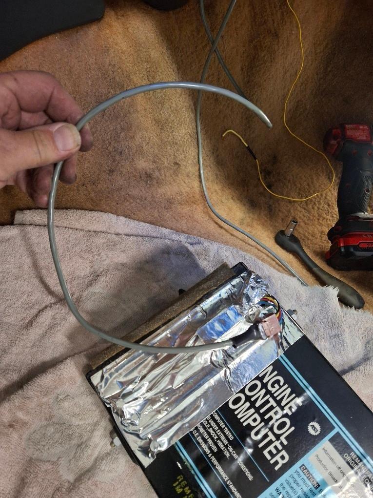

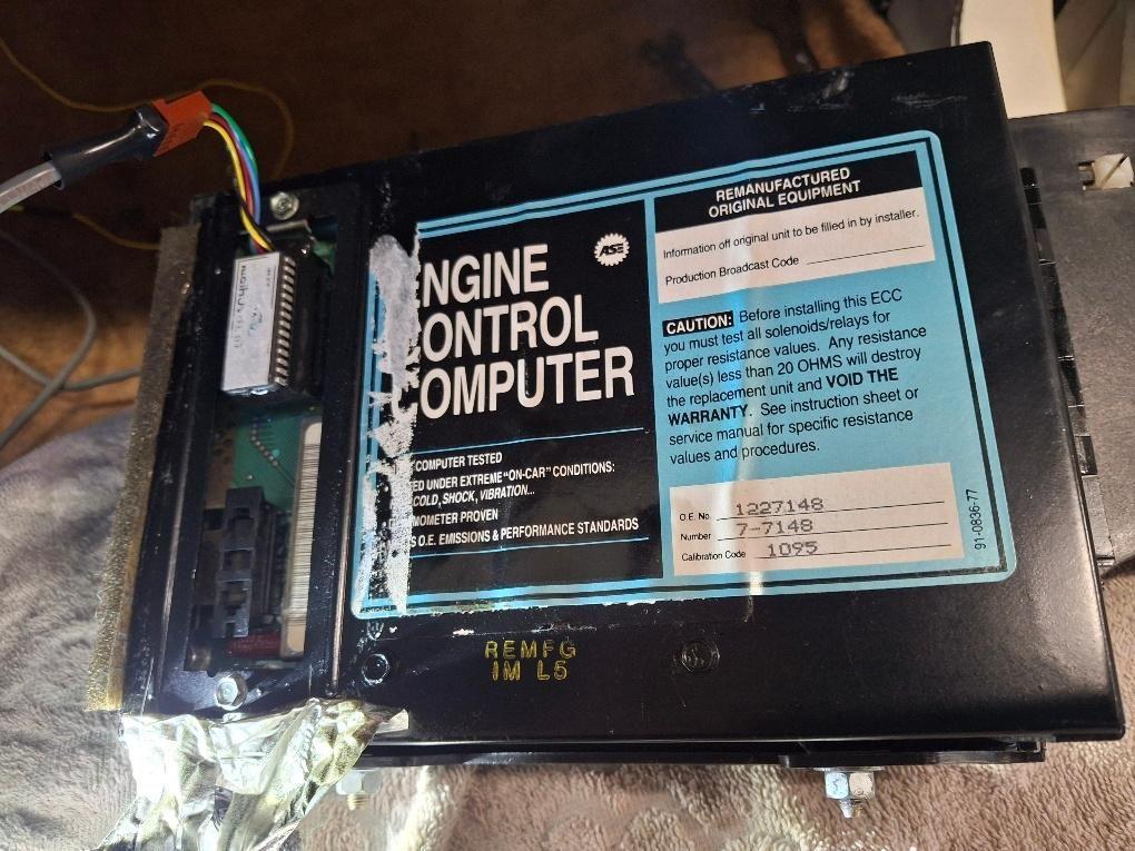

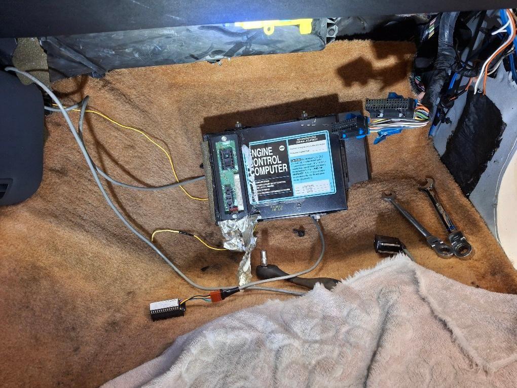

I just purchased a TTA and have had it less than a week. The car was a one owner from out west and it has been sitting for the last 15 years until being sold. He did not leave the car original as you can see from these few pictures. He appears to have modified a number of things as seen in the pictures I have attached. In the pictures you will see the set up at the ECU and the chip from it which is impossible to read because the white label is not legible. There is the grey wire that runs under the radio area to the chip and I have not yet traced it to it's source.
Thank you for your time.

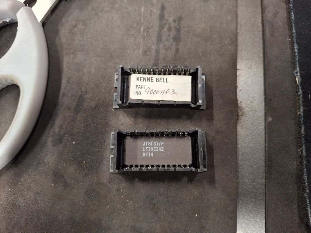

The other two chips shown I found in the car. Under the hood are what looks to be a prior alky set up as the nozzle is blocked off and the line no longer attached to a pump but to the windshield washer container area. The turbo was supposedly upgraded. All I know as of now is it is a Garrett, size unknown. The car barely runs, has been leaking fluids for years prior to parking it by the looks under the car.
What I am asking for help on is what kind of set up is this for those who have experience with a TTA? I am familiar with a GN and its engine as I have owned once since 1987. I have never seen anything like what has been done to this vehicle. One of my first objectives is to find out what has been done, what components have been installed and what needs to be done to get the engine running and hopefully not having to replace it. The car has 76,000 miles on it. Appreciate any assistance anyone can provide before I really get into this one

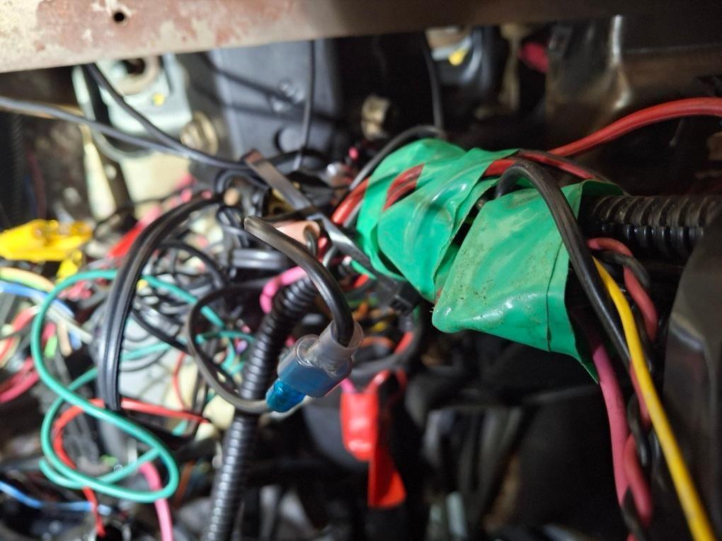

Welcome to the forums! Plenty of helpful information. Never had a GN nor turbo car! If it was mine? I would go buy a factory service manual first before doing anything and familiarize myself with the trouble shooting steps. Then I would "re-engineer" whatever the POS did to that poor car. Not to say that I am a period correct guy, nor dislike modifications. But looking at the rats' nest of a mess makes my skin crawl. After obtaining the FSM, I would remove all that "stuff" carefully and then attempt to get the car running. Sorry I can't be more helpful. Good luck with the resurrection.

Thank you for the message. Where is the best place to purchase the FSM? This car did not come with an owners manual or any documentation other than the original bill of sale, window sticker and that is about it. Glad to have the car but wish it had more that came with it. No question I have a rat's nest on my hands. It had alky on it at one time, I found the ecu has a gray wire running directly to the chip. It starts and runs but barely. I would not want to have to drive it to work if I had to. Gonna be a fun, winter project. Just debating where to start when it comes to under the hood. I have already started work on the seats, carpet, door panels and trunk area since I know what to do there. I am just being cautious before I do too much under the dash and under the hood. We are doing to need a lot of parts so open to those who have new and/or used parts for sale. List as of now are rear hatch struts/shocks, carpet, ashtray cover, map/reading light between t tops cover, perhaps an ECU, T Top black strip that is attached to the t tops (not the body), black trim piece that sits under the front, driver's headlight when down so you cannot see into the cavity, the panels that go under the driver and passenger dash are missing, seat belts, seat belt plastic trim and this is just a start. If anyone has these parts for sale please let me know or if you know of any vendors let me know. Hawks Motorsports is the only place I have reached out to thus for for inventory and pricing and I should hear back by next week from them. Thank you.

After you have the FSM, you're going to have to go through all that wiring hackery(!) one circuit at a time, restoring everything back to original condition. When that's done, get the engine mechanicals squared away, and then see where you're at. This is your only option; the only person who might have been able to decipher that mess can no longer help.
