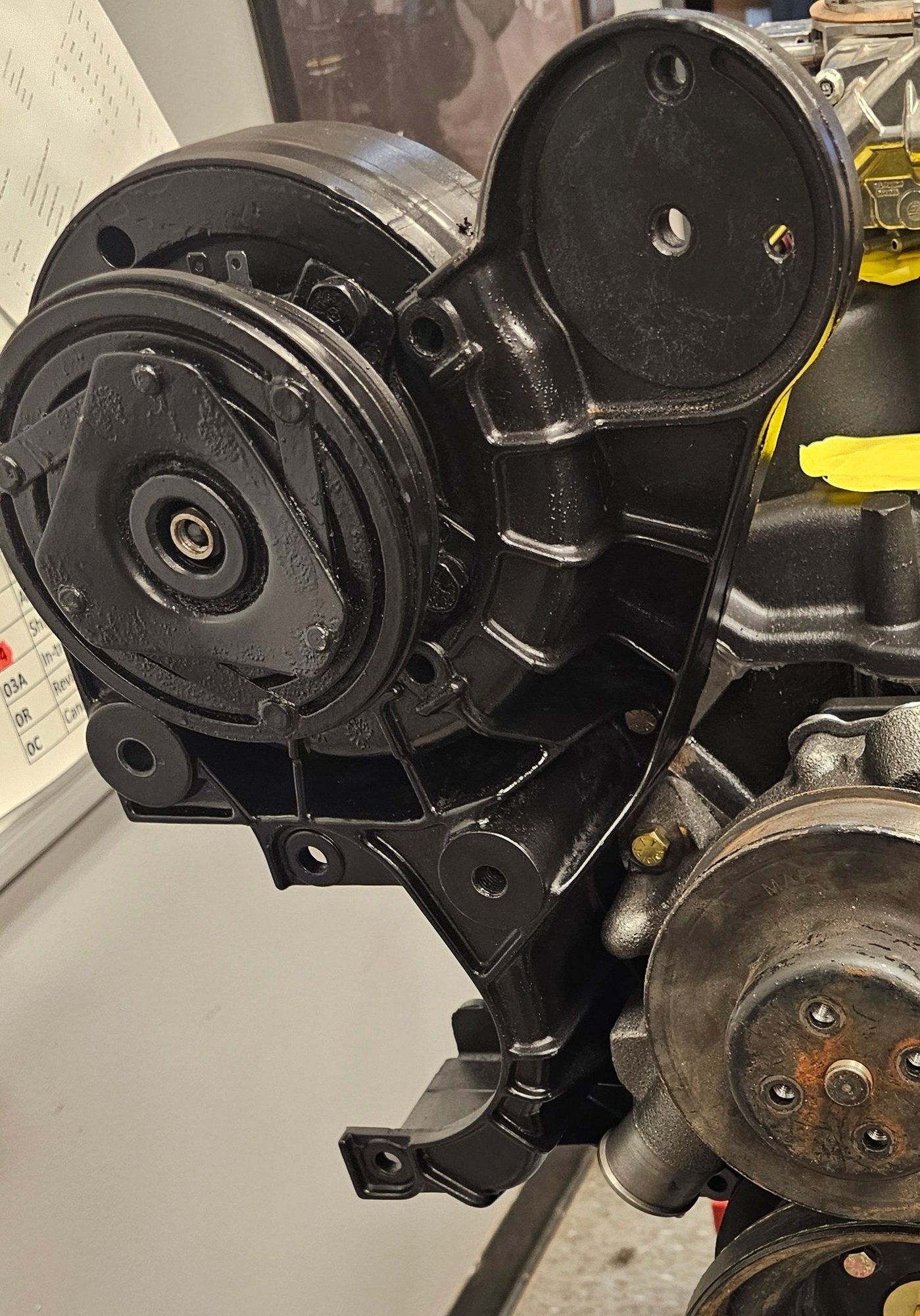

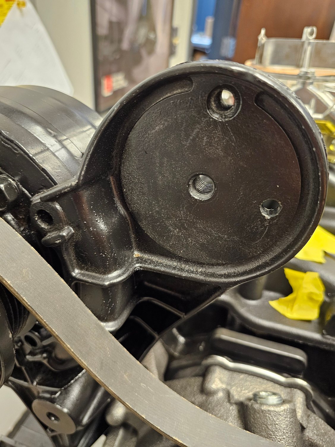

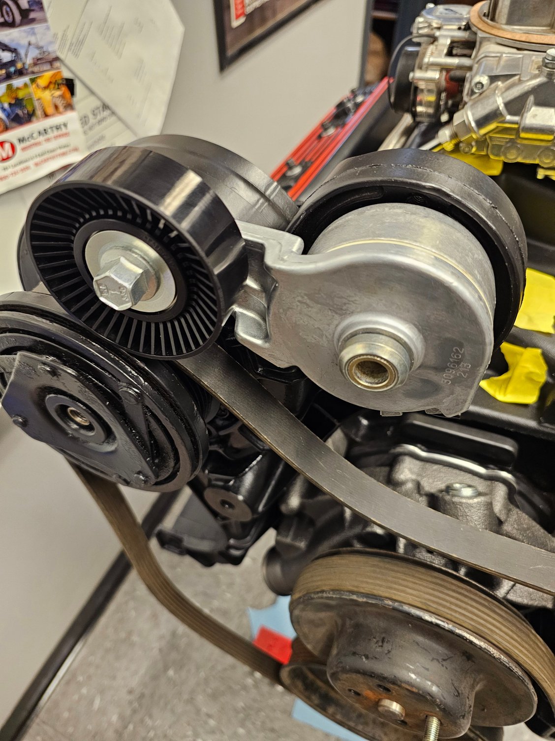

Rockauto calls for a dayco 89213 for 88-92 Camaro. My brackets are from a 3rd gen trans am. The guide whole on my brackets seems to be on the opposite side to match this tensioner. Am I missing something easy here ?
Drill another guide hole in opposite side for an easy fix?

Looks like you have truck brackets. Camaro/firebird use the same brackets, truck and corvette are both different.

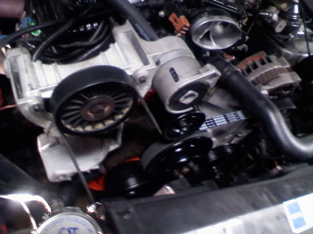

This is the style of belt tensioner the F-bodys came with.

Brackets are from a 3rd gen trans am not a truck

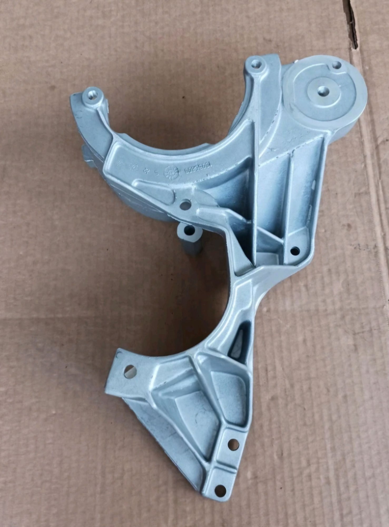

I should say I was "told" they were from an 88 trans am. Found this pic on forum. Super hard to tell if mine are different than what the f body brackets should be

truck

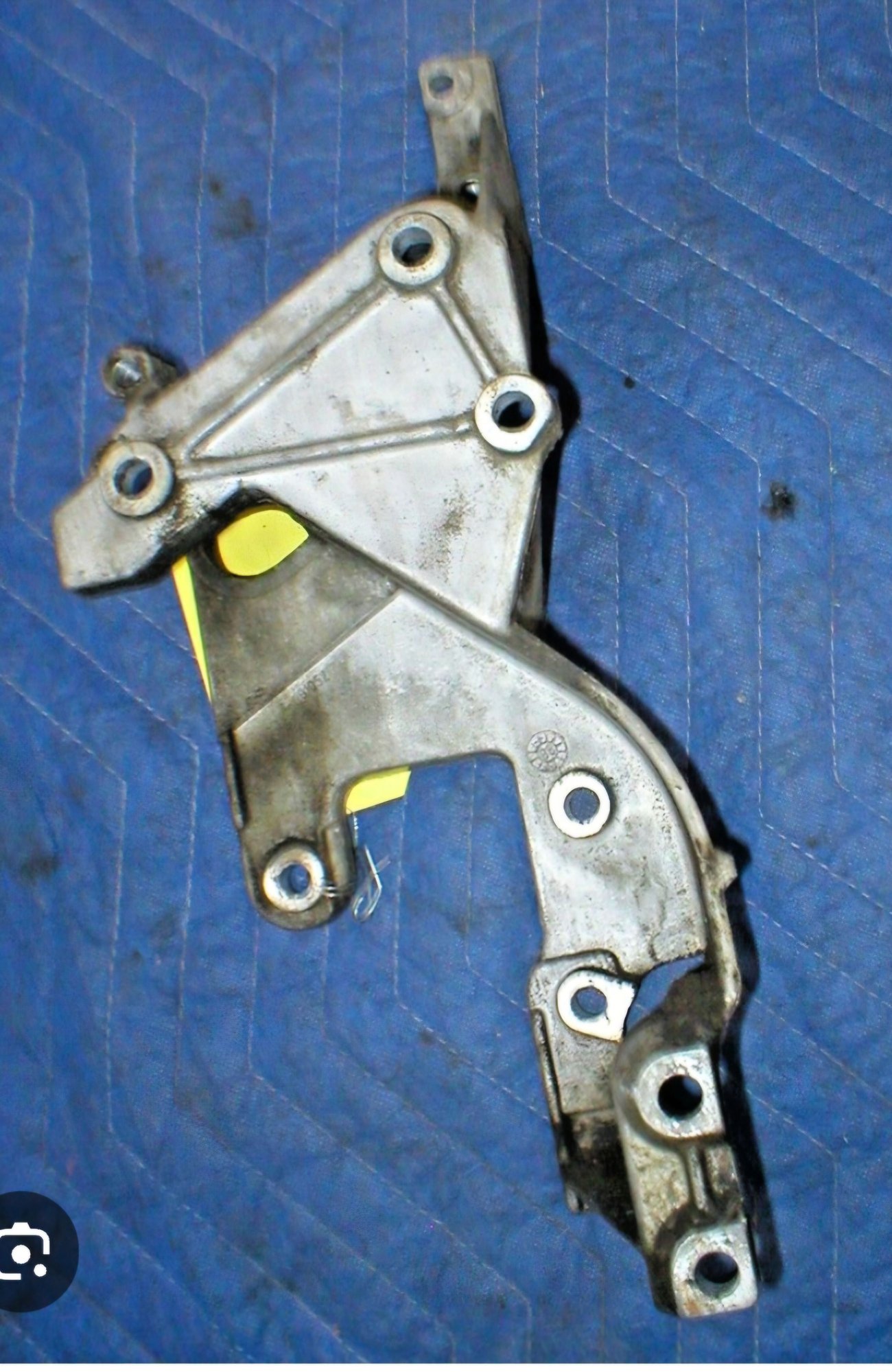

Do these look correct ??
Yes, looks correct. Keep in mind, the waterpump, crank (ps?) pulleys have to match the brackets as well
