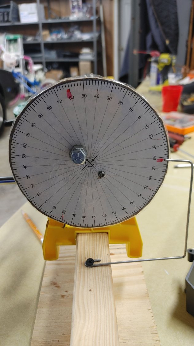

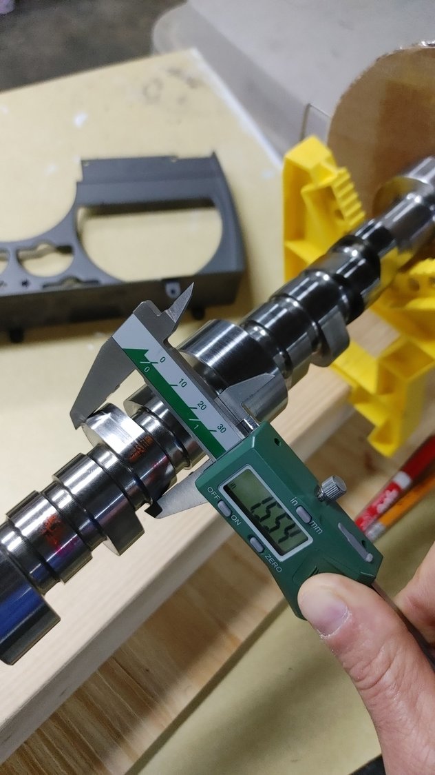

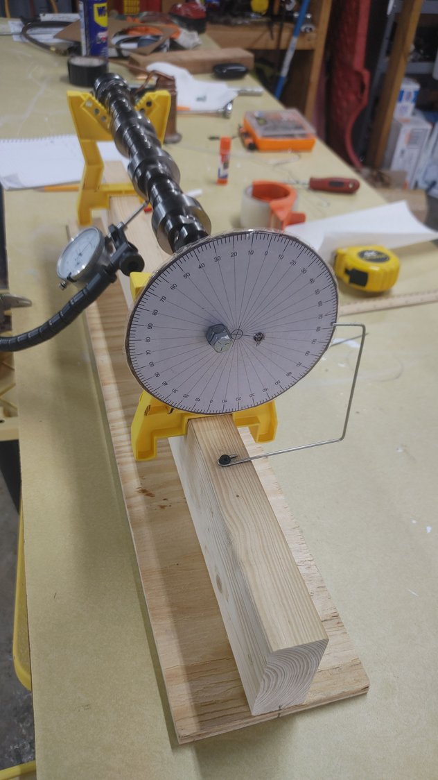

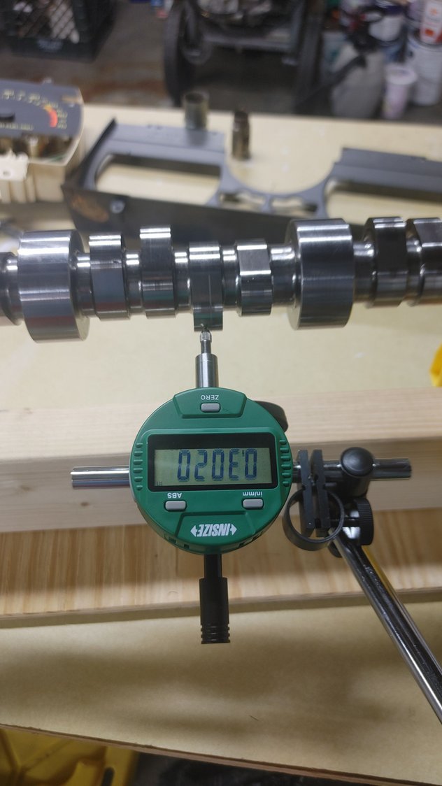

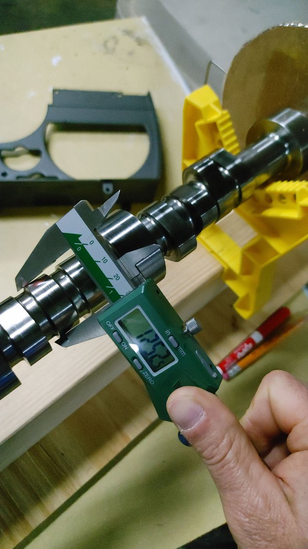

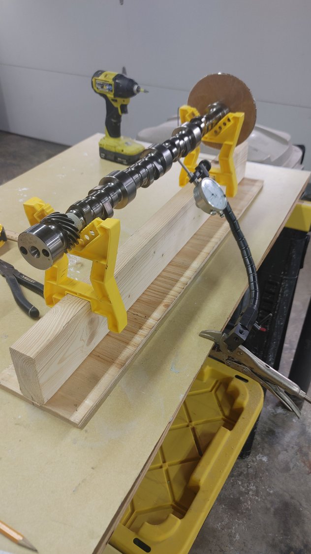

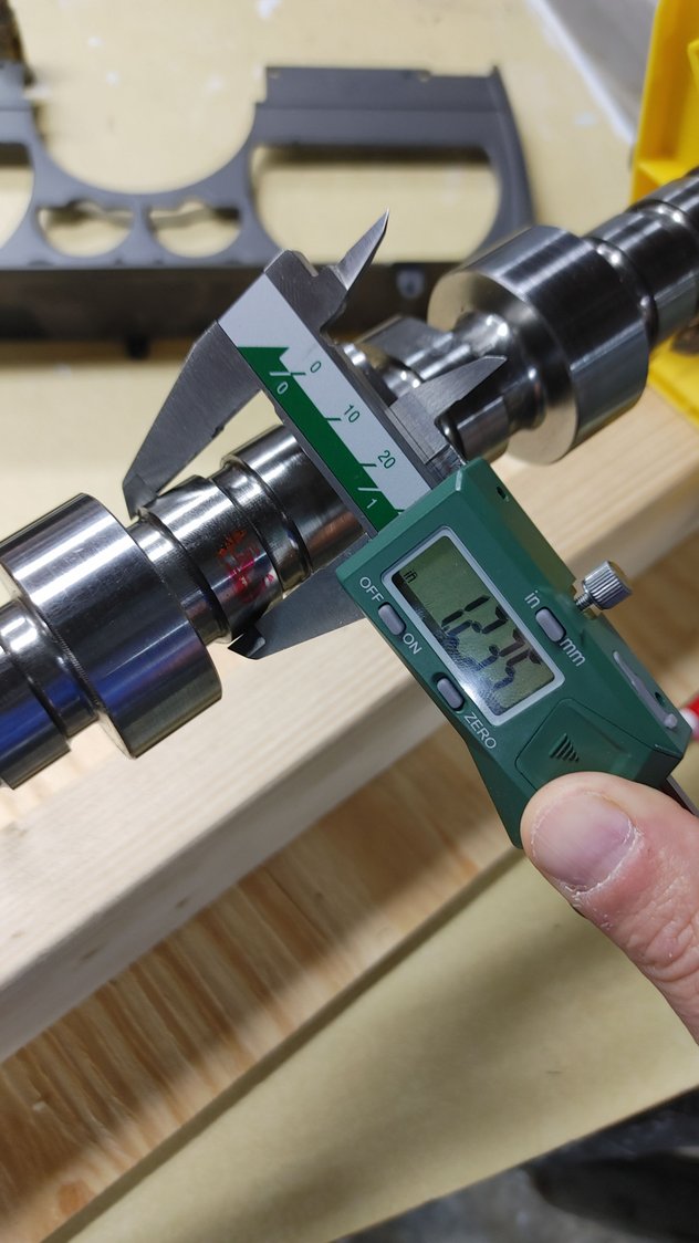

My Readings taking measurements from camshaft Cylinder 3 int/exh & Cylinder 4 int/exh back from the front of the camshaft as follows:
Front of camshaft position in order- 1e, 2e, 1i, 2i, 3i, 4i, 3e, 4e, 5e, 6e, 5i, 6i, 7i, 8i, 7e, 8e,
Cyl. 3 Intake duration 94 deg cam x2 crank = 188 degrees, .304 lift x1.5 rocker ratio = .456
Cyl. 3 Exhaust duration 99 deg cam x2 crank = 198 degrees, .314 lift x1.5 rocker ratio = .471
Cyl. 4 Intake duration 94 deg cam x2 crank = 188 degrees, .305 lift x1.5 rocker ratio = .457
Cyl. 4 Exhaust duration 99 deg cam x2 crank = 1198 degrees, .313 lift x1.5 rocker ratio = .469
Cyl. 4 ICLexh. - ICLint. = 110 deg (however I believe this measurement to be wholly unreliable with my instrumentation, could be 112 degrees also)
There is a lot of indication that my 6492 camshaft could be an OEM Mercruiser marine camshaft 431-866022T takeout. Any thoughts on what I have and the numbers listed above? Could it be another GM takeout grind perhaps? Could I expect this camshaft to provide any better performance in an otherwise stock 92 L98 engine with 083 heads and standard TPI intake, assuming a spring upgrade? 92 L98 cam specs I believe are GM#10111773, 202/207 .413/.428 114.5, 90-92 350,305

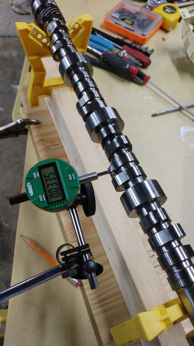

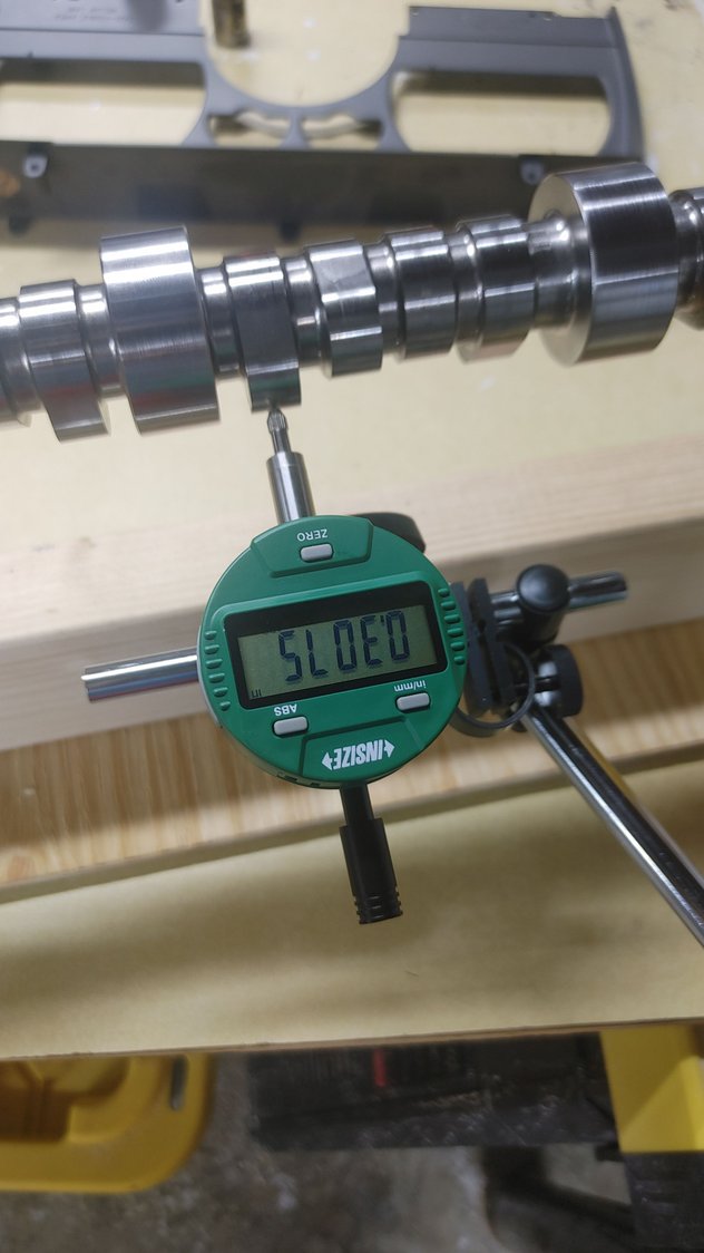

Wanted to update that new information since original post leads me to believe I was mistakenly measuring the bare cam for lift at .050 when in fact it needs to be measured at .0333 when the cam is on the bench rather than in the block. At this new measurement my duration is roughly 208/216 and this checks out with what many have indicated is close to the Howard's mentioned above.

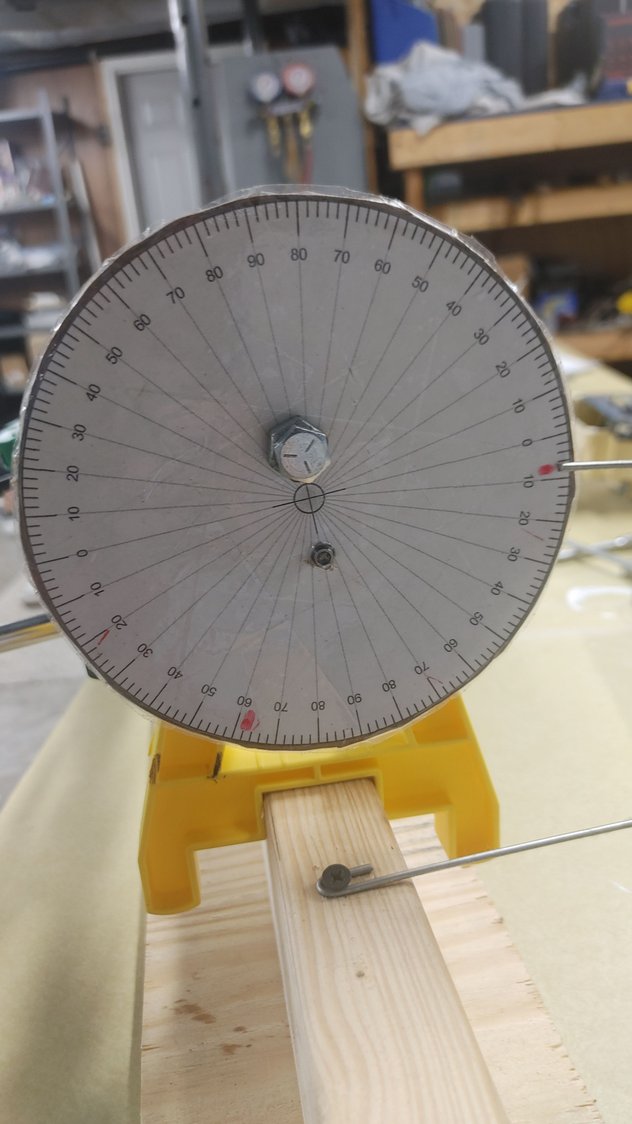

Here is with another set of instruments. I'm still not confident on the LSA, but keep coming up with 110 or 111. Could it really be that a stock GM cam has such a tight LSA? Assuming this is an OEM marine takeout application.

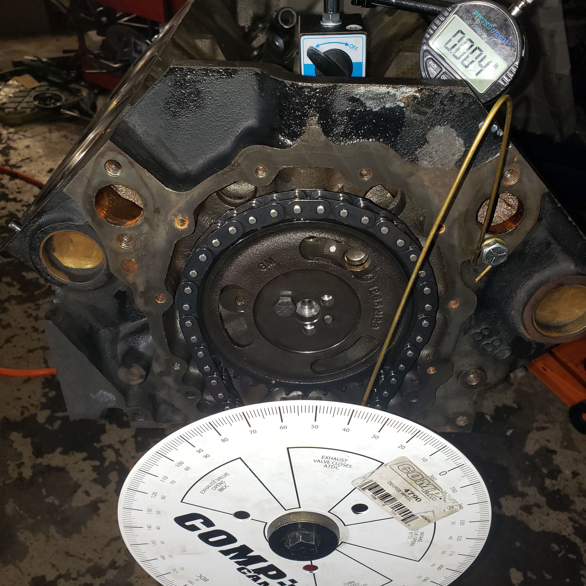

In the engine block I measured 111 ICL and 120 ECL on my later 6492 cam purchased from GM in like 2017. This was with my dial indicator directly on the lifter body with the heads off. Lift measurements are lobe lift. Mine idles with 20 in/hg vacuum at 625 rpm in the 350 it is in with 1.6 rockers on it so I feel the 115.5 LSA is correct atleast for my cam. I have idled it down as low as 450 rpm and it was still making 17.5 in/hg idle vacuum and still running smoothly. It is very smooth running at low rpm because marine engines rely on very low idle speed to engage the dog clutches to go into gear however it does have a bit of an exhaust note to it from the larger exhaust lobe similar to the ZZ4 208/221 cams.
269/295 @ 0.004
258/282 @ 0.006
200/216 @ 0.050
171/185 @ 0.100
149/155 @ 0.150
118/130 @ 0.200
82/96 @ 0.250
18/38 @ 0.300
0.3015/0.310 lobe lift
111 ICL and 120 ECL
I had the crank, #1 rod and piston without the rings and the cam with the factory Vortec single roller chain when I measured mine. I first verified exactly where TDC was with the piston then moved to the cam.
