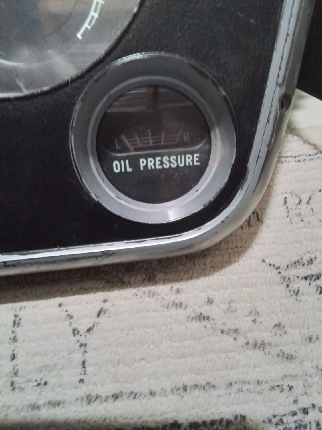

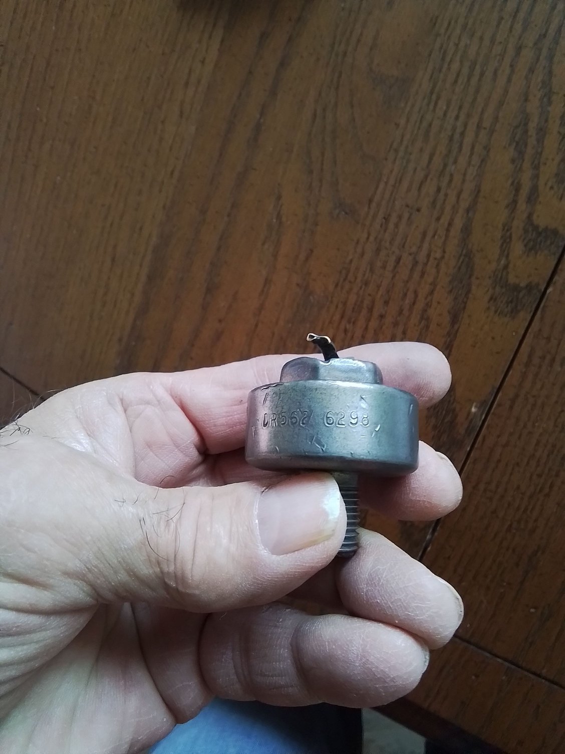

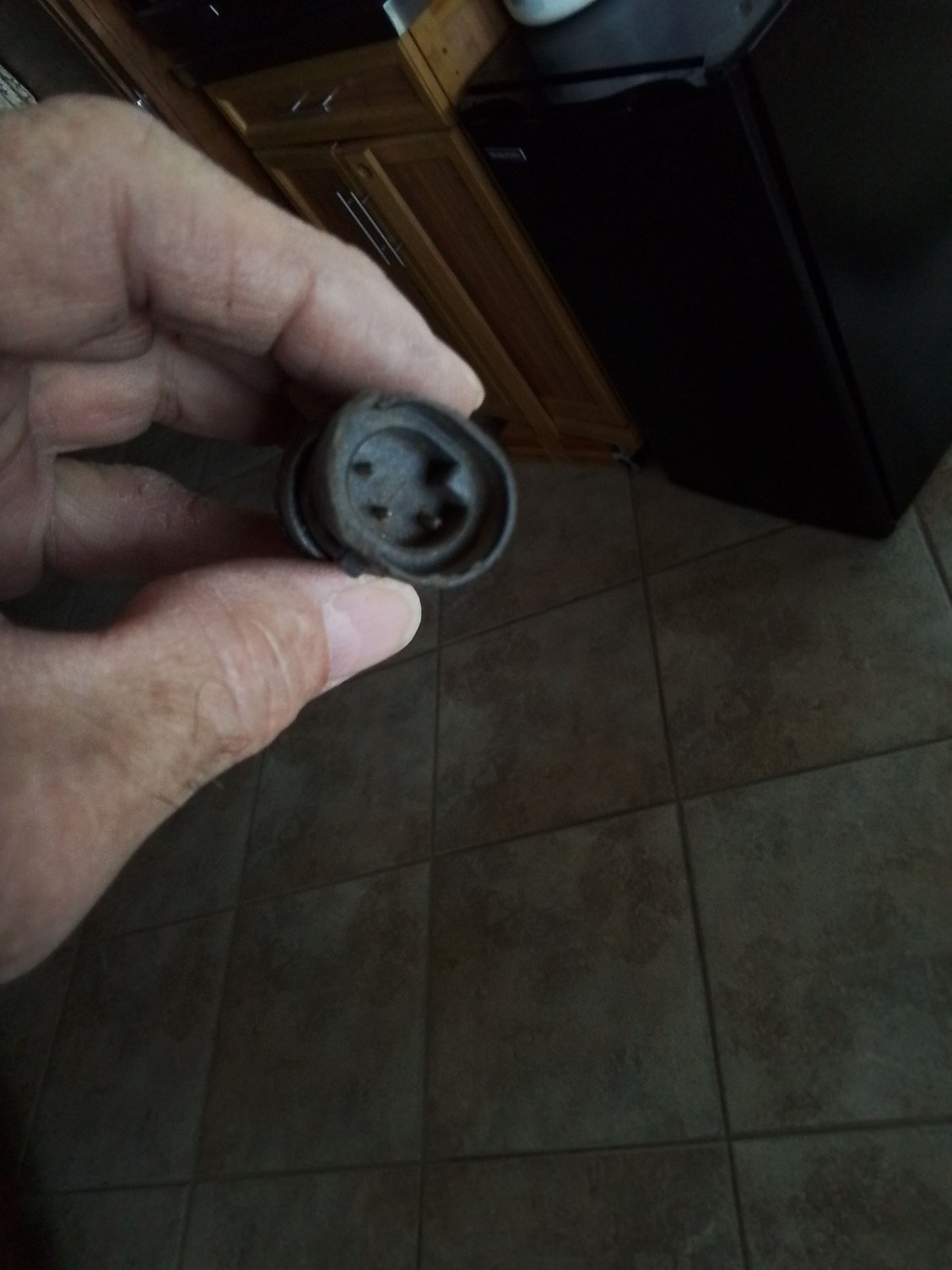

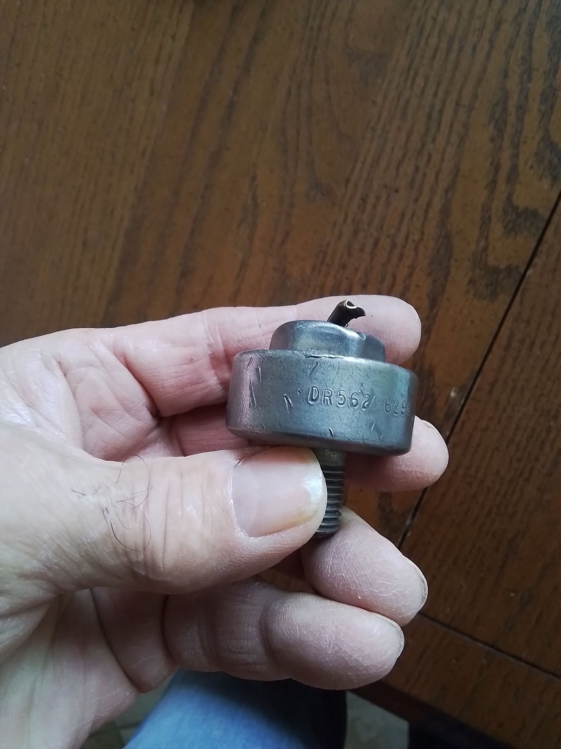

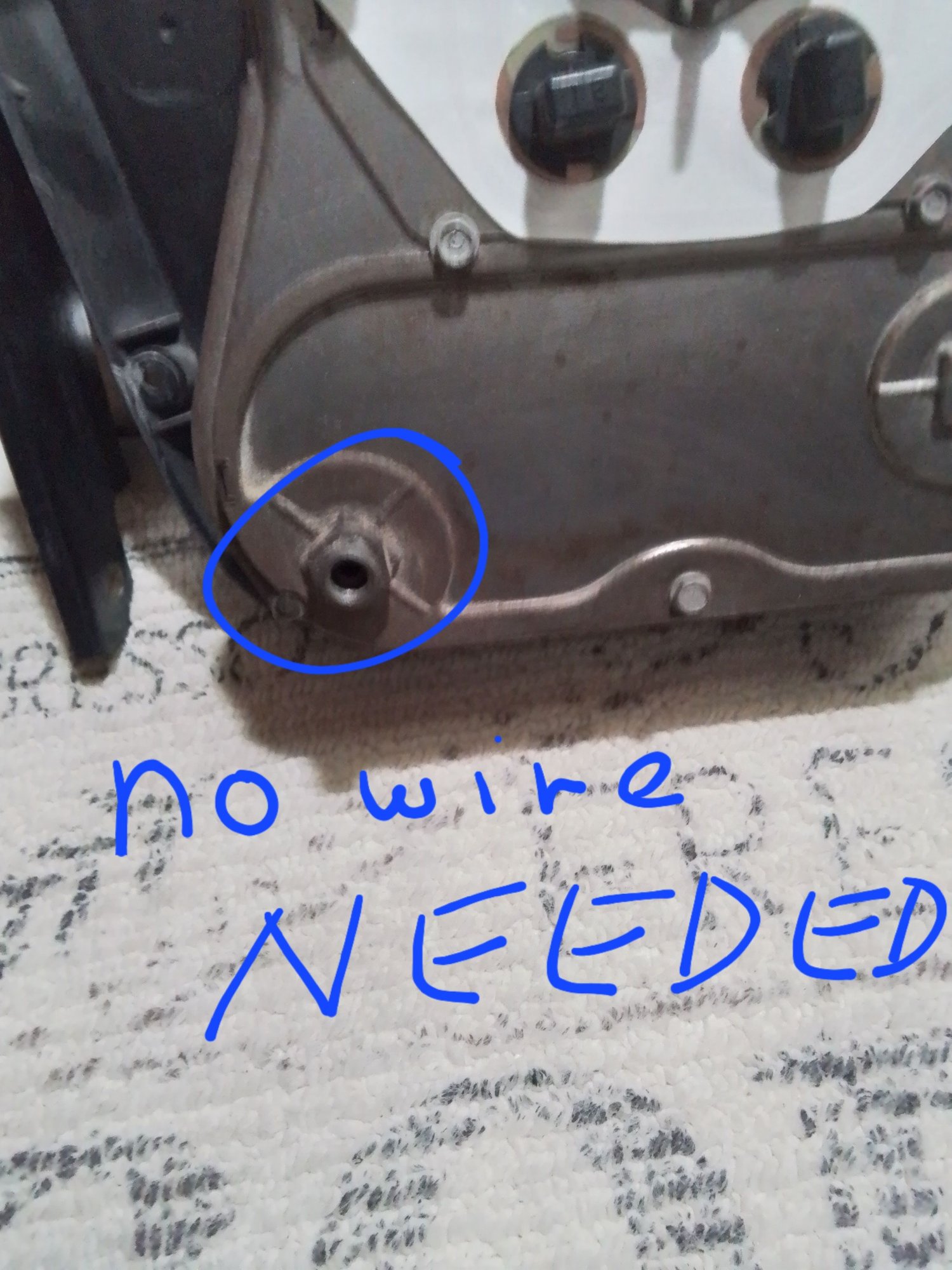

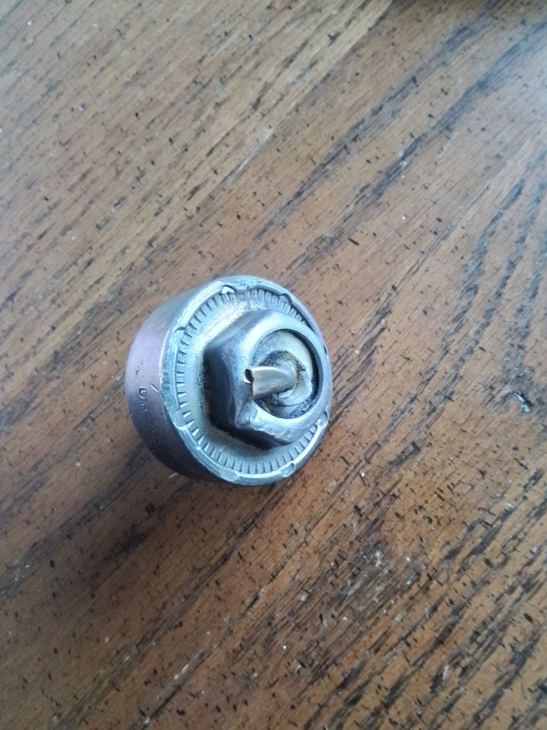

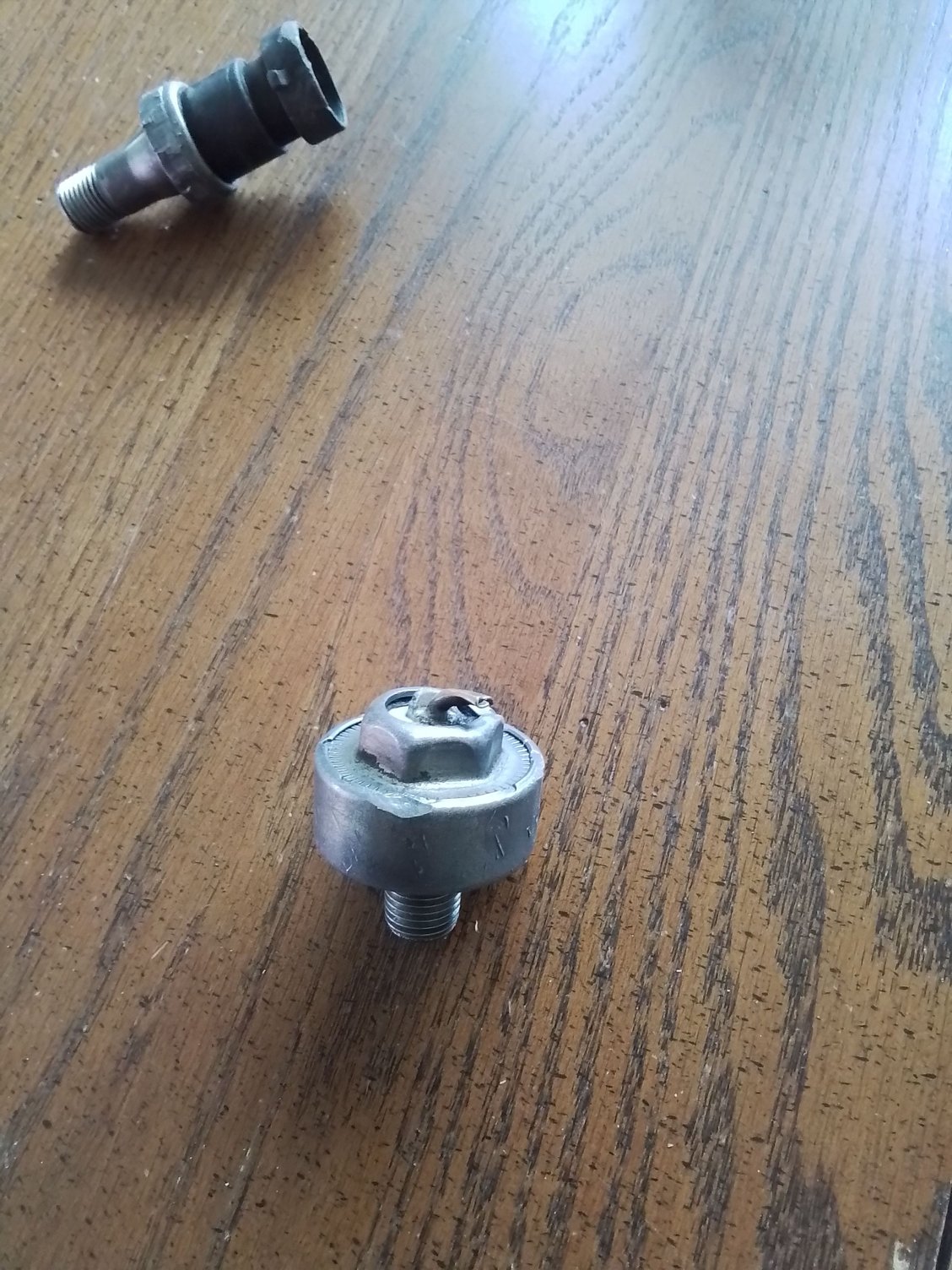

I must have taken it out years ago, but I did save it. - pictures below. Also this other part thinking it was just above the oil filter I also took out thinking it is a water temperature sending unit or oil sending unit - yes or no.

What would it hook up on/to ? I'm not using a ECM of any type.
Sorry had to Edit it for more info. Look back read again.

1/4 npt plug and your set since your not using a ecm

For the second part in top picture I've looked in RockAuto and used 1988 Pontiac 305 specks found there oil pressure sending switch shows a two pin part, this one of mine has 3 pins, and doesn't surprise me for some miss matched parts on my truck, I have came to the conclusion that PO or past owners have " Thoroughly Molested " this truck of mine using parts wise what ever they found that fit.

The 3 pin is a later ops, it’s an oil pressure switch as well as a sender for idiot light or gauge. Can remove and block with a 1/8 npt plug.

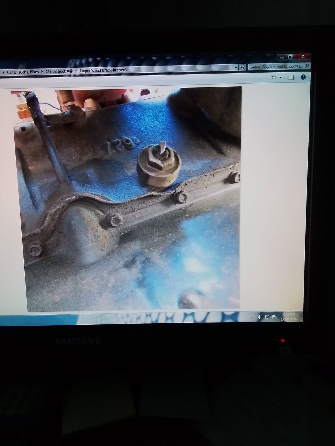

Here's where the knock sensor was located on block.

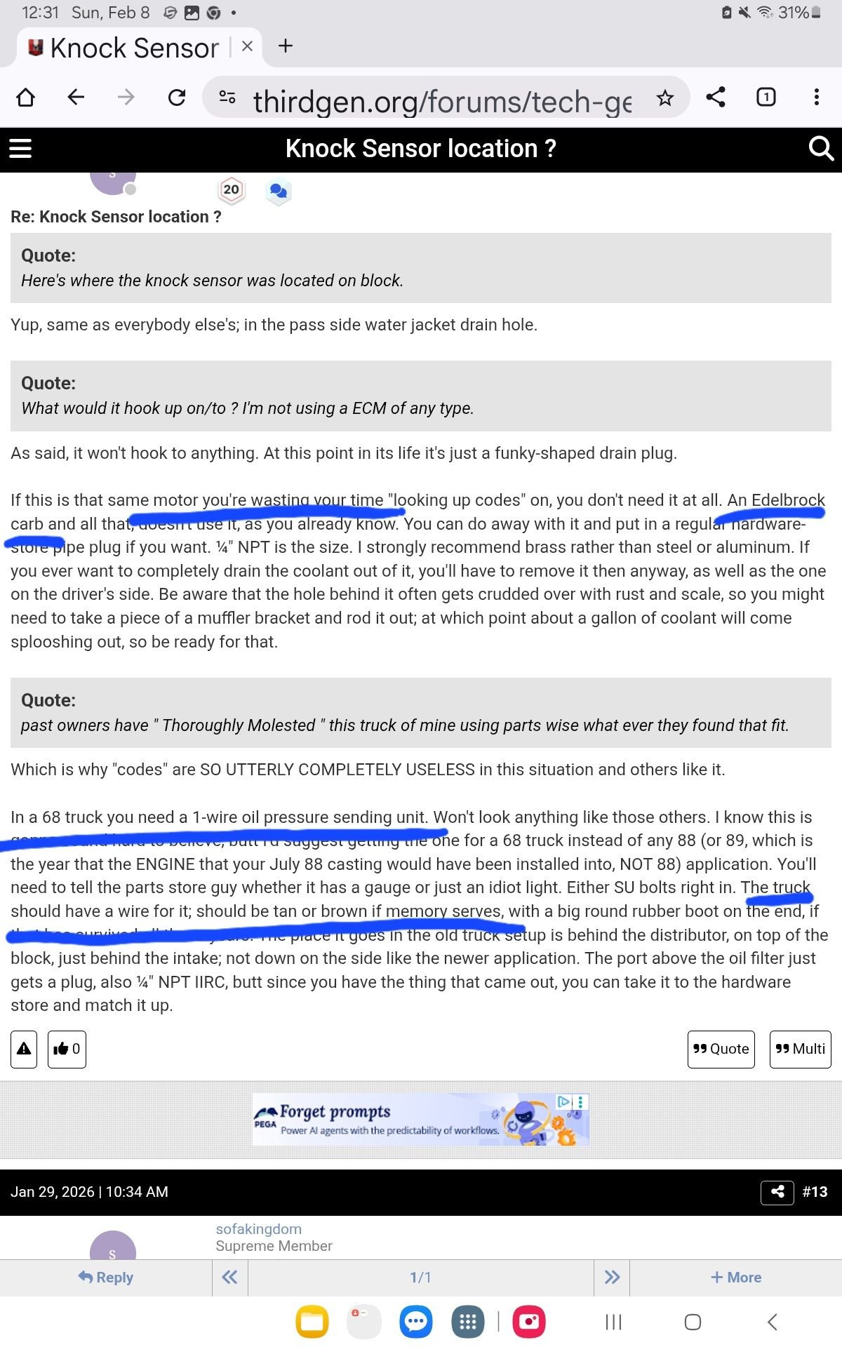

Yup, same as everybody else's; in the pass side water jacket drain hole.
As said, it won't hook to anything. At this point in its life it's just a funky-shaped drain plug.
If this is that same motor you're wasting your time "looking up codes" on, you don't need it at all. An Edelbrock carb and all that, doesn't use it, as you already know. You can do away with it and put in a regular hardware-store pipe plug if you want. ¼" NPT is the size. I strongly recommend brass rather than steel or aluminum. If you ever want to completely drain the coolant out of it, you'll have to remove it then anyway, as well as the one on the driver's side. Be aware that the hole behind it often gets crudded over with rust and scale, so you might need to take a piece of a muffler bracket and rod it out; at which point about a gallon of coolant will come splooshing out, so be ready for that.
Which is why "codes" are SO UTTERLY COMPLETELY USELESS in this situation and others like it.
In a 68 truck you need a 1-wire oil pressure sending unit. Won't look anything like those others. I know this is gonna sound hard to believe, butt I'd suggest getting the one for a 68 truck instead of any 88 (or 89, which is the year that the ENGINE that your July 88 casting would have been installed into, NOT 88) application. You'll need to tell the parts store guy whether it has a gauge or just an idiot light. Either SU bolts right in. The truck should have a wire for it; should be tan or brown if memory serves, with a big round rubber boot on the end, if that has survived all these years. The place it goes in the old truck setup is behind the distributor, on top of the block, just behind the intake; not down on the side like the newer application. The port above the oil filter just gets a plug, also ¼" NPT IIRC, butt since you have the thing that came out, you can take it to the hardware store and match it up.
Here's my motto I live with when I ask a question it's because I'm after a certain answer - what ever the reason I'm asking it doesn't give you the right to belittle me just because I have a 305 ci motor so F'en what ! IF ITS NOT BROKE WHY CHANGE IT !
My other post did not say I have a Edelbrock carb like you think I have, it's a Holley and the intake is Edelbrock. There you go again Jumping to Conclusions my truck has Gauges and doesn't have a wire for a OPS.
Did you ever stop to think I might be asking the questions I'm asking because I might be thinking of going back the way it was when it rolled off the assembly line in its ORIGINAL CONFIGURATION ! ! ! No You Didn't, your mistake.

​​​​​​​my truck has Gauges and doesn't have a wire for a OPS
Well that SUCKS; kinda hard to make a gauge work when some PO "improved" it by removing the wire. If there's a gauge in the dash then there WAS AT ONE TIME at least, a wire for it. Butt if you can find it or replace it, you'll need the SUs for gauges rather than idiot lights, then.
​​​​​​​I might be thinking of going back the way it was when it rolled off the assembly line in its ORIGINAL CONFIGURATION ! ! !
You might have mentioned that if indeed it's true. In which case, I'd have told you to yank the 89 305 and all that Holley this and Edelbrock that, and throw it in the trash, and get a 1968 something or other. You haven't mentioned what the truck originally came with so I can't even advise you on what that might be. Most likely a 230 or 250 6-cyl, or a 283 or 327 V8. Meanwhile, I DID tell you how to put it back to its "original configuration" in the areas you asked about (the KS you don't need, and the 2 gauge sending units), to the extent possible while leaving the later model motor in it; I even told you which sending units to buy and where they go. Not sure how that constitutes you "getting laughed at".

'77 and older GM trucks used a mechanical oil pressure gauge, rather than electric.
OP has no use for a knock sensor or an oil sender.
