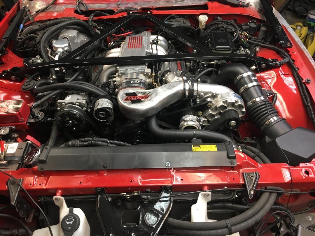

I'm adjusting the Spark Advance table in TunerPro RT to maximize the vacuum at idle to ensure my new brake booster has sufficient vacuum.
I've set the base timing on the car to 6 degrees BTDC, updated the Spark Reference Angle-Base Timing to match, and updated the spark advance table between 400 - 1200 RPM's to 16, 18, 20 and 22 degrees.
Latest update measured timing at the harmonic balancer @26 degrees BTDC.
Car starts and idles fine but I cannot get anymore vacuum beyond 13-14 inHg, regardless of the advance table set between 16-22 degrees.
I've backed out the idle screw on the throttle body so throttle plates should be closed.
I've plugged the vacuum lines coming into the car at the Fan/AC controls to avoid any vacuum leaks.
I might try blocking off the port to the brake booster and Supercharger by pass valve.
I can also smoke the intake to see if any leaks are present.
Have I missed any other options to diagnose why I cannot get more vacuum at idle?

I ran smoke through the rear end and vacuum hose from the brake booster. Found out my exhaust is shot with multiple seam leaks which becomes yet another project. Smoking the intake revealed very small leaks around the throttle body shafts. This is a new BBK 58MM so assume I pushed passed the o-ring's when pressurizing the intake. Next, I increased the timing advance from 22-28 degrees BTDC, in 2-degree increments. No noticeable increase in the vacuum, stayed at 13-14 inHg. If my RPM's are at 1K, vacuum is 15 inHg. Increasing RPM's above 1K increases vacuum to 16-18 inHg. I decided to increase the RPM's at idle from 750 to 800 RPM's which increased the vacuum at idle to 14-15 inHg. I adjusted the timing looking for highest volume, settled on 26 degrees BTDC with 15 inHg. Has anyone had success with adding a vacuum cannister before the brake booster to increase vacuum for the brakes during deceleration?
