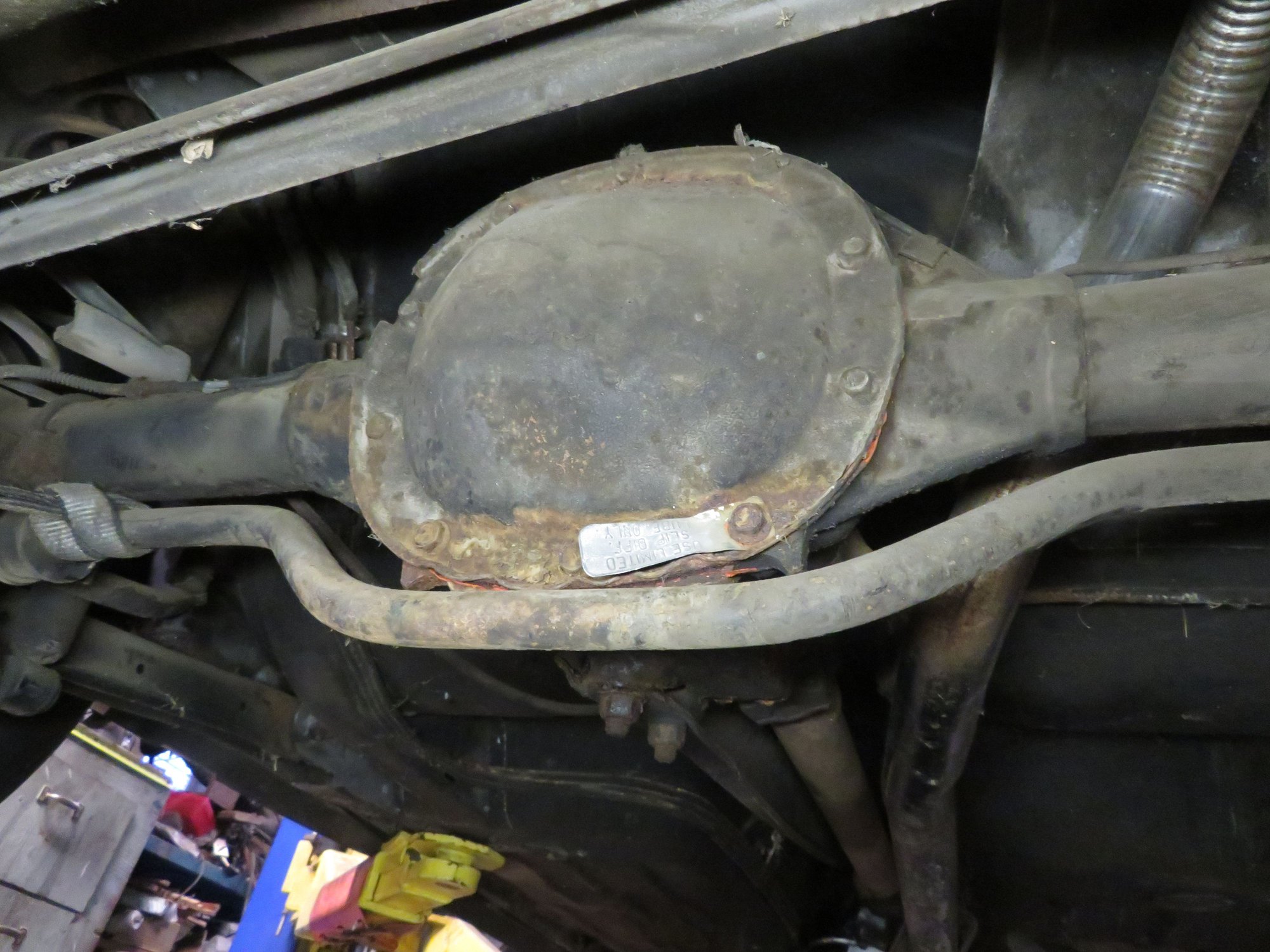

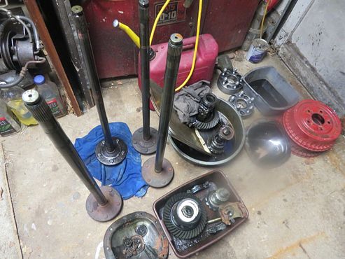

Thanks for that. I have an 84 T/A with a drum brake 10 bolt. (Non posi, altho it has the " Limited slip diff oil only" tag on it.) I'm sure they're hiway gears inside too, seeing it's a 305, TH700, AC car. Haven't pulled the cover. I'm in the middle of a 301T eng. swap, and a WC T5 swap. Would like to do something with the back, and will end up with a 3 1/2 gear, or 3.73 depending.
Not sure if the carriers have different offsets for steeper gearing. But seeing this rear is a non posi, I'll need to change all the guts anyway. I have a line on 4 w/disc 9 bolt, (very used and crusty) that has a 2.77 (?) gear, (posi) and was wondering if a set of 3.42s could be used on that carrier. I won't be drag racing this car, and the little 301 doesn't make a ton of power, but I'll beef it up a bit, and put it thru some "spirited" driving...just for fun. I would like a step up from the current rear. And the disc addition would be a plus. (Why do these photos appear so large on this site?)

Most likely it came with a 3.23. That was very common in cars like that one.
Since it's all spooooged up with that red silicone sealer, somebody has already been inside it. See the last paragraph above. There's NO TELLING what's inside it now. Take off the cover and look; what you see is what you've got. Who knows. I do find it amusing though, that they put that tag on there, if it's not actually posi; of all the poseur crap I've seen people do to cars, that's a new one. Because of course if it isn't posi to begin with, it doesn't need the additive. Or maybe, it started out life as a posi, butt being a POS Auburn, it's completely wore out, and you just can't tell. Again, who knows. Take off the cover and look.
No sense in putting a non-posi rear in a car that's thought to be intended for "performance" or "power". However, the 301 will adequately prevent that, so maybe it wouldn't be that big of a deal. And the ordeal of putting a Pontiac motor into a chassis that it never came in, in 2026, likely means that the car will never drive again, just like about 99.999% of all the people in the "Pontiac Swap" thread in the stickies on the Engine Swap forum. Butt hay, we'll overlook all that, and assume that you come to your senses and decide to do something more intelligent than ... all that.
So, first off, it needs a posi. Posi is a property of the carrier. I don't know of any decent posi carriers available today for those little weeeeenie axles. Meaning, any real-world carrier you can buy, will have 28 splines. Meaning also therefore, you'll need a pair of axles. There's a fair variety of those available, so no problem there, apart from a few $$$. Similarly, nobody sells carriers for 2 series rears that I've seen (3.08 or lower) since nobody doing this sort of thing would do something dumb like that. Therefore you'll end up needing a 3 series 28-spline carrier, gears of your choice, a whole "kit" with all the bearings and whatnot, and axles. Again, nobody in their right mind would sink that kind of $$$ into a drum brake rear, or the early D-M discs either, since they're such GARBAGE. Common-sensical thing to do would be to locate either a 89-92 disc rear which would be the same length as yours and allow you to use your stock wheels, OR, a 98-02 (NOT 93-97) one, and use wheels with the 4th gen offset. Either of those 2 will get you rear brakes that are more or less both modern and actually functional. For the carrier, I'd STRONGLY recommend getting a worm-gear type, which would be either the Zexel Torsen like the LS rears came with (ideally, get one from a SLP car, i.e. either a WS6 or SS, which are stouter than the stock ones), or, a Detroit True-Trac.
AFAIK there are no "thick" gears available for the 9-bolt, to allow ratios beyond 3.08 to be installed on a 2 series carrier. That thing is a dead end and would be a total waste of money. Don't even bother thinking about it; let The Greater Fool make that mistake. (One thing I've learned about humans in the time I've endured this miserable assignment to this pitiful planet is, there is ALWAYS a Greater Fool, and usually it doesn't even take very long to find him/her) Even more so if it's 88-back with the D-M brakes.

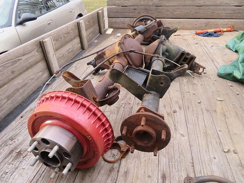

Now, to get down to business, you gave me some great info on these rears. So basically you're saying putting bigger axles, to fit a 3 series carrier, (to accept a 3.5, or 3.7 posi) would be more expensive than locating a 89-92 4WD rear? Are those rears even still out there for sale? I would just prefer to keep most of the mods GM, rather than aftermarket, if possible, and not cost prohibitive. And I really would like to have the rear disc too. And lastly I mentioned the 9 bolt Aussie available, but it seems parts for those are even harder to find than hens teeth. So i guess I'll be hunting for a 90 4WD posi rear. I can put guts in one if needed, and have done other rears in the past. Never a 3rd gen tho. Anyway, I appreciate you takin the time to educate me boss. Have a great week-end.
Geesh. Can these photos get any bigger?

you're saying putting bigger axles, ... would be more expensive than locating a 89-92 4WD rear?
No, I didn't say that. Never said anything about 4WD at all, considering that none of these cars ever came that way. What I DID talk about was a 4th gen rear, in particular 98-02. I have no clue what you'd have to pay for such a 4th gen rear, so I can't even make that comparison. Axles are maybe $250 a pair, a carrier is maybe $450 or so, a "kit" $120, and gears $200 - 250. Then, ideally, in order to not waste money on doing all this to a drum or D-M brake rear (i.e. putting 7 tubes of lipstick on a pig to make it into a supermodel), you'd need to find a 89-92 disk brake "core" to do all this too, and throw your drum POS in the trash. THOSE are tough to find. Which is why I brought up the other option, which is, a 98-02 rear, and 4th gen wheels; you might even be able to find one with the gears you want already there, which would reduce the amount of stuff you'd have to buy for it, balanced against the cost of wheels, which if you're gonna be buying new those anyway, wouldn't matter.
Iunno. Depends on if anybody wrecks a car, or parts one out that's rusted or whatever, that has one like that, and the rear finds its way to somewhere it can return to the market. I'd think that would happen from time to time. May require a certain amount of patience however.

I've seen a ring gear spacer offered for the 2 series posi carriers, to allow 3.42/3.73, and was wondering your opinion on that route.
In this model of rear, it's not a good idea. Reason being, it has to be about .400" thick to move the ring over the correct amount, and the "shoulder" feature on the carrier in this model of rear for the ring is only about .250" tall, which means then that with a spacer, the ring is no longer positively centered on anything when using one. The "special" "thick" gears are the better option in this rear.
Butt, it's a moot point anyway, since (a) you say you don't have a posi now in the first place, and (b) the carrier you have now is more likely a 3 series, (c) you'll be replacing the carrier anyway to get posi, so you'll just be buying the right thing for whatever combo you end up doing, and (d) you don't want the gears you have, so you'll be buying those as well, which gives you the chance to get the right thing for your eventual setup.

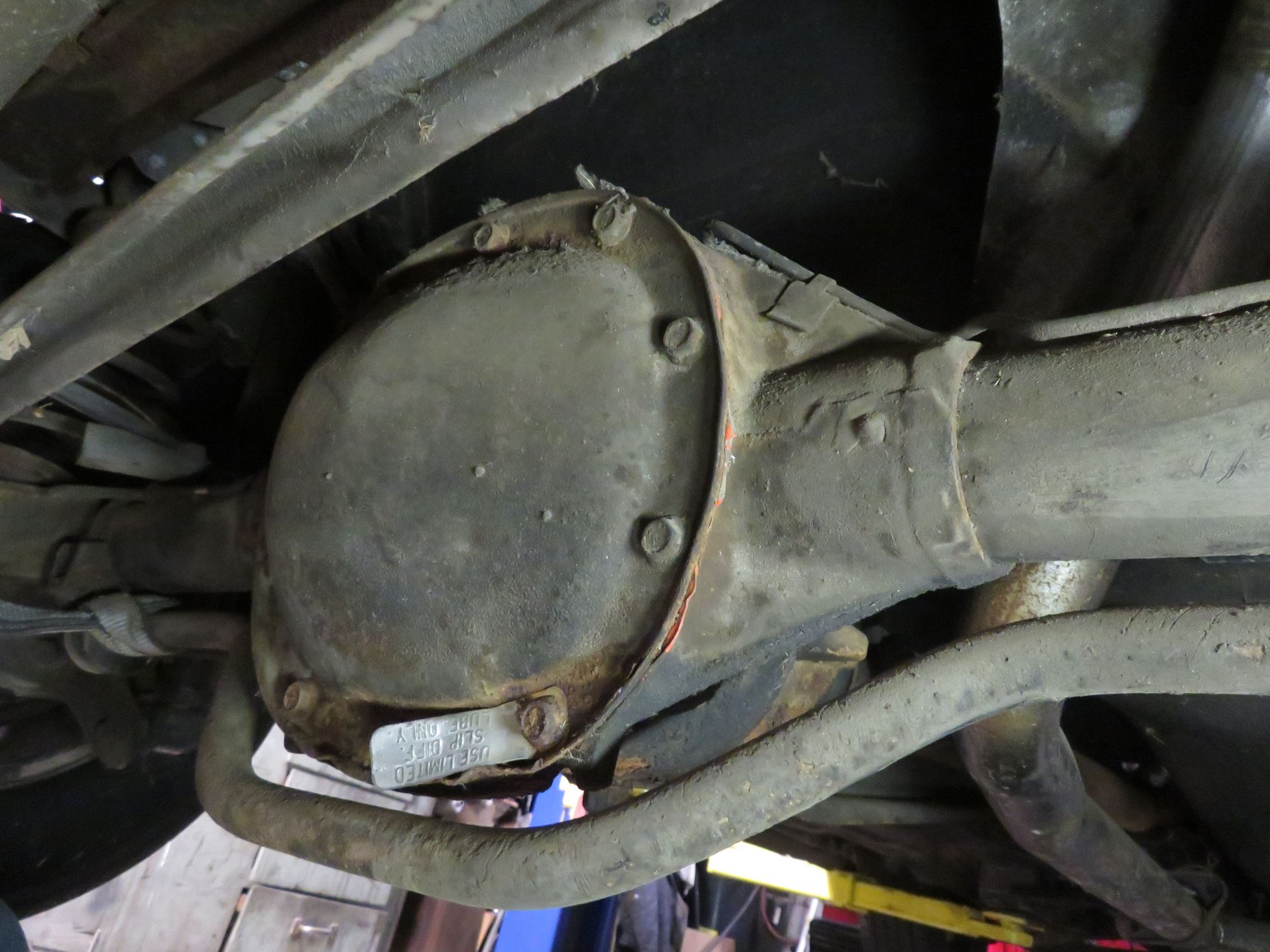

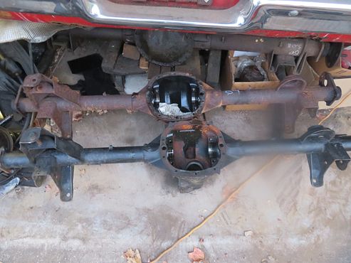

I see the 4th gen rear is wider, but it appears all the 3rds are the same. And I just found the sticky/FAQs, (on 10 bolts questions) on this site, which is very informative. Point taken on your advice FC. I'll check into the C/L for more possibilities too. Thanks.

So could this one actually be a 3.45 posi?
If it's a 10-bolt, no.
Gear ratios are always the ratio of 2 whole numbers. The numbers are the tooth count on the ring, divided by that on the pinion. One of them is virtually always a prime number, sometimes both. A prime # guarantees that every pinion tooth mates to every ring tooth before repeating, and each tooth mates with the other an equal number of times over its lifetime. 3.73 (3.727272727272...) is 41 & 11: both are prime.
10-bolt gears have more teeth than 9-bolt ones do. Like everything else in life, it's a tradeoff; more teeth means that each is smaller and therefore weaker, butt smaller tend to make less noise, and generally have lower loss (better gas mileage).
10-bolt ratios commonly seen include 2.73, 2.92, 3.08, 3.23, 3.42, 3.73, 4.10, & 4.56. 2.73 is 41 & 15; 2.92 is 41 & 14; 3.08 is 40 & 13; and so on. 3.42 is 41 & 12. 41 ring teeth seems to be a popular number with GM in these.
For whyever then, 9-bolt ratios have fewer teeth. The commonly seen ratios in those are 2.77, 3.08, 3.27, 3.45, & 3.70. 2.77 is 36 & 13, 3.08 is 37 & 12 (rounds off the same to 2 decimal places as the 10-bolt ratio butt isn't exactly the same), 3.27 is 36 & 11, 3.45 is 38 & 11, and 3.70 is 37 & 10. All 9-bolts, with only 1 exception that I've ever seen, are posi; the ONE is a photo that someone posted on here years ago, and it shocked most everybody, because nobody had ever seen one. So, not "all", butt maybe "all butt one". I find that hard to believe in a mass-produced product, butt hay, if they did it, then they did it.
The last year of the 9-bolt in these cars was 89. Therefore if it's REALLY a 92 rear, it can't be a 9-bolt, and therefore can't be 3.45. Could be 3.42 butt I'm not sure there were any 3.42 rears that year; if so, it would have been in a 5-speed car w G92 option, a very much maxed-out combo, if it existed. That said, the 9- and 10-bolt are the same externally, therefore directly interchange, so it's possible that somebody stuck a 85-89 9-bolt in a 92 car. Without seeing the rear itself I couldn't say what it is for sure. It could be a posi, or that is, it may have come with a posi; butt if it's a 10-bolt it would have been the steaming bucket of s*** Auburn, and as such, hot festering GARBAGE. If it's a 9-bolt, and from 85-88, it will have the D-M rear discs, which are even worse than the Auburn carrier, and even worse than drums. You DO NOT want those. If it's a 89 rear, with the PBR brakes, then those are the brakes you want, and it's a somewhat decent choice; although the odds of its posi being worn out are very high as well, and while it's possible to renew that, it's not cheeeep and not trivial (it's not just parts you bolt in, machine work is required).
The 4th gen rears are about 1-5/8" wider on each side, therefore about 3¼" overall. Putting one of those in one of these cars with our stock wheels looks STUUUUPID and poseur, and ESPECIALLY with those tiny 14" & 15" ones they used in 84: these cars' wheels are little skinny pizza-cutters by modern standards, and having pizza cutters that stick out past the fender wells looks ... well, there's ALOT of inappropriate slurs that some people might be tempted to use to describe it. I'll just say it looks like cold leftover yesterday's A$$, in a word. OTOH with 4th gen or C4, 5, or 6 wheels (or aftermarket to fit those) they're in exactly the same place as our stock wheels, and with newer wheels like that, you get modern driving capability, and tire sizes you can actually still go to the store and buy in a QUALITY brand (Michelin, Pirelli, etc.) along with load & speed ratings suitable to its weight and performance. I would NOT hesitate to put 4th gen or Vette wheels on one of these cars, myself, if it came to that. Oh wait... I have a set of C5 wheels on my car now, although since I have a 3rd gen rear, I had to use wheel adapters on both front and rear to get the offsets right.

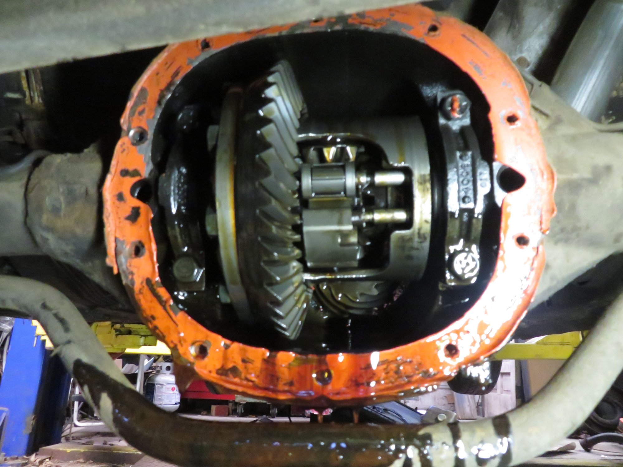

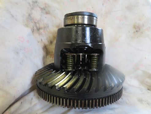

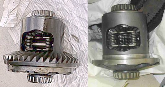

I believe the rear in RI is "not" sold as a 9 bolt, but a 10 bolt. (Not sure why the 3.45 tag) That's why I was asking if the guts would interchange into my 84 housing, (If it is a 92 10 bolt).
I just saw Hawks offers a 3.42 R+P, "and" a clutch type posi unit for $400, which isn't unreasonable to me. Still would need 28 spline axles, and an O/H kit, not including a disc brake conversion. Went onto C/List to see if there are any 3rd gen rears available, but to no avail. Waiting on a couple replies from Ebay sellers...probably tomorrow.

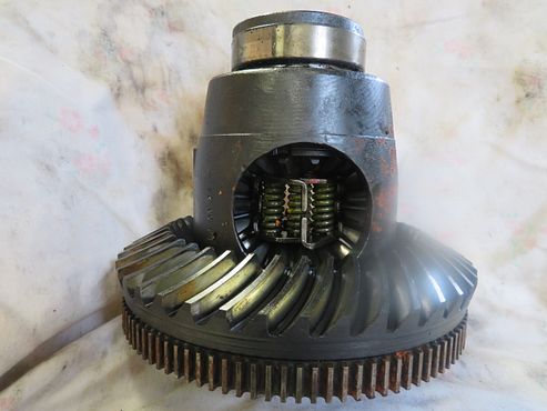

And just now, I pulled the rear cover off this 84 10 bolt, to find it "is" a 3.23, with one of these totally weird carriers, that I saw once in my life before, (in something like a Grand National rear), but have no clue how it operates. What kinda lunatic would come up with this design, in a rear? I know all about clutch and cone diffs, but this (?) totally blows me away. When I rotate one tire, once (for a second) I saw both wheels turn the same direction, then not. When tried again, only one will turn. The other doesn't go the other way. And I can hold one, while turning the other. I can't wait to hear the explanation of this conbobulation.
Old Mar 22, 2026 | 02:56 PM

Sofa will properly ID and have some amusing commentary on the performance, but I believe thats a gov lock (gov bomb) locking diff. I thought they were only in trucks. To be honest, if its a working locking diff and a good R&P, leave it till you find exactly what you want.

That is an Eaton Gov-Lock. Aka Gov-Bomb, Grenade-Lock, etc. ABSOLUTELY UNEQUIVOCALLY POSTIVELY NOT a "performance" piece AT ALL, in any manner way shape form or fashion. It was originally designed for small military off-road vehicles with a real small diesel 4-cyl or some such. Works GREAT in that sort of application; not so much in any kind of application where pavement, power, and traction are involved. GM put them in S trucks in the 7½" rear, and full-size trucks in the 8½" one. My Avalanche had one originally. I think they're even in the 9¼" (14-bolt). A few of our cars, back in the posi shortage days, got those; more likely though, Stimpy got one out of a S truck and slapped (threw?) it in there.
The way those work is, there's NO POSI BEHAVIOR WHATSOEVER (acts like an "open diff), until the RPM difference between the axles reaches something like 100 RPM. At that point, one or the other of those little governor weights, depending on which axle has the higher RPM, moves outward, which engages a "dog" which engages a clutch. In a low-power, poor traction situation (off-road... sand, mud, wet grass, ...) it works GREAT. In something like our cars though, the engagement is so sudden and violent, that it EXPLODES. There was a post on here some years ago from someone whose ... that ... exploded SO HARD, that the shrapnel went THROUGH THE COVER, and INTO THE GAS TANK. Lovely. Just what we all want: red-hot sparking metal launched into the fuel.
Which is why it acts like an "open" most of the time; butt if you spin one axle fast enough (it's easy to do by hand if the tires are on it) to reach that magic threshold, it locks up, and pretends to be a posi for awhile. It kinda stays locked up until the force imbalance goes the other way, which kinda "resets" it.

You guys explained it as I just got educated from the net. It looks to have the strength of a harbor freight 1/4" ratshit. Most pathetic design to ever come out of Detroit. (Much like the design of the 301 Siamesed cylinder head ports, and crankshaft with 2 counter weights.). Are these (were these) engineers on drugs, or what? The common sense technology born from the great engineers of the WWII age, I guess has long been lost from now-a-days generations. Well, I guess these 80s designs can't really be blamed on todays technology, but on the Viet Nam/LSD generation.
Anyway, I'll still be lookin for better mods to mine, but this thing behind the little 301 (like FC suggested) will be tolerable, if nothing else becomes available soon. I'll just bullet proof this rear, by filling with Amsoil, "slick 50", GM posi lube, and maybe a squirt of Locktite. I think JC Whitney might have a miracle additive too.

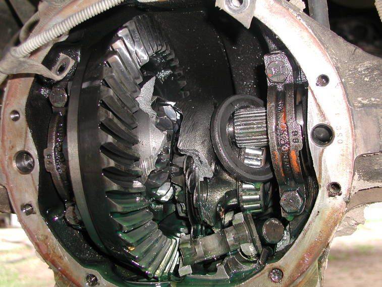

And lastly Mr. King, those were some pretty "explosive" photographs. Can't say they're surprising tho.

I wouldn't say it's "pathetic"; just, while perfectly well suited to the application it was designed for, it is NOT suitable when power, pavement, traction, and shock are present. Not sure why GM puts them in full-size trucks either.
Pretty sure the Gov-Bomb doesn't need posi additive. GM specifies synthetic 75W-90 for my truck for example. Doesn't mention friction-modifier additive at all. Not sure what Eaton themselves call for. There's no "bullet proofing" that thing with fluid in any case, it's still gonna be just as fragile no matter what.
The thing to watch out for is a sudden one-wheel-peel in a low traction situation, like a hard launch followed by a slick spot such as wet or sand, followed by a sudden restoration of traction. If the rear's lockup and the application of torque happen together, that's when it can explode.

Swap meet find. A person wanting to M/T out his garage, selling these rears....for literally pennies on the dollar.
The red rusty one(?), an 89 10 bolt 7.6 2.77 open, (thrown in for free).The black one, a 4th gen 3.23 Eaton clutch style posi, a step up from my gov/bomb. Less than $50 for both.
I figure the posi alone was worth it, and the rest is extra...????. Figure I can leave my gov/bomb 3.23 drum brake stock 10 bolt alone, and put together this 89 rear, with the posi, and now looking for ..."everything else". Wonder if them Corvette wheel adapters are worth anything, to anyone?
If it is, it's not stock. GM didn't put Eaton carriers of that kind in those cars. Would have to be an $$$aftermarket$$$ one if it's an Eaton.
Look at it closely. If you see this logo on it, probably near the driver's side carrier bearing, it's an Auburn, like all the other posi units GM used in 4th gens before they switched to the Zexel Torsen in 98, and is likely not worth building into a new project due to its poor longevity.
It's a kinda stylized "A". The carrier itself will look much like these.
An actual Eaton posi will look like this.
https://www.summitracing.com/parts/etn-19599-010
Note the price: it's not likely you're getting one in a $50 pile of used parts. Not "impossible" of course; just, not all that likely.
Looks like you tried to post 2 photos. The one on the left doesn't work, only the one on the right, that shows 2 pairs of stock-looking axles, and some other parts, butt is from too far away to see very much detail.
The wheel adapters might be worth something to someone; maybe even yourself, eventually. If they're about 1¾" to 2" thick, they'll allow for C4 or newer, or 4th gen wheels, on one of these cars. Maybe as in, if you wanted to put a 4th gen rear in your car, say to get the better brakes, and want 4 matching wheels, then you might use 4th gen or Vette wheels either stock or aftermarket, and those adapters on the front. You'd need 4 of them to swap the newer wheels on with a 3rd gen rear; the ones on the rear would typically want to be slightly thinner than the ones for the front, maybe like 1¾" on the rear and 2" on the front. That's the combo I have on my car, with a 3rd gen rear and C5 wheels.
The red paint on the drums makes me want to hurl.

So for yrs I've gone to this automotive swap meet every spring and fall, ( since I left the good ole USAF in 81, and came to this great state of CT...) And ever since this 84 T/A project came to fruition, I've wanted a 3.73 posi, with discs, not knowing much about 3rd gens. (I stopped caring about Detroit performance cars after 73.) But when this 84 became available to me early 2000s, (and the 301T was buried under a bench....since 1990), I decided to make it a combo, with the intent of getting better mileage than 12-15, (that all my previous street Pontiacs got). Then I heard the 301T and good gas mileage was an oxy-moron, so that desire went away too. So now, I'm just looking for an entertaining street car, that I might take to the track to see what kinda times it'll do, and maybe a bit of spirited driving on the street. No slicks, or high torque, 3500 RPM clutch drops, with full powershifts. At least not anything like how I treated my GTOs back in the day. And I won't be remortgaging my house either to put this car together seeing retirement isn't but a yr or 2 away.
So, back to the swap meet. Because the 3rd gen rears with the guts and brakes I want are as rare as hens teeth, it doesn't keep my from lookin for one. Not many 3rd gen rears are ever for sale, at least around here, and these 2 caught my eye. The seller rushed right over seeing my interest, and I told him I was lookin for a 3.73 posi with disc, and he reply's, "that what this is". (right next to it was the open 2.77 3rd gen) . Says he has an 89 T/A at home, (showed me a pic of it on his phone) and said he uses it for some kinda low budget circle track racing. But these rears were in the way for yrs, and he didn't wanna bring it/them home. I asked him to pull the cover so I could see the guts. (By the way, he told me it was a 4th gen rear) . And I believe this site, (maybe you SK) informed me the center sections are interchangeable, with only the axles being longer. And low and behold, it wasn't a gov bomb, but the typical style I'm use-ta seeing. "However", turns out, it wasn't even 3.73s, cause after turning the axle, and counting the revs, it's nothin more than 3.23s, which turned me right off. And when I see what the aftermarket wants for posis, I decided I'ld take it, just because it was better than the gov/bomb, that I don't trust as far as I can spit. But this Auburn unit's gutta be better than what I already have, and he asked me if I wanted the 3rd gen rear for free, just to get rid of it. So I took them both to build on it, (the 89 rear) rather than take apart the stock one in the 84, that already mentioned. So, for the price, I'm not complaining, and I'll keep my eyes open for a set of 28 spline axles, and something with a disc changeover. I will spend some $$ on a set of new 3.42s, or 3.73s, and of course new brgs.
So SK, you said both my previous photos weren't viewable? I don't know why. I can see them in this thread. I'll throw these at you, and see if you can see them. (By the way, I tried opening up your link for the Eaton posi at Summit, and it won't show either). But I did go to Google images and saw it there. They look the same as the Auburn to me, but I'm guessing they have Kryptonite spider gears, an Inconel case, titanium springs, and Kevlar clutches to warrant the extreme pricing.
And lastly, you mentioned how much you enjoyed the red drums, (LOL), if you want them, you can have them for free. (just shipping) You can use them as freestanding bench grinder bases. I'll even toss in the 26 spline axles to mount them on. What-da-ya think?

Hard to say why I couldn't see them. All I got was the Photobucket generic F-you image. It's better now, I guess you fixed it.
Similarly, no idea why the link doesn't take you to the page at Summit. Maybe all of this is just the Interwebz's way of reminding us that Algore didn't get it perfect when he invented it.
That posi is an Auburn. Just a stock one at that, not even a "performance" aftermarket one. You can look at the pic of those 2 I posted; the left one is a stock 2 series, the right one is an aftermarket 3 series. Big difference (apart from the ratio series): they added a spring or 2 to the clutch plates. :whoopee: Yours is definitely from a 4th gen with the 3-channel ABS though, with the tone ring on it. I strongly encourage you NOT to put it into a "new" "fresh" rear end build.
The Deal is, the purpose and function of that type of "posi" is to use clutches to lock the 2 axles together, butt in such a way that if both wheels have traction, it will yield, and still let them turn at different speeds, as required when going around a corner. Meaning, it suppresses the unlimited one-wheel-peel of the first tire that loses traction (usually the inside one in a corner, and especially if it's the right one) that we all know and love so well, butt the MAXIMUM torque it can deliver to a wheel that has traction while the other doesn't, is limited in turn by the hookup of the clutches. So, it's a sort of balancing act. Too much clutch, and the rear chatters ruthlessly around corners and such, ALL THE TIME, if both wheels have good traction; butt too little, and instead of 4000 ft-lbs or whatever exists at the axles (whatever your motor makes times transmission and rear gearing), you get ... whatever the rear's clutches take to break loose. Most clutch-type units, that's in the 60 - 90 ft-lb range. Which is better than nothing, butt still acoupla sandwiches shy of a picnic.
To test a posi carrier, you hold one axle still, let the drive shaft spin freely (in neutral, if it's in a car), and try to turn the other with a torque wrench. A stock Auburn in brand-new condition is at the lower end of the range I gave you; let's say, 65 ft-lbs. If you can rig up a way to set up that test, you can check it before you devote money to installing it.
No idea why Eaton charges so much for that. They WERE the original that GM bought back in the 60s though, and GM gave the trade name PosiTraction. Frod & Xler bought them too, and gave it their own trade name, butt I can't recall what those were. Pretty similar overall though. It wasn't until well into the 70s that they had any serious competitors at all. I recall a company at that time named Tite Brothers, that sold Eaton carriers that they had specially massaged or added springs or whatever, to make them hook up better; they called their finished product some name that was a mis-spelling of "posi" uncomfortably close to a familiar coarse slang word for female private parts; their slogan was "nothing feels as food as a Tite [product]". Those were the daze. These days though, anybody in his right mind, will buy a worm gear unit rather than one with clutches, especially since they're about the same price. Eaton makes one of those too nowadays, so today, they're competing with themselves. Eating their own young you might say. How charming. Anyway...
No drums for me, thank you just the same. They have NEGATIVE value to me: I've PAID people to come haul piles of em off my property. They're worth more to me GONE than they are in my possession. So please don't inflict them on me.
Gears generally have some indication of their ratio stamped around the edge of the ring. It'll look something like 42:13 on stock 7½" 10-bolt gears (42 ÷ 13 = 3.230769230769230769230769...). Makes em eeeeeeezzzzy to identify. Saves you the trouble of even having to manually count the teeth.
