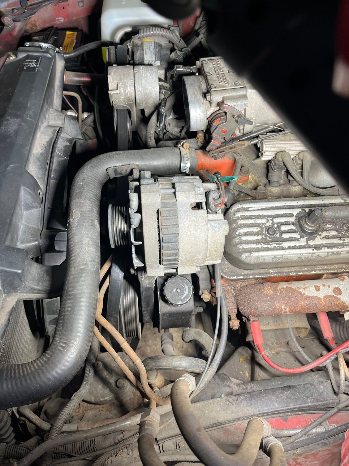

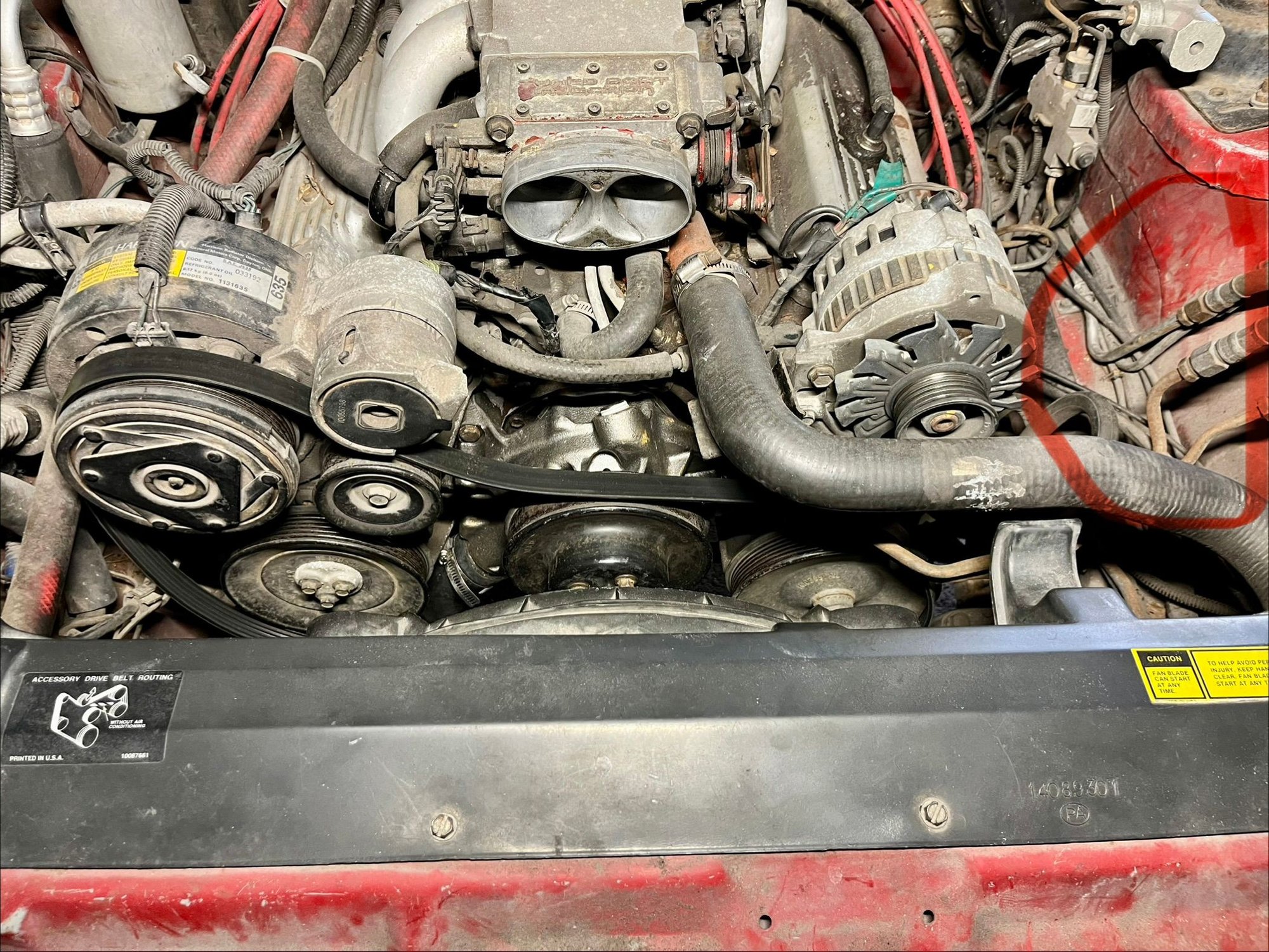

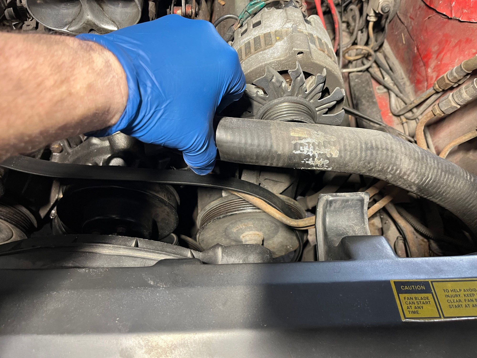

Went to change my serp belt and noticed fuel lines are running through the belt, making it not possible to remove belt or install new one. Car’s an 87’ 305 but someone switched it to a serp system at some point.
Is it possible to just adjust and reroute the metal lines somewhere else to the manifold or do I need to replace. And what is the correct location there suppose to run?
Thoughts on someone else’s dumb decision?

I'd suggest checking the used parts places for those lines off of 88-up cars.

Looks like they re bent the 85-87 lines, get 88-92 used lines route them under the alternator. Might see if hawks or eBay has the set.

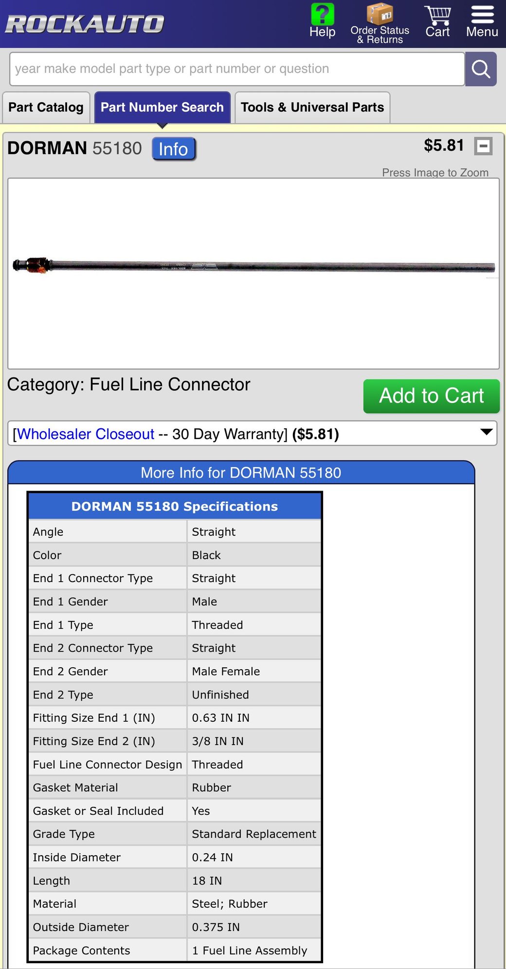

Da fark?!? I’d be so mad 😡 anyway hope you can snag those eBay lines. My only suggestion would be to bend your own from some universal line. Rock auto has some but not everyone is handy with a tubing bender. Good luck op!

if I try bending and making my own, by the looks of it one of the lines is slightly smaller than the other. Does anyone know the proper size for the other line 1/4? And what fitting sizes are needed?

3/8 and 5/16, can always convert to an6 and route over the valve cover.
