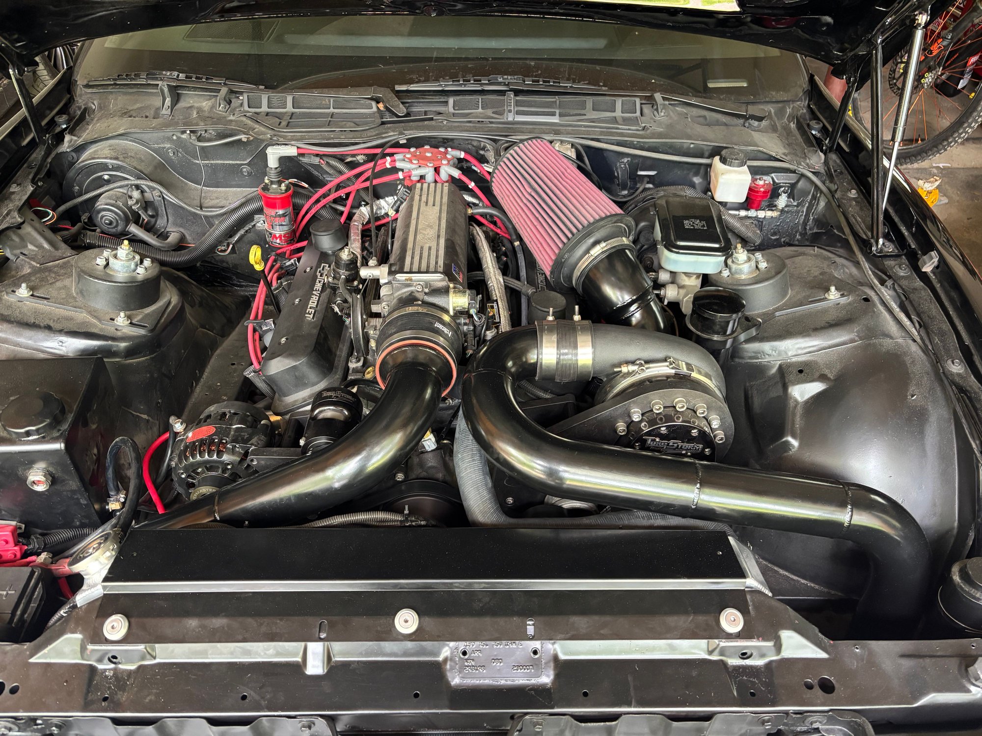

Do you have an in tank pump? I assume you don't w a aftermarket carb setup. But everyone knows how assumptions go. If your happy w your power then just do the efi swap. If not, you should do it all at once. The fitech stuff is pretty lacking. I have an old bronco that came w an go efi system. The interface is pretty lack luster and the tuning is just so-so. Ive had 2 edelbrock pro flow systems and they're far better in every way. The holley systems are in between. Regardless of the EFI system, you'll need a new fuel system. Either an in tank pump w filters and a regulator w a return or a sump system. All the systems either run on 43 or 58 psi. The systems that are a 4 barrel looking TB w injectors in it are OK(ish). The edelbrock multi port systems run awesome. All of these systems are tight under the hood. The pro flow systems w multi port and a carb style TB didn't fit under my stock TA hood. But it ran awesome. Now I have a pro flow XT that fits under my stock TA hood. The pro flow is more money than the others but comes w an ignition system and the others don't, plus it runs better. This winter I'm pulling the fitech off my bronco and installing a pro flow on the 302.
this is my pro flo xt system. I had it running for 2-3 yrs before the blower and it was great. It was also easy to upgrade to forced induction.
