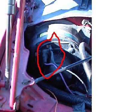

As for the other question not having the heater work, does the fan come on? If not make sure the wire to the fan motor is hooked up.
