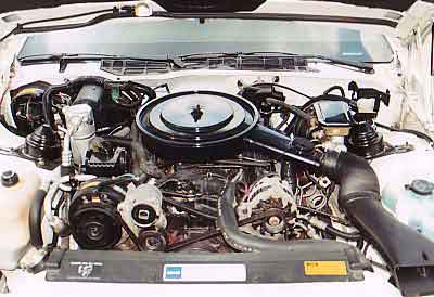

stock engine pic.
1991 RS 305 TBI. Also It is not a carp, it is a throtle body (TBI = throtle body injection) If you go to get parts and you say it is a carb you might confuse somebody. I sould have the same engine as you.

The picture you posted is a mis-matched air intake system. The plastic Y shaped piece that is in front of the radiator is for a 2.8L V6 camaro, while the round metal piece that sits ontop of the throttle body is from either a carbureted V8 or throttle body V8 camaro (doesnt matter, they are the same).
That round metal piece with the snorkel sticking off of it needs to be rotated counter clockwise some so its pointing like the first picture. Then you need to get the plastic flex tube and scoop (2 separate pieces) that attach to that. They are not required, the engine will run fine without them, they are jsut there to let the engine intake cooler air from outside the engine compartment.
Also, you can remove the plastic Y shaped piece in front of the radiator, it does absolutely nothing on your engine, since its supposed to be for a V6.
