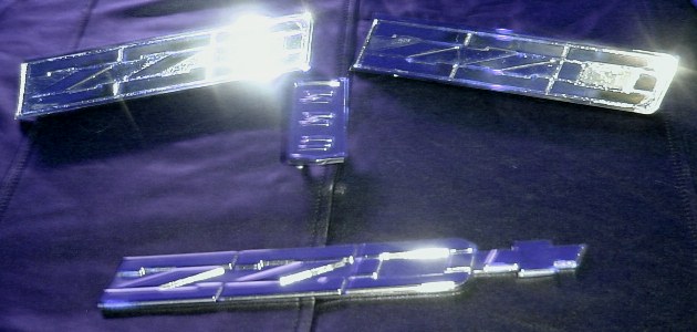

Somethin like this ?

Ratchet,
I like those but why does the 8 look like a 0 ..

actually the 8 looks like the letter 'D' ... where'd you get 'em

they say ZZD for zig zag drag and not z28

They were cut on a CNC then we had them Chrome plated then painted the background. We left the background of the side badges with a sand blasted finish thinking that this would help the paint stick better but all it did was mess up the chrome job. If you get someone like Hawk92z-TDZ to make you a set polish everything before you get them chromed.
