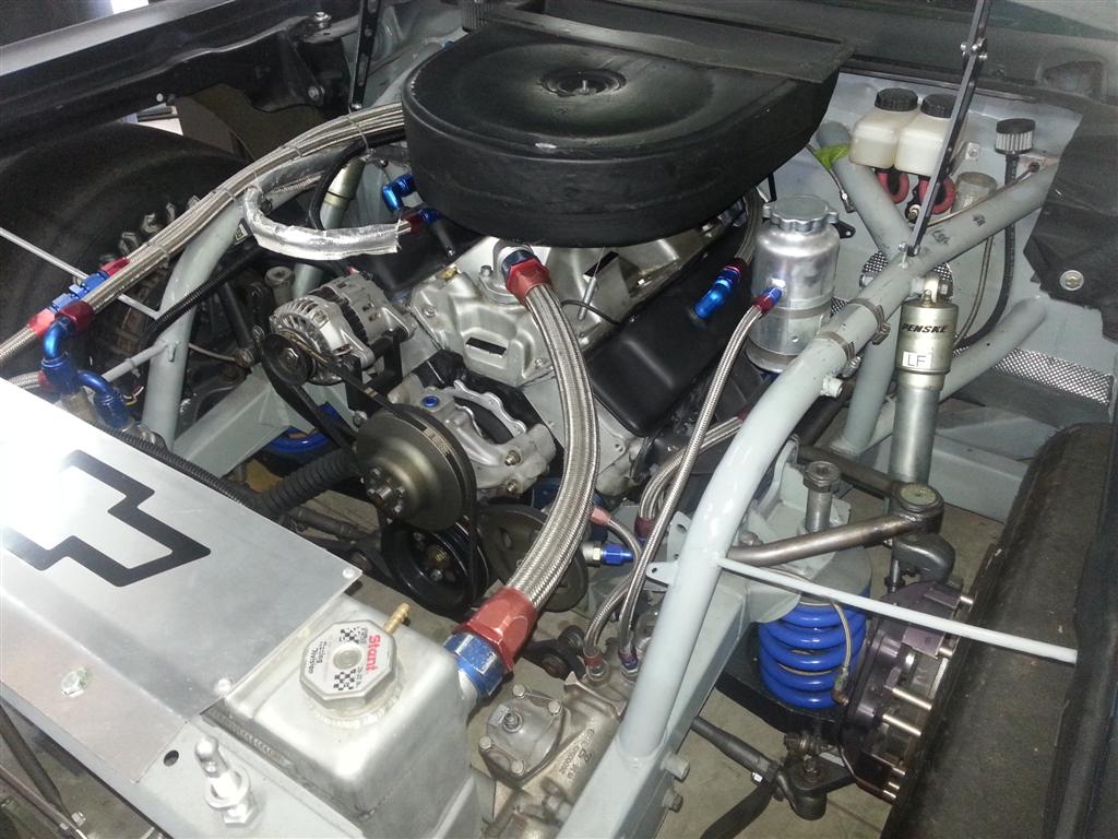

Ok, have the collector extensions welded on the headers, the one piece tailpipe/muffler section mounted in four places and the tailpipe exits trimmed so the exhaust is finished.

The 3.25 Tru Track is in. Calipers mounted, plumbed and pads installed. Diff filled with 75W 140 Royal Purple diff fluid. Rear Penske's filled to 90 psi nitrogen and mounted with the Watkins Glen set up left in them. I got the Mark Williams billet yoke with the pulley on it so I can run an old school belt driven rear end cooler pump which I have but it's not necessary for the car to run so I'll leave it off for now. Im done out here.
I cut the bottom half of the rear drive shaft loop off and fabbed a removable replacement. The drive shaft was a bitch to stick through the loop and get it on when on the lift . I couldn't imagine doing it at the track on jack stands so that's what I came up with. Drive shaft that came with the car slipped right in and is the proper length, no mods required. Love it
So now I can get the car off the lift and down onto jack stands, fully open the doors and get going on the final phase, mucking around with the pedals and wiring. I started doing the wiring earlier but on the lift I could only open the doors about a foot so it just wasn't working for all the wiring that goes on inside the car. The lift is old school and the car is so low you have to jack the car up and eff around on your hands and knees to get it on there, not something you want to do repeatedly.

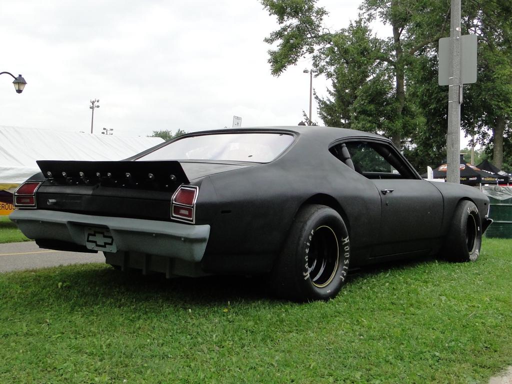

Updates

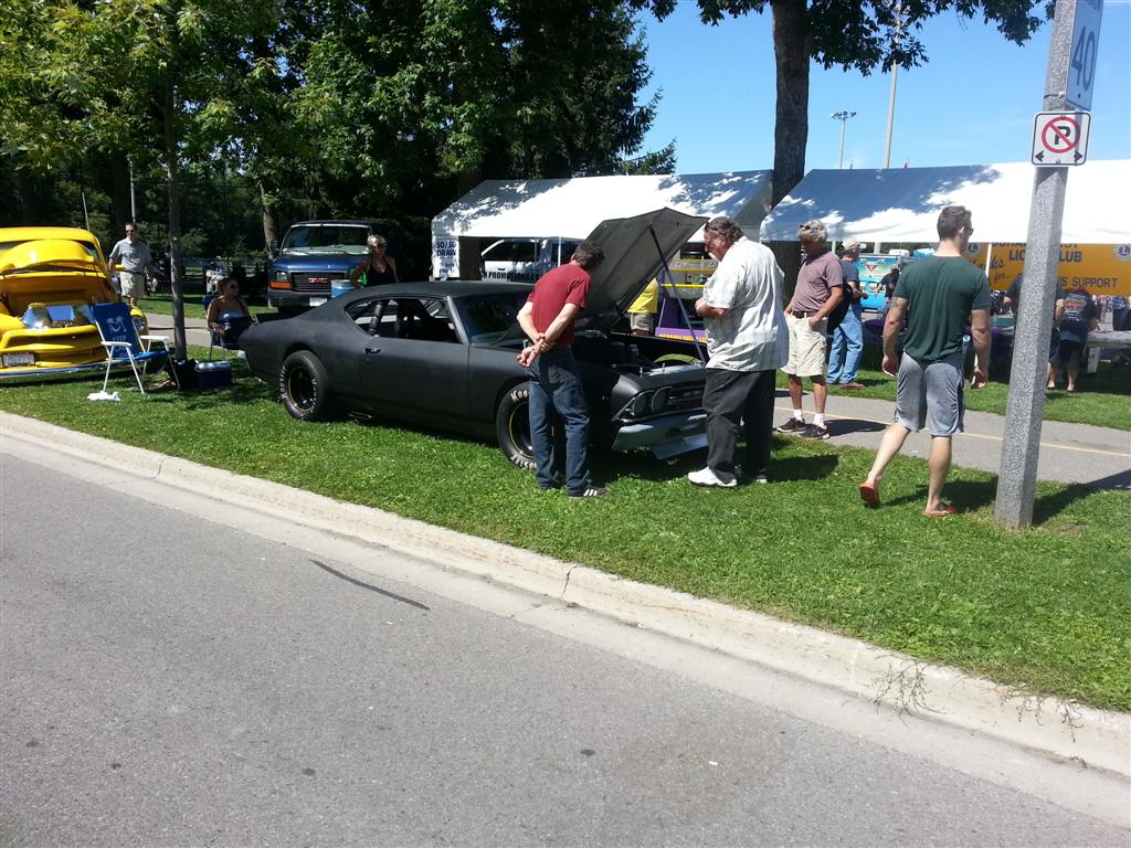

Some pics from a local car show in Oshawa

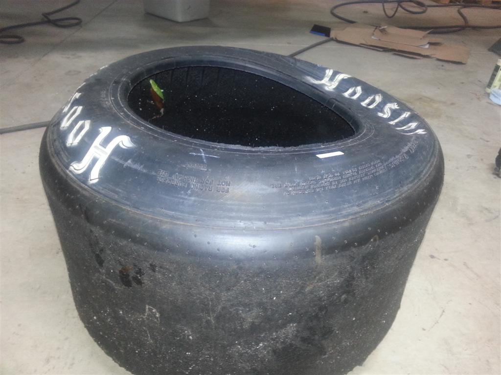

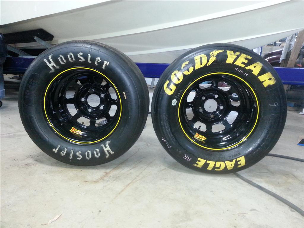

The tires in all the pics Ive ever posted are four plus yrs old now. David the Nascar guy has always said he doesn't like the Hoosier bias's and I should at least get a set of Goodyear bias's. I took his advice and contacted a local GT2/3 racer who sells used Goodyears from the Nascar Canadian Tire Series cars (NCATS) for $200 a set they are supposed to last two weekends.
The Good boots are a #D2265 and are supposed to be 1.5 to 2 sec a lap faster than the Hoosiers around 2.5 mi Mosport. I saw why David doesnt like the Hoosiers. You can see how soft the sidewall is, no pic but the Goodyear has a substantially stiffer sidewall! By hand the Goodyear sidewall will only move about 1/4" and the whole sidewall moves as one, way stiffer.
This was backed up by David. He said his team mounted a GoPro to watch the front tires. He said with the soft sidewall the driver would have to "wait on the tire" to get finished rolling over before the car would start to actually turn. David said he wants to send me up a few sets of Cup radials from Sonoma or the Glen and make it really go. Im not there yet.
The NCATS series grew out of the old Canadian CASCAR late model series. The cars are a Late Model type 3 link with a glass body not a Nascar truck arm/metal body. Early NCATS had a Camaro clip. They run across the country probably a third of the races are road courses. As well as their own races they are support races for the Nascar Trucks at Mosport and for the Toronto Indy. They have a 600hp Nascar spec engine and GM single piston Late Model type brakes. Min weight 3000.

Engine finished product. The only thing missing is the rad overflow tube to the base of the windshield, its there now.

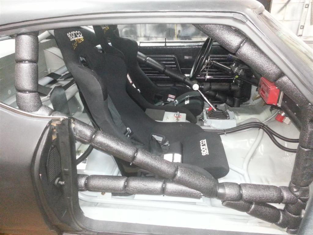

Had a harness bar and passenger seat mounts professionally installed. There was nothing whatsoever to mount the passenger seat to so we mirrored the nascar tubular steel seat mounts from the drivers side. New RJS 5 point belts with center twist release on both sides. Originally wanted the Simpson belts cause their a little more Nascarie but the RJS had the same rating and were WAY cheaper , whats up with that?

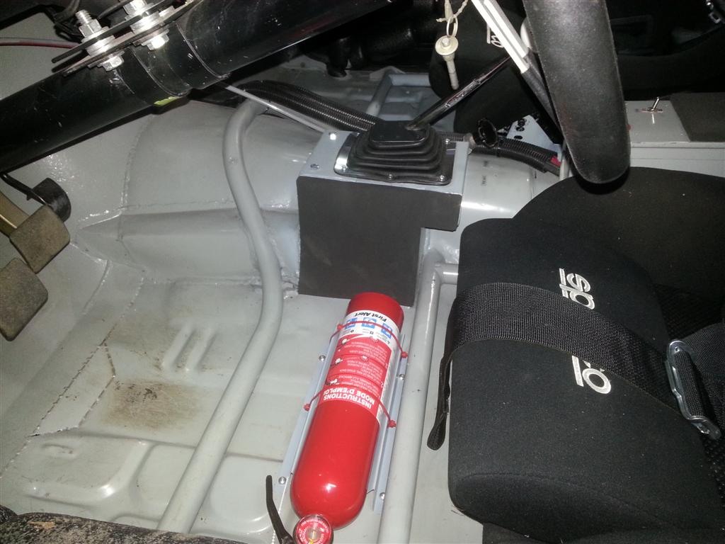

Future plans call for a full fire suppression system but for now I bent up a little U shaped aluminum mount on the brake for a fire extinguisher and zip tied it in. When needed you just rip it out. I tested it twice works great. Even when the suppression system gets here I will keep this one. It's not in the way at all when driving or entering/exiting the car. Handy to put out a fire where the system doesnt reach like a brake fire or a little grass fire underneath the car or something.
