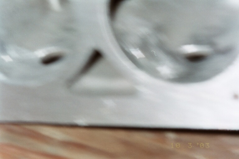

get a dremel or die grinder with a aluminum cutting bit and go to town:

Cool pics, I hope mine comes out as good. but we both mean the actual removal of the plenum/runners/intake.

HOLY CHIT!!! man, looks like you had yourself a good ol time with that plenum!!! my pics arent that good, but here is what i did. I need to take new pics soon cause i cleaned up the inside and smoothed out the side castings.

I wouldn't have opened the entire face of the plenum like that, but that's just me. I'd try to avoid any sharp angles, like the flat "wall" behind the throttle body that can induce turbulence and lost flow. That's really no better than the flat flange under a square-bore carb in an open well or TBI throttle body (which is the primary reason for a spacer that improves the flow).

it may create turbulance but it really doesnt matter, since the air is stored in the plenum and sucked down the runners for the intake charge, and then the pulses that come back up the runners into the plenum. so the turbulance doesnt really make a problem, the plenum is one big box of turbulance with the pulses coming up and down the runner tubes in and out the plenum, what u wouldnt want is turbulance in the runner tubes or the or the intake ports in the heads.
