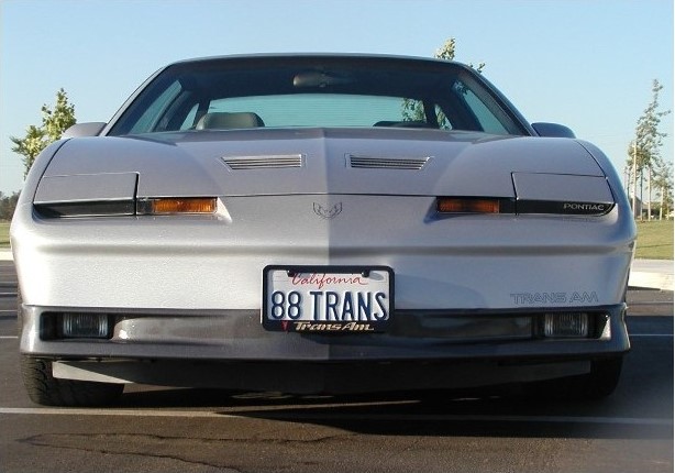

If you pull the manifold to port it, don't you have to pull the injectors as well. or just hope they don't get banged around when you are grinding on the manifold.
I idea of taking a well running car and screwing it up does scare me.
Thanks

I dont usually like the thirdgen Formula/TA looks, but yours looks AWESOME!
