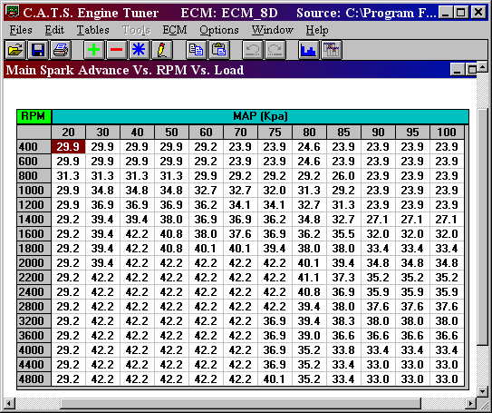

For the same money as a converted old style distributor you could just start burning chips. So rather than setting weights, springs and vacuum advance cans and a bunch of stuff to go wrong, you just have this.
vacuum vs. RPMs Easy as that. And even better, notice what i have going on @3200 @ 100kpa. That extra timing makes it hit my 3k stall converter harder, then tails off to normal levels through the powerband. You cannot do that with an old style distributor, at least without adding more electronics.
And wit the chip burning stuff there are a million other little things you can do to. Like change fan turn on temps, or adjust for an injector size change, or even <gasp> tuning the fuel too.
