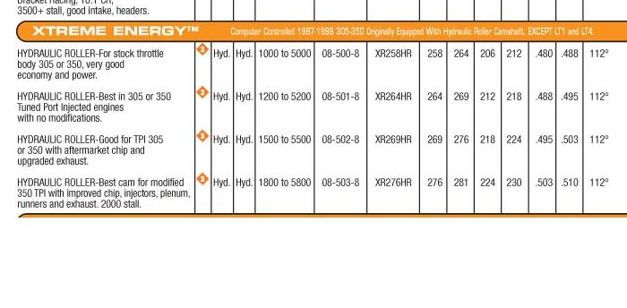

Ya I think I am going to buy the comp cams XR264 cam. I have not purchased the heads yet but i was looking into a set of LTI heads my budy has that are modified to use the vortec intake wich I already have. But I was wondering If this would be a bad Idea because TPI is made for low end and the LTI heads are not. I am going to wait untill the spring to due the heads and cam because I want to see how the car does at the track with the 6spd.

Do yourself a favor and at LEAST get the XR269HR-12 cam. The XR264HR-12 is too small for what you are doing.
The 264 cam is better for a stock heads TPI 350 with minor bolt-ons.
You wont be disappointed with the XR269HR-12 Comp Cam.
All cam specs of the above 3 cams are on Compcams.com online catalog.

OK i will get the XR269 cam. Is that the bigest came I can run with stock vortecs? Also I would need some prom tuning with that cam do you guys know any one who could do that for me? Where is the best place to buy vortec heads?

I just looked on the compcams web site and was blown away by the price the cam is like $345 wich I could live with but to get the cam kit with lifters is like $500 something dollars. I would need the cam kit right? My motor isn't a roller motor right stock 89 L98? Also if I decide this cam isn't in my budget what are my options for a cheeper cam like non roller.

Silly---You DO have a roller motor so u HAVE to buy a cam to work with a roller motor which the x-treme energy cams are. Always buy new lifters and springs when installina new cam. Very good insurance down the road. Others will chime in and say that it isnt necessary to buy lifters with a new cam. Well it actually is because the old lifters worn with the old cam and by throwing a new cam in with old lifters theres a possiblity that the cam will have a short life because of the worn lifters. These cam specs dont look that bad and TPiS has cams that are prolly better than comp cams. They dont offer lifter kits but they're not that expensive to begin with. TPiS is deffinatly worthly of takin a good look at for cam choice. I love mine and my whole kit cost me $400 w/ cam/lifters/springs/valve seals. Now that was for a hydrlic flat tappet cam so urs is goin to be more spendy but always worth it
Jason
The beauty of rollers is that there is no mating process, therefore you can swap out cams without changing lifters.

ok good point but wouldnt u just wanna replace them anyway cause they're so old. I would just because of their age. How do rollers wear out...I know they gotta go bad sometime.

To me.. its still just good insurance.. a couple hundred more could save lots in the long run.

i posted this in another thread but i am currently running a camshaft made for me patterned after the zz-9 cam.....this cam pulls very strong and has a smooth lopey idle, i wasnt going to pay the $375.00 for the tpis cam so i had bullet cams make an exact replica for $275.00. if your interested its www.bulletcams.com

go check out 3.8transam on the NW indiana boards his formula is a 350 vortec motor and his car will lite the tires up at sixty....and i've seen him take out many an LS1 from a roll even if they get a jump on him
