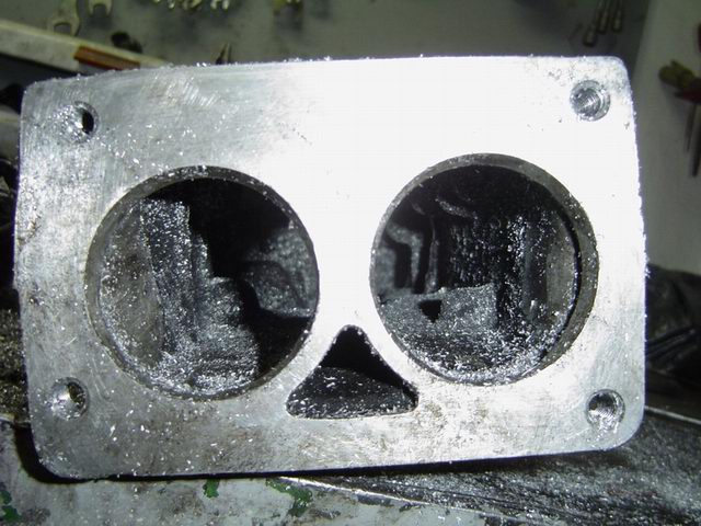

Old Feb 4, 2004 | 08:06 PM
dj haf's Avatar
Joined: Aug 2003
Posts: 420
From: Miami, Florida
Car: 1990 IROC-Z
Engine: 350 L98
holy **** 305sbc.... lmfao u raped that plenum
did you notice any difference after you ported it?

305sbc
Is that a hole in the upper right about 1/2 in from the throttle body gasket surface.
Jerry
Old Feb 7, 2004 | 11:09 PM
305sbc's Avatar
Joined: Nov 2001
Posts: 2,428
From: Fairview Heights Illinois
Car: 1986 Irocz
Axle/Gears: 3.25:1
Originally posted by JERRYWHO
305sbc
Jerry
Yep that's a hole but it is patched now. This TPI is Kim's (TPIgirl) and it's still being worked on (not running yet). It's a very extensively ported stock TPI.
