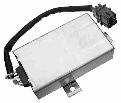

He has a 1985 TPI system, the power and burn-off functions were handled by a MAS module (not relays) piggybacked on the ECM, they cost on the order of $500-$800 from GM.

below is what you are looking for on the ECM and it lists for $753.79

here is the MAS module for 1985
