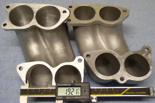

I’ve started porting on this “new” FIRST Injections intake system and thought you all might like to see how large these runners can be opened up. The first picture is of the stock TPI runners (for a reference of sorts), that measure right at 1.5” inside diameter,,,, followed by the ported FIRST runners.

That’s about as large as I feel comfortable going with (1.9215”). That diameter is held fairly constant though the length of the runner – which is only 5.875” (short side radius). The top of the runners are opened to 1.97” but it tapers down to the 1.9” mark. You can see the difference in the unported FIRST runner to the right. Even unported they’re pretty health measuring right at a 1.75” inside diameter right out of the box. I’m fairly impressed with this FIRST unit. I’ll post a couple pics of the base when I finish working it if anyone’s interested. For those of you that didn’t know already,,, the runners are not interchangeable with the stock (or the typical aftermarket) TPI base.

I’ve ported a few sets of SLP runners myself and there’s no way to get them opened up remotely close to these FIRST runners without doing as Jerry (and others) have done by cutting them open and welding them back together.
If you compare the TPI and FIRST runners pictures, you can see that the FIRST runners are shorter (5.875” inside radius) than the stock type TPI runners (7.125” inside radius). It’s no cake walk and it’s time consuming,, but once the runner's openings are enlarged, you can get to everything using an oval shaped and a ball end bur with a 6” shank except about an inch and a half of the inside radius of the runner. I compensate for that by taking a little more off the sides and outside radius around the center of the runner. A 1.877” diameter ball passes through the runner with only a little resistance at the apex,,,, but it’s not perfectly round at that point. However, the cross sectional area appears to be held fairly constant.

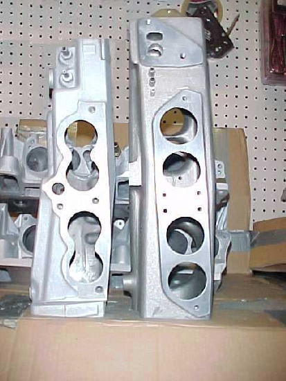

Sorry man,,, the FIRST unit is a stand alone system. The FIRST unit's throttle body, plenum, runners, fuel rails, and base intake are not interchangable with the stock or aftermarket TPI parts. So, no the runner won't bolt up to the stock plenum. The runners are in 4 sections, runner spacing is different,,, as well as the bolt pattern that holds the runner sections in place. Here's a comparison of the plenums.
Attached Thumbnails Ported FIRST Injection Runners-tpi-vs-first-plenum

Well as the biggest Club in Europe and maybe the oldest too we stock all kind of stuff.
I mentioned the IGN/ECU drama cause the FIRST got no TPS.
We too were thinking of using a "cheap" accel or painless tpi MAP harness to get it running so i guess we need to build a TPS hookup???????
Do you have any pics of ya TB?
Funny we have a EGR block plate on our Plenum.....
To all wondering about the power ..we will post the old shoot out data soon were this monster put the other TPI KIDS on there knees!
WWW.CAMARO-FIREBIRD.DE

Bad SS any codes or data from the injectors you have would be cool!Are you using the FIRST INJECTORS?
It seems that i got Lucas injectors: 5720A530 11362-000
need some time on the weekend to make a search on those numbers!If someone has a link to Lucas numbers send a mail!
TPS Bracket on the TB now!
Sorry scan went down the drain:::::
only pics Baseline is: a Vette 89 L98 with edelbrock 6873 header sys and 88 iroc cat!more data on the weekend.
Old Mar 26, 2004 | 07:53 AM
  #49
german-motorsport's Avatar
Joined: May 2001
Posts: 462
From: germany
one more pic !
